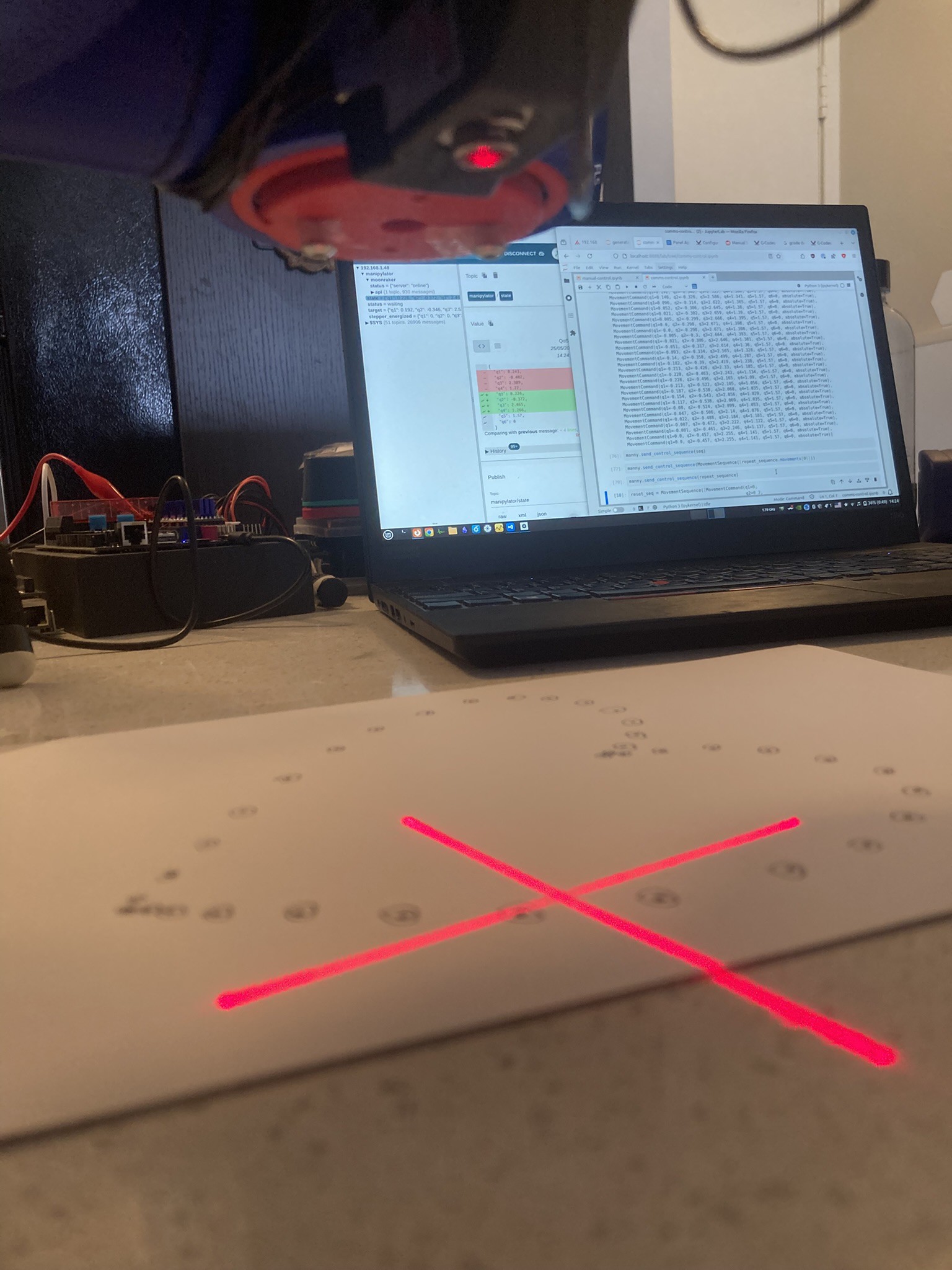

| In this chapter, we'll cover how to move a robotic arm to a given position and trace a path in 3D space. After which we'll apply this knowledge in a simulator, to control a virtual clone of our arm (which I've started calling Manny). Finally, we'll attempt to have my physical robotic arm replicate the same movements we observed in the simulator. |
For readers who are already familiar with controlling robots, do check out my ManiPylator repo which demonstrates a complete lab environment for simulating and controlling a robot manipulator using exclusively FOSS, including Genesis, robotics-toolbox-python, spatialmath-python, SymPy, Mosquitto and Klipper.
Having settled on a design for Manny in part 1, it would be useful to write some movement equations. Happily enough, this is a solved problem. The derivations have been done, formulas exist, and they're written in a format called Denavit-Hartenberg parameters . Briefly, by figuring out the distances and angles between the motors of our robot, we can use a stock formula to calculate where the end effector will end up. Unfortunately, this is often complicated by DH parameters being a convention, and multiples exist. Some sources report Modified DH parameters or other variants, and while not impossible to compare, I found confusing and tedious. For example, I learned that the simple act of finding an example problem and working through it can be infuriating, after more than once the answer was written using a different convention to my own.
Although covered in depth in all the introductory texts I tried, DH parameters confused me far more than sharpened my understanding. Finding them difficult to keep straight and visualise, I was hoping for an alternative. I came upon the Elementary Transform Notation (ETS) (as described in this paper) available as part of the robotics-toolbox-python package. While still having to deal with right hand rule shenanigans, the notation immediately struck me as easier to grasp. Furthermore, breaking up the process into a sequence of elementary operations helped me visualise the task, while making finding mistakes more likely. And best of all, at the end of the process we get the same result. A formula that given a set of motor angles directly calculates the position (and direction) of the end effector.
While DH parameters have historical traction and ETS definitely helped me "see" things clearly, the most useful way I found for describing Manny was a URDF. This XML based format is widely used in the ROS ecosystem and is often provided by vendors. In addition to the details encoded in DH/ETS, URDF also includes the capability for specifying meshes, a feature we'll soon use, when we visualise Manny in a simulator.
Thankfully, I was exempted from handcrafting the file by using onshape-to-robot to export my OnShape model directly to a URDF, available here. After taking this welcome shortcut, I had an interoperable description of Manny that I could use with most robotics software, including robotics-toolbox-python and the recently available Genesis.

Some time later, we're doing a sanity check with a relatively functional arm. We were trying to make the arm follow a specific path and return to it's initial position, but couldn't get it right. Making the arm to return to an initial position was straightforward, but tracing out a path just didn't seem to work. In hindsight, why would it? I was doing it all wrong.
"Maybe all those matrices are actually good for something?" I wondered, uncertain.
Since then, I've become a close personal acquaintance with a variety of matrices, even of the rotational and homogeneous persuasion. Similarly, quaternions no longer seem so malicious nor are reference frames a confusing jumble of notation & convention. There's still a lot to learn, but failing at controlling a physical robot arm helped me get over the hump of jargon and start seeing the forest through the trees.
