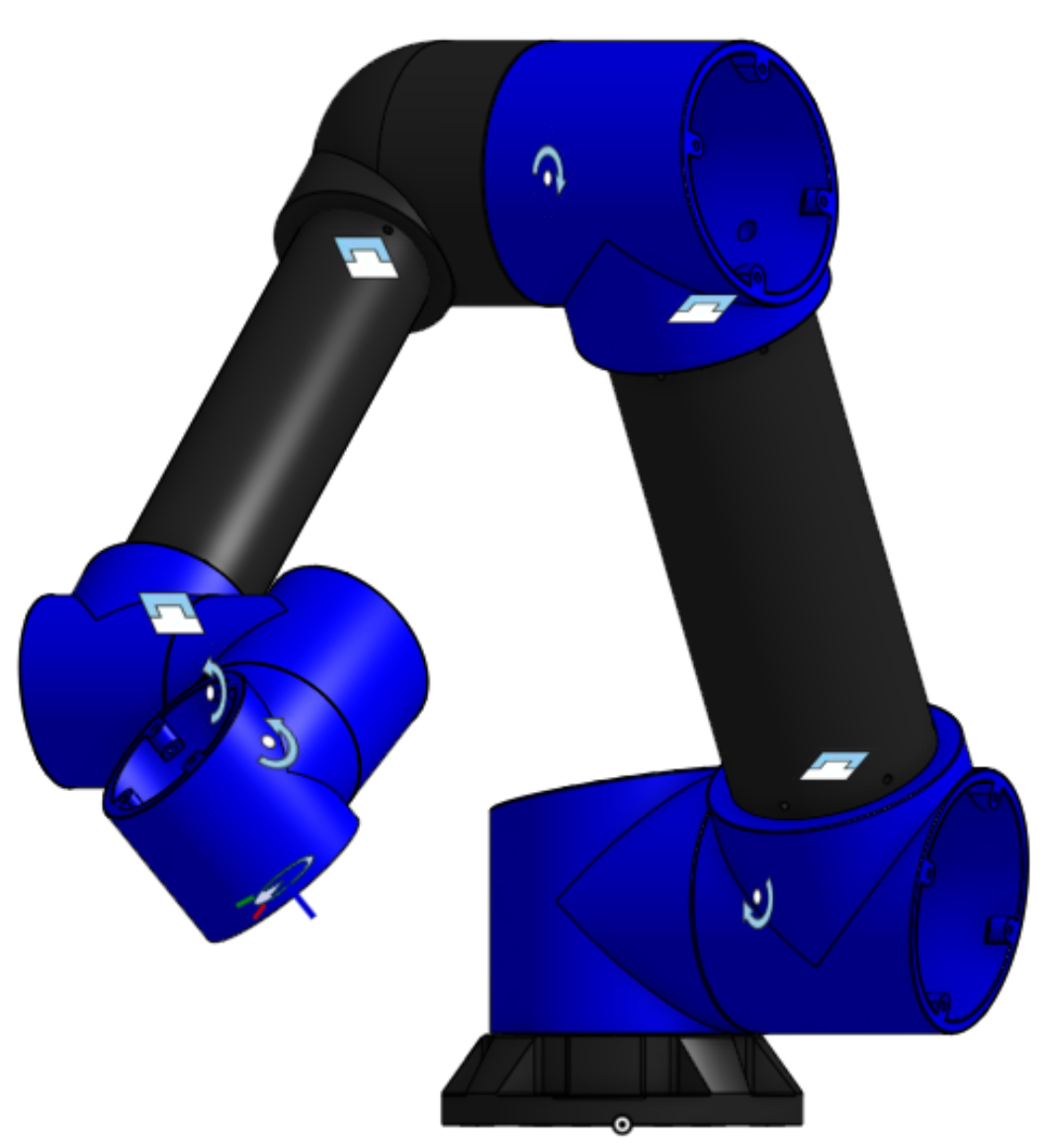

Having settled on a design for Manny in part 1, it would be useful to write some movement equations. Happily enough, this is a solved problem. The derivations have been done, formulas exist, and they're written in a format called Denavit-Hartenberg parameters . Briefly, by figuring out the distances and angles between the motors of our robot, we can use a stock formula to calculate where the end effector will end up. Unfortunately, this is often complicated by DH parameters being a convention, and multiples exist. Some sources report Modified DH parameters or other variants, and while not impossible to compare, I found confusing and tedious. For example, I learned that the simple act of finding an example problem and working through it can be infuriating, after more than once the answer was written using a different convention to my own.
Although covered in depth in all the introductory texts I tried, DH parameters confused me far more than sharpened my understanding. Finding them difficult to keep straight and visualise, I was hoping for an alternative. I came upon the Elementary Transform Notation (ETS) (as described in this paper) available as part of the robotics-toolbox-python package. While still having to deal with right hand rule shenanigans, the notation immediately struck me as easier to grasp. Furthermore, breaking up the process into a sequence of elementary operations helped me visualise the task, while making finding mistakes more likely. And best of all, at the end of the process we get the same result. A formula that given a set of motor angles directly calculates the position (and direction) of the end effector.
While DH parameters have historical traction and ETS definitely helped me "see" things clearly, the most useful way I found for describing Manny was a URDF. This XML based format is widely used in the ROS ecosystem and is often provided by vendors. In addition to the details encoded in DH/ETS, URDF also includes the capability for specifying meshes, a feature we'll soon use, when we visualise Manny in a simulator.
Thankfully, I was exempted from handcrafting the file by using onshape-to-robot to export my OnShape model directly to a URDF, available here. After taking this welcome shortcut, I had an interoperable description of Manny that I could use with most robotics software, including robotics-toolbox-python and the recently available Genesis.

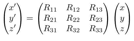

Helpfully enough, rotations around the axes can be multiplied to point in any arbitrary direction. The result of multiplying Rx(θ), Ry(η) and Rz(ρ) is called the Rotation Matrix. Next we need to accept two features of a rotation matrix. First, rotation around the origin can be thought of as a matrix multiplied by a point/vector:
Second, if we add another column to the rotation matrix, we'll be able both rotate and translate using a single multiplication. The resulting 4 by 4 matrix (because we like square matrices) would be:
The above formulation is called the homogeneous transformation matrix (or homogeneous transform) and it encodes a pose, or position + direction in 3D space. A concept the usefulness of I failed to to appreciate for the longest time. Specifically, I seemed to have completely missed the fact that matrix multiplication could be thought of as the equivalent to giving directions in the form of:

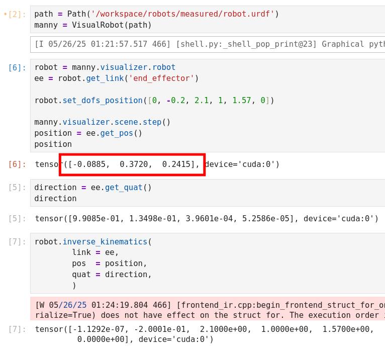

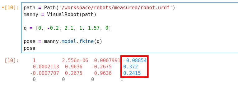

The first question is known as forward kinematics and the second as inverse kinematics. For an introduction to both, I recommend the excellent demonstrations for forward and inverse kinematics by Robotics Explained to build a conceptual understanding in 2D. Helpfully, both robotics-toolbox-python and Genesis provide a straightforward way of calculating kinematics directly from a URDF:
| Kinematics in Genesis | Forward kinematics in robotics-toolbox-python. I left out inverse kinematics since I couldn't figure out how to produce a correct results, but i found reading the underlying code instructive |
Note: while forward kinematics has a relatively straightforward solution for a serial manipulator, inverse kinematics approaches vary. Some are faster, while others are more accurate or handle specific use cases better. Inverse kinematics is the focus of active research and which is beyond the scope of this post. For a review of recent machine learning driven approaches see this paper or the robotics-toolbox-python documentation for some traditional approaches. For a forward kinematics worked example, a comparison of inverse kinematics algorithms available in robotics-toolbox-python and detailed instructional tutorials for robotics-toolbox-python see another of Jesse Haviland's repos.

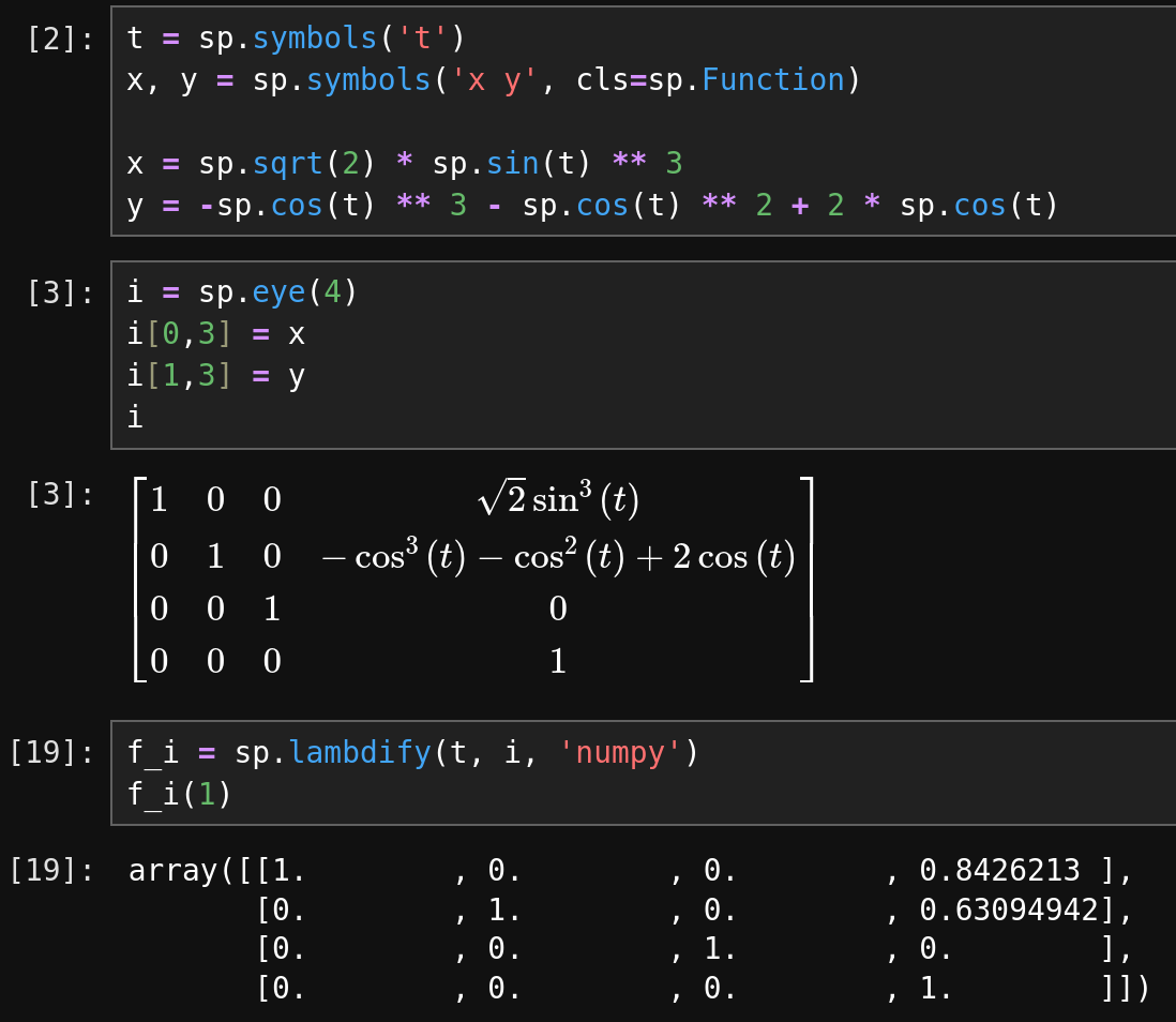

One of the challenges I often encountered when learning maths or physics "on the blackboard" was converting my conceptual understanding to software. Symbolic maths do the brunt of the heavy lifting during the first, while numeric maths rule the second. In my experience, crossing this bridge is typically tedious and often error prone. Helpfully, SymPyprovides a convenient bridge between these two worlds and is integrated with robotics-toolbox-python.

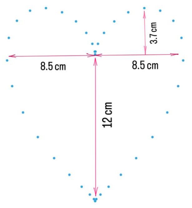

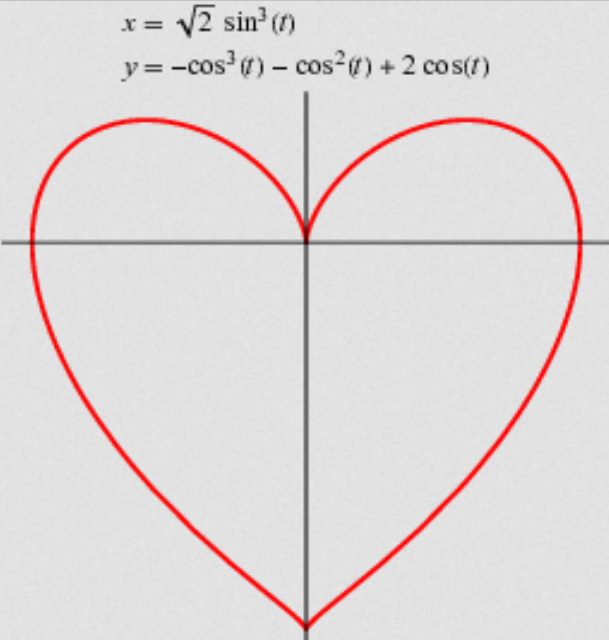

As an example problem (and a general sanity check), I'd like Manny to trace a curve in 3D space. To simplify, we'll keep the end effector pointing straight down and parallel to the floor. This is, luckily enough, what we would need to do, if we attached a pen to the end effector and had Manny draw on a flat piece of paper. Furthermore, since the direction is constant, our pose need only parameterise the position column, whereas the rotation matrix will be constant.
For the curve itself, I chose a heart. Specifically the eighth curve on this page, reproduced below:
| Parametric heart curve | Symbolic, numeric representation of a heart curve in matrix format |

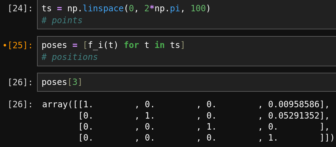

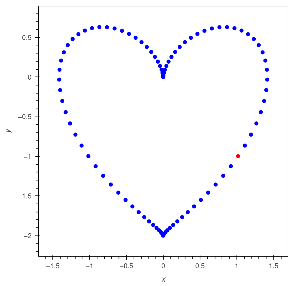

Using the above example, we can easily calculate a set of 100 positions on the curve and return them as a homogeneous transform:
| Calculating poses along a curve | 100 samples on the curve in 2D space |

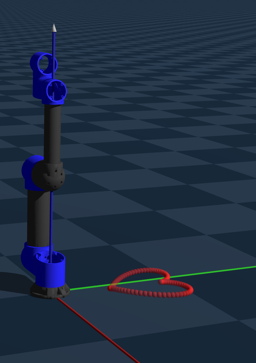

Next, once we've calculated the inverse kinematics for each of these poses we should be able to simulate Manny tracing this path. For a worked example used to generate the below video, see this notebook in the ManiPylator repo.
| Manny and samples along the curve | Simulation of Manny tracing the path using Genesis

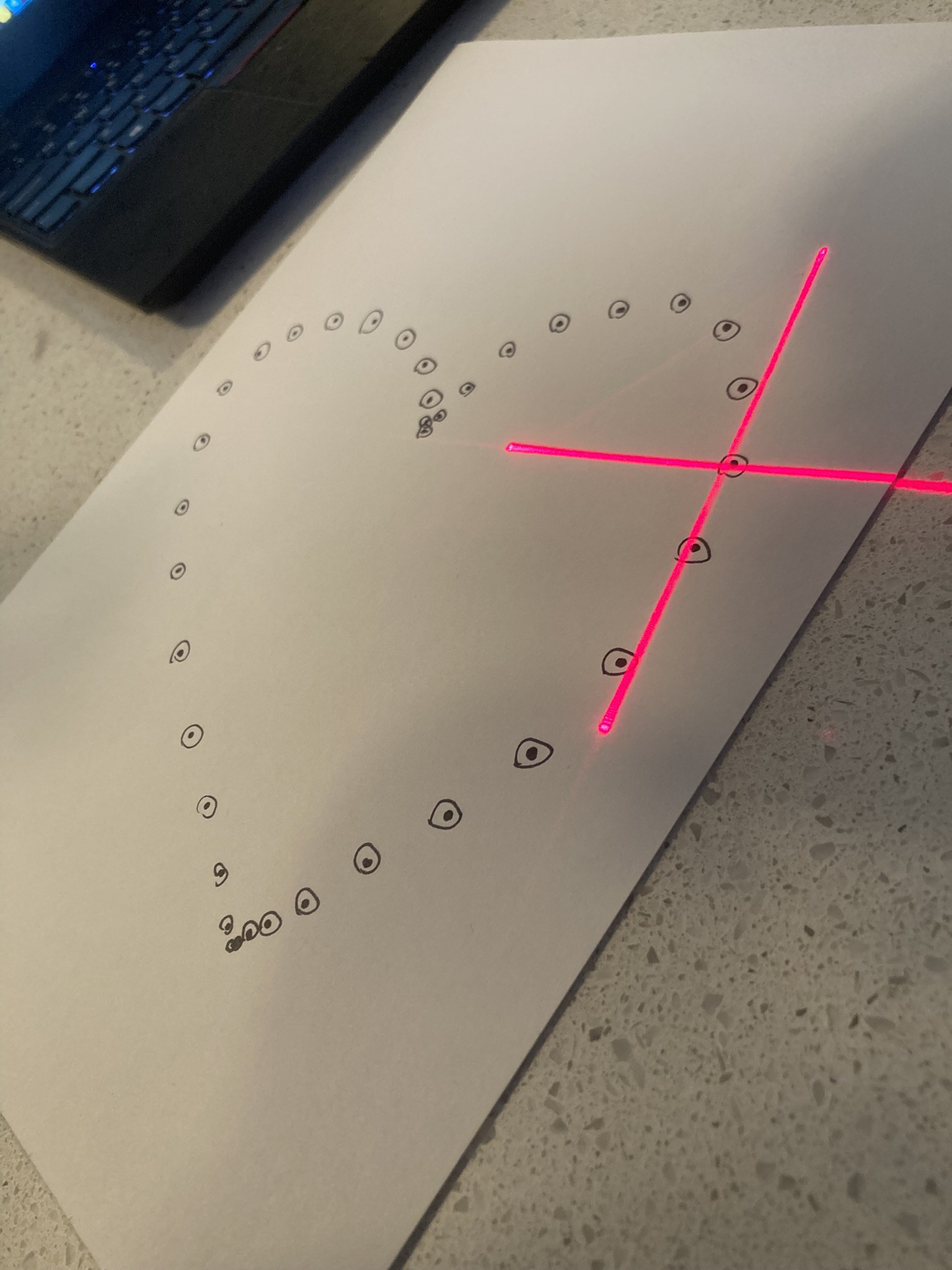

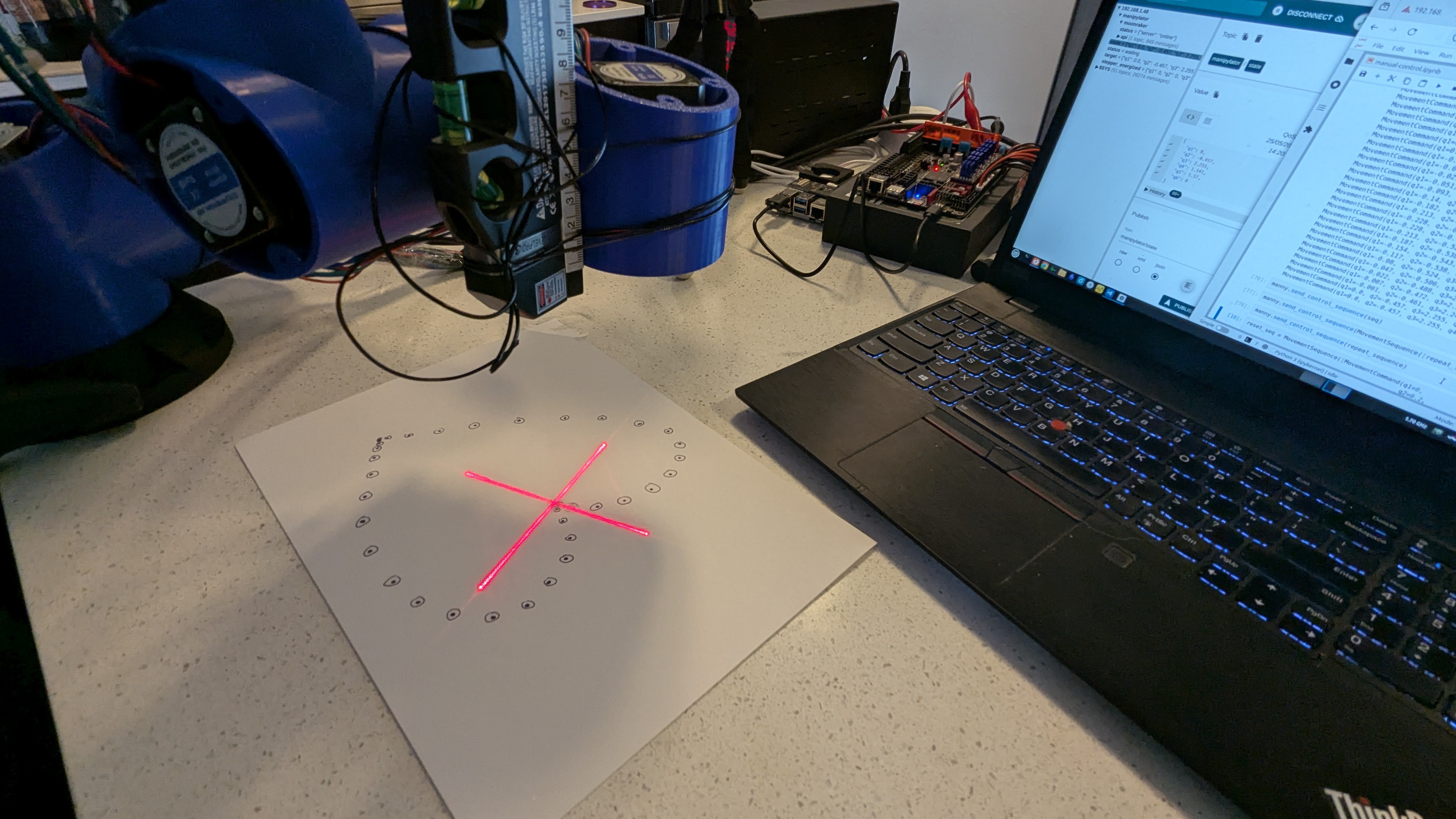

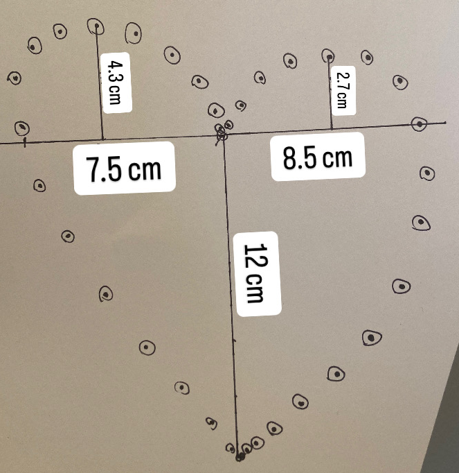

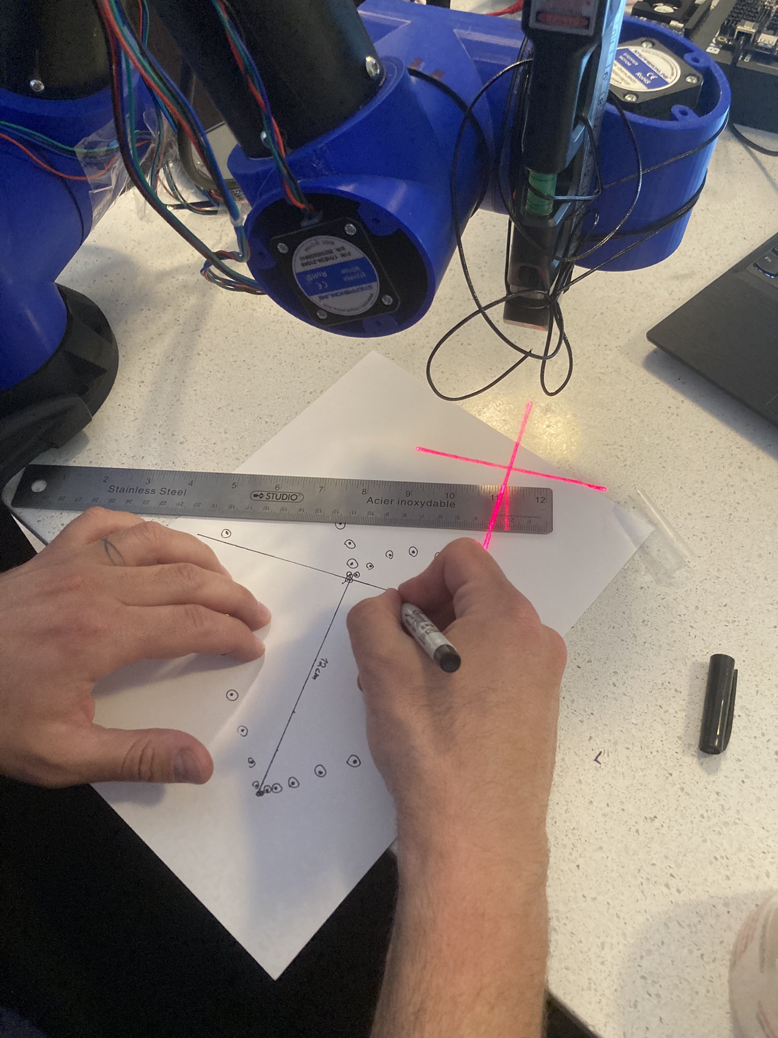

Once I was confident enough that I understand what's going on in the simulator, it was time to see if experiment matches theory. To test my work I opted for a simple setup, tie a laser pointer to the last joint and trace the above heart ~10 cm off the page. At each position a 2 second dwell time allows for marking the position. On a second pass I drew a circle around the first, second pass positions. The assumption was that if on a third pass the laser passes through the circle, I could call the experiment a success:
| Tracing 1st, 2nd pass | 3rd pass viewed from above |
The poor calibration notwithstanding, I'm extremely happy with the result. Not only did theory (approximately) match experiment, I now have a straightforward setup for further robotics experimentation and learning. Furthermore, while the movement is far from smooth, the accuracy and reproducibility is much better than I was expecting from a 3D printed robot. Finally, to make this informal experiment slightly more scientific, I made some measurements:
| Expected | Measured |

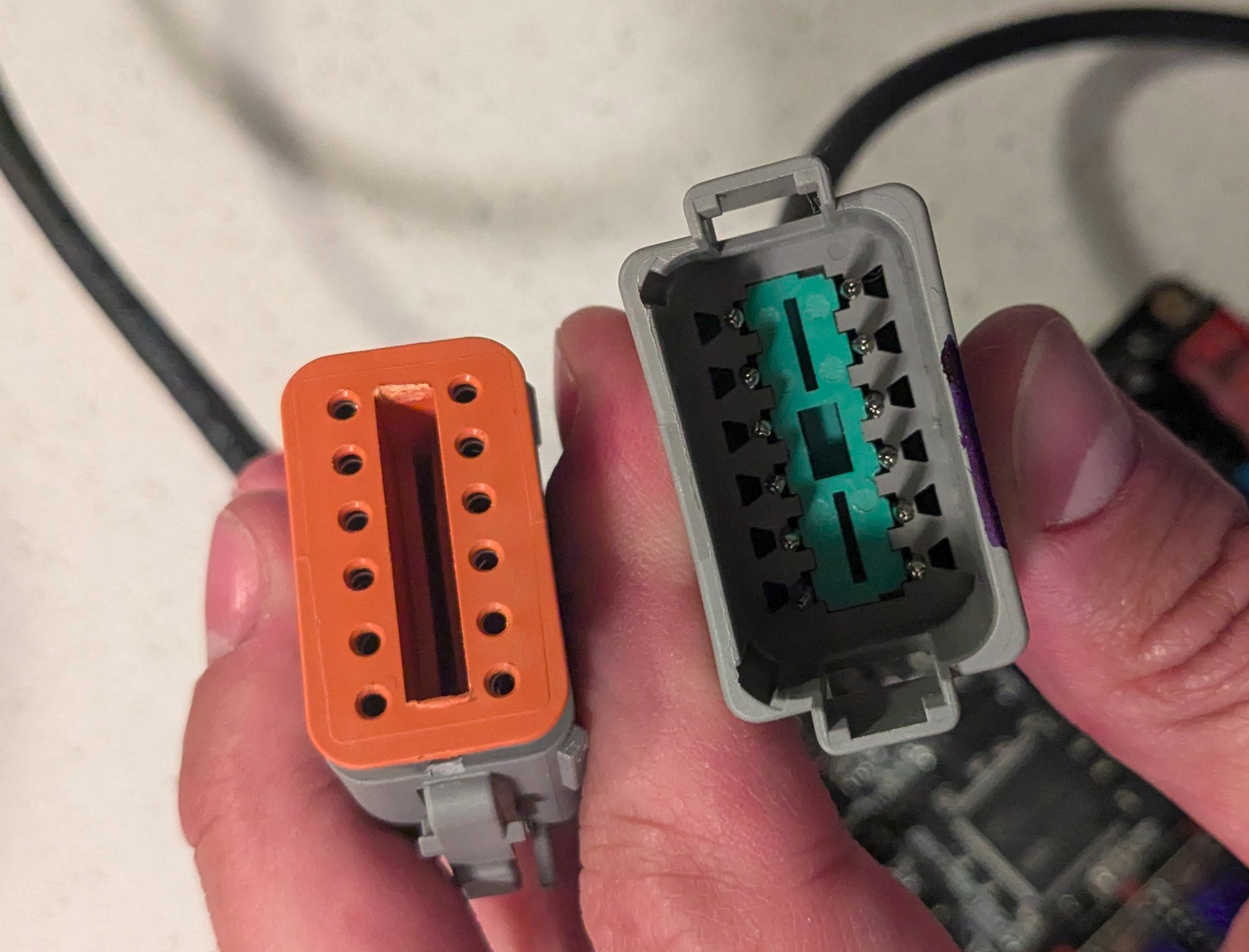

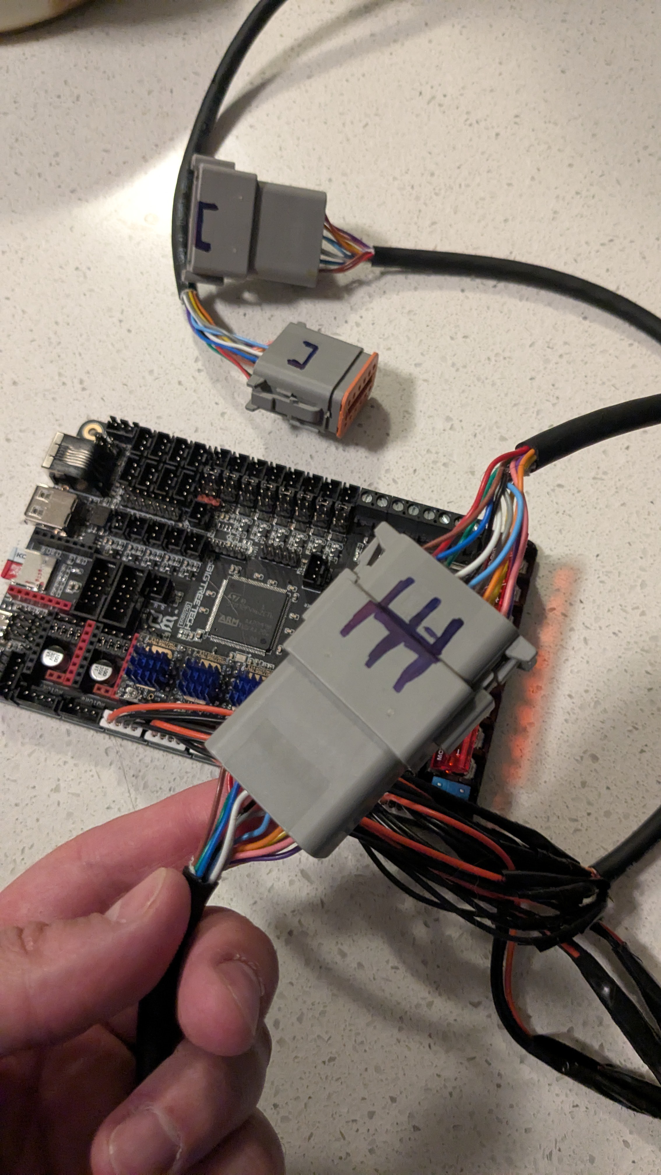

- What did you do for wiring? I used a 12 conductor cable and terminated it with 2 pairs of 12 pin Deutsch DT connectors. Some assembly required. See image below
