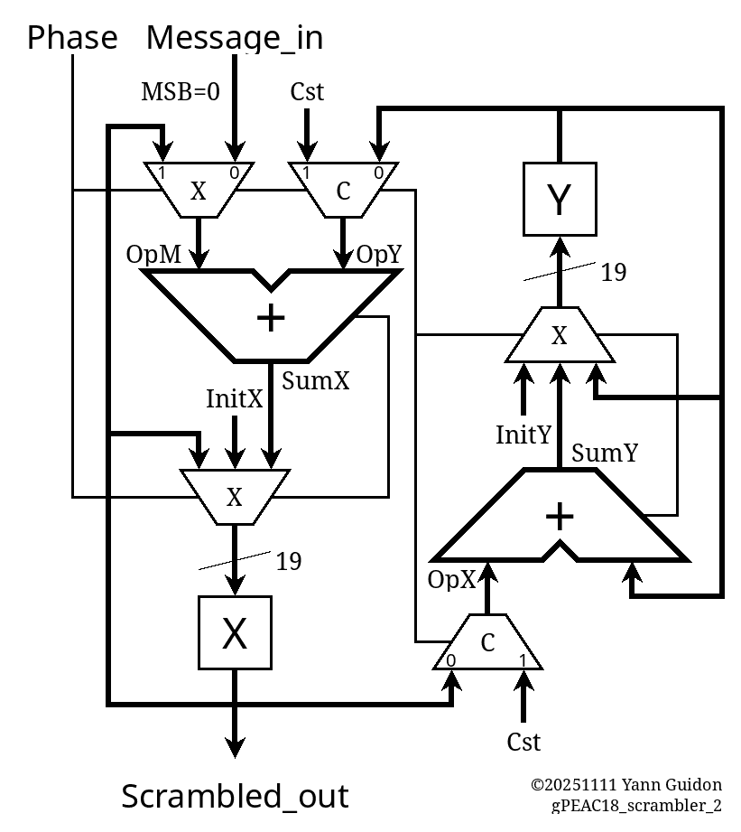

    The architecture is settled and "just needs to be coded".
    The C code is pretty simple, one variable and 3 lines are added per peer (ResX2 & ResA2).
    // Decrambler
    int Message_in, OpM, OpY2, ResX, X, Y, CX, CXin,
       CXout, Scrambled_out, ResX2;
    void cycle_scrambler() {
      OpM = Message_in;
      OpY2 = Y;
      CXin = CX;
      ResX = OpM + OpY2 + CXin;
      X = ResX & MASK18;
      ResX2 = ResX + ADJUST;
      CX = (ResX | ResX2) >> 18;
      if (CX)
        X = ResX2 & MASK18;
      Scrambled_out = X;
    // Decrambler
    int Scrambled_in, OpM2, OpB2, B, A, ResA, CA, CAin,
        CAout, Message_out, error, ResA2;
    void cycle_descrambler() {
      OpM2 = Scrambled_in;
      OpB2 = (~B) & MASK18;
      CAin = CA;
      ResA = OpM2 + OpB2 + CAin;
      A  = ResA & MASK18;
      ResA2 = ResA + ADJUST;
      CA = (ResA | ResA2) >> 18;
      if (CA)
        A = ResA2 & MASK18;
      Message_out = A & MASK17;
      error = (A >> 17 ) & 1;

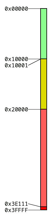

    It's still quite unconventional and hard to grasp so a diagram is required.
    The key detail is that the descrambler is not a modular addition, unlike the scrambler. Logically it's a modular subtraction and this changes a lot of non-obvious details. In particular:
    • the scrambler works in the unsigned, positive range, from 0 to 2×mod, hence the OR to detect overflow,

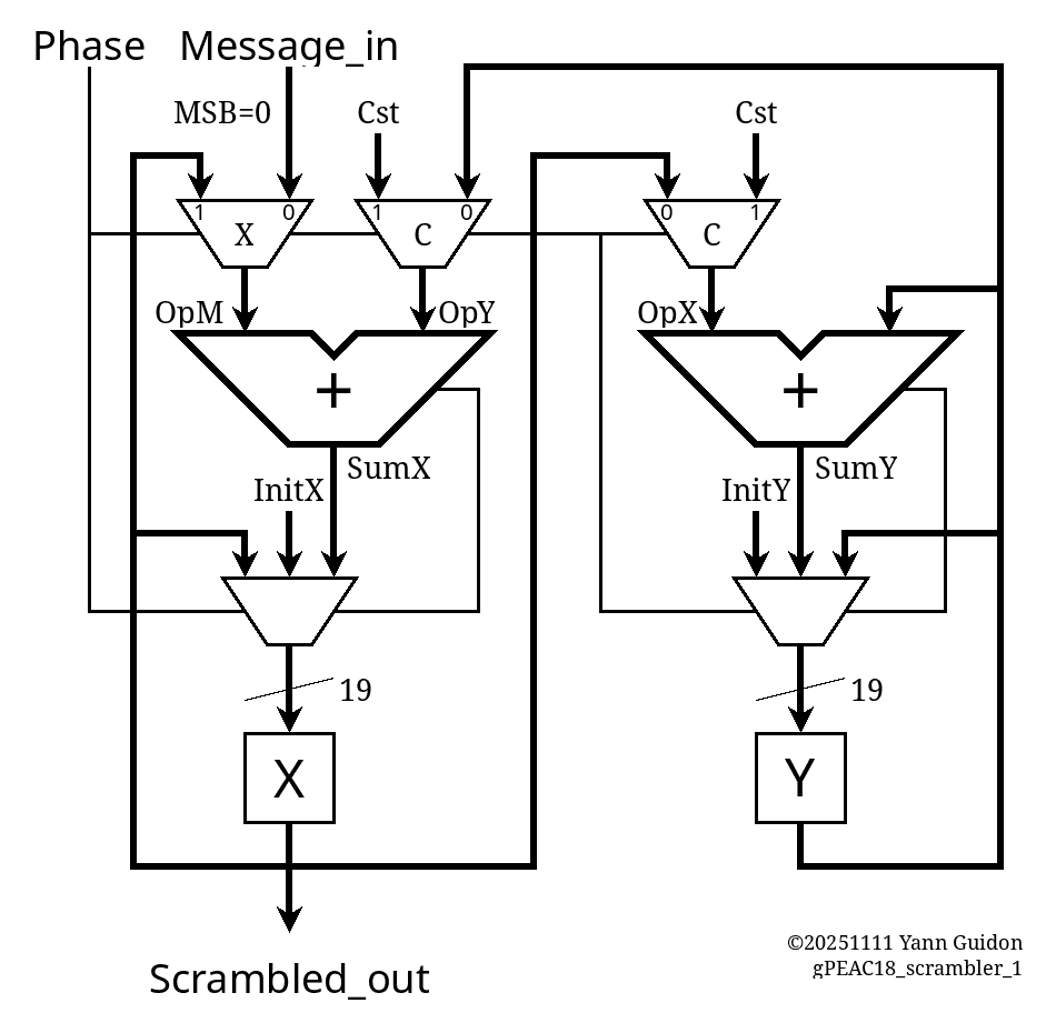

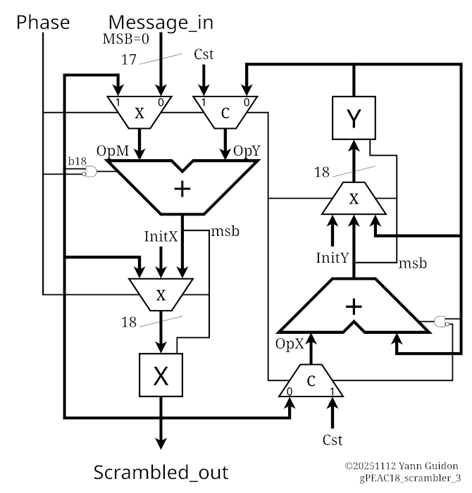

  • Re-birth (2) : the modulo.
    Yann Guidon / YGDES • 04/07/2026 at 00:28 • 0 comments
    The last log 138. Re-birth (1) has found 3 more coding flaws and there are probably even more.
    At this moment, I start to doubt the choice of the modulus, because being so close to 2^18 makes it pretty unlikely to overflow and create a carry (remember: the carry creates an additional avalanche). But then I forget that Y changes too (it's fixed for now) and I'll have to observe the activity of the carries. It will be interesting to compare the different values...
    The principle of the dual cycle is to pass the first sum into the adder again, but adding a constant (derived from the modulus) and see if the result overflows. If it does, the new (adjusted, wrapped-around) sum is written to the register, otherwise it is not modified.
    It's simple but not obvious because the whole thing mixes the numerical bases: the first phase is mod 262144 and the second phase is mod 258114, so there is an adjustment of 4030.
    Managing the carry bit is notoriously tricky in this situation and I have lost some hair already...
    Now something occurs to me. There could be a way out of this madness.
    First: I have noticed how ASIC have a different balance from FPGA. DFFs are 3x more costly than typical logic gates, which means that an adder is more economical than a whole pipeline regsiter.
    Second: It may be better to chain the adders, instead of cycling and sequencing and managing. This makes a slower clock but it does more in one period. Particularly if the 2nd add is a constant, which would use fewer gates.
    Third (and this is the stroke of genius that didn't occur to me until this morning): what if the constant add is moved upstream so it doesn't bother us? There would be a simpler pipeline and less complexity...
    Fourth: the pre-add would also work as error detection, because it does the work of the comparator.
    Except that the adjustment is conditional...
    Engineering really is the art of moving problems around.
    Back to the circuit. The RB1 does one thing: out = in + Y.
    In the RB2 (with modulo implemented) one way to know whether it has overflown is to check the carry bit, but there are 4030 cases out of 264144 (1 chance in 65, roughly, actually it's more complicated than that) that the sum is actually between the modulus and 2^18. The low chance makes me think again that the modulus is too high, but the 2nd turn is still necessary, if only because the result provides the corrected sum.
    Actually we want 2 things:
    • sum1 = in + Y
    • sum2 = in + Y + 4030
    Then we select the result according to the carry bit of sum2. This is a rather typical configuration that I have seen in previous works.
    I think I have uncovered a 5th flaw in the previous design, probably present in the VHDL "reference" as well: the A/X pipes are fed with B/Y but these values change with the phase, because they are not stabilised/registered => race condition
    No wonder I had such a bad time making it work !!!
    Now there are 2 ways to make the modulo adder work.
    • sum1 = in + Y
    • sum2 = sum1 + 4030
    (as I have seen somewhere and it looks good) or
    • sum1 = in + 4030
    • sum2 = sum1 + Y
    And I'd love to use this since this would reduce the effort on the Y/B pipelines that reuse the input. Pre-adjusting the input saves multiplexers (constant or classic) so in a way, this simplifies the system.
    This adds an adder in the pipeline but with two alternating constants (0 and 4030).
    However I recently found that a 2-cycles system needs more registers to prevent race conditions => A one-cycle solution would prevent this !
    Furthermore, it appears that factoring the adjustment into the input does not save much. There is still the need for the two bigger adders, and the added temporary registers bloat the system.

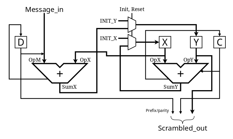

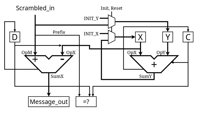

  • Re-birth (1)
    Yann Guidon / YGDES • 03/31/2026 at 11:39 • 0 comments
    The last log 137. iHP26a - post mortem explains why and how the whole thing could be rebuilt almost from scratch, so let's now start with the basic integrator-differentiator pair. It's just a 18-bit version, the modulus is added later. Moreover, each step requires an identical/equivalent representation in C (JS), VHDL, Verilog and diagram.
    For the first step, we have a simple accumulator X, adding the (fixed) register Y to the incoming message. The decumulator does the reverse, subtracting B from the incoming message. It's not hard but keeping all representations in sync takes some efforts. (and yes, these are just registers, not accumulators, but I had to come up with a word...)
    And even this simple circuit is not totally obvious. The dataflow is easy and the encoder is simple but the carry requires a lot more thinking in the receiver.
    So how is the carry processed in the receiver ? what inversion is needed and where ?
    CA would be reset to 0.
    A subtraction needs the Cin to be set.
    But I remember that there is a double-inversion somewhere and some carry was no inverted.
    And I can't even get something as simple as above right on the first try in C, I must remove even more: the carry, the inversion...
    But I finally managed to get something that works in C.
    #define MASK17  ((1<<17)-1)
    #define MASK18  ((1<<18)-1)
    #define MODULUS (258114)
    #define ADJUST  (262144-MODULUS)
    #define INIT_X   (56247) // "01101101110110111"
    #define INIT_Y  (2*(111981)) // "11011010101101101"  2× to trigger carry
    // Scrambler
        CX, CXin, CXout, Scrambled_out;
    void init_scrambler() {
      X=INIT_X;  // does not matter yet
      Y=INIT_Y;
      CX=0;
      OpM = Message_in;
      OpY2 = Y;
      CXin = CX;
      X = ResX & MASK18;
      CX = ResX >> 18;
      Scrambled_out = X;
    // Decrambler
        CA, CAin, CAout, Message_out, error;
    void init_descrambler() {
      A=-1;
      B=INIT_Y;
      CA=1;
      CAin = CA;
      A  = ResA & MASK18;
      CA = ResA >> 18;
      Message_out = ResA & MASK17;
      error = (ResA >> 17 ) & 1;
    I modified INIT_Y to force the carry condition, don't worry.
    CA and CX are inverted from each other, but it comes from the computation, no need of explicit inverstion. Only initialise them properly: CX=0, CA=1. It's simple yet very not obvious...
    This inversion situation needs proper modelling and explanation.
    • CX and CA are complementary because the sum of INIT_Y and 1 + ~INIT_Y gives 1<<18.
    • CX goes 1 when Message_in >= (1 + ~INIT_Y)
    • conversely CA goes 1 when Scrambled_in >= INIT_Y (or something ... I'm still confused)
    • Both addends make the whole word go +(1<<18) so there IS a carry in any case, either in CA or CX.
    • In the end, CAout is fed directly into CAin. So we can remove the question marks.
    The code is in rb1.c, it generates these test vectors:
    [     42,  224004],
    [  24455,  248417],
    [  48868,   10686],
    [  73281,   35100],
    [  97694,   59513],
    [ 122107,   83926],
    [  15448,  239411],
    [  39861,    1679],
    [  64274,   26093],
    [  88687,   50506],
    [ 113100,   74919],
    [   6441,  230404],
    [  30854,  254816],
    [  55267,   17085],
    [  79680,   41499],
    [ 104093,   65912],
    [ 128506,   90325],
    [  21847,  245810],
    [  46260,    8078],
    [  70673,   32492],
    [  95086,   56905],
    [ 119499,   81318],
    [  12840,  236803],
    [  37253,  261215],
    [  61666,   23484],
    [  86079,   47898],
    [ 110492,   72311],
    [   3833,  227796],
    [  28246,  252208],
    [  52659,   14477],
     Now, the VHDL and mapped Verilog versions should be easy to deduce.
    Well, VHDL certainly was (almost) a walk in the park. Encoding goes like this:
      -- encoder
      signal Message_in    : std_ulogic_vector(16 downto 0);
      signal Scrambled_out : std_ulogic_vector(17 downto 0);
      signal CX, CY : std_ulogic;
      signal  X,  Y : std_ulogic_vector(17 downto 0);
     signal OpM, OpY2: std_ulogic_vector(...

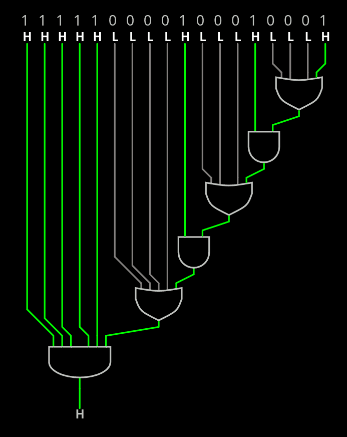

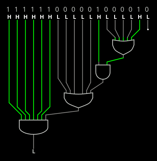

  • Number comparison with the iHP PDK
    Yann Guidon / YGDES • 03/21/2026 at 01:28 • 0 comments
    It didn't go as expected.
    The comparator doesn't use NAND/NOR because it actually makes it larger and/or bigger, and what matters is the critical path along the cascade. Fortunately A21OI is here and helps! the 4 gates are not in the critical datapath so over-optimising for speed is less interesting than optimising for area.
    Comparator circuit
    The tested source code is there : https://github.com/YannGuidon/miniMAC_tx/blob/main/src/gPEAC18.v
    /* This module compares a 18-bit number to the modulus.
       Compare a bitvector with the constant 258114 = 0x3F042 = 111111000001000010
       Any number equal or above raises X */
    module Compare_modulus(
        input wire [17:0] A,
        input wire En,
        output wire X
      wire t1, t2, t3, t4, t5, t6, t7, _unused;
      assign _unused = A[0]; // The LSB has no effect.
      // first layer
      (* keep *) sg13g2_and4_1 L1a3_1(.X(t1), .A(A[17]), .B(A[16]), .C(A[15]), .D(En));
      (* keep *) sg13g2_and3_1 L1a3_2(.X(t2), .A(A[14]), .B(A[13]), .C(A[12]));
      (* keep *) sg13g2_or3_1  L1o3_1(.X(t3), .A(A[11]), .B(A[10]), .C(A[ 9]));
      (* keep *) sg13g2_or3_1  L1o3_2(.X(t4), .A(A[ 3]), .B(A[ 2]), .C(A[ 1]));
      // 2nd layer
      (* keep *) sg13g2_or3_1  L2o3_3(.X(t5), .A(t3),    .B(A[ 8]), .C(A[ 7]));
      (* keep *) sg13g2_or3_1  L2o3_4(.X(t6), .A(t4),    .B(A[ 5]), .C(A[ 4]));
