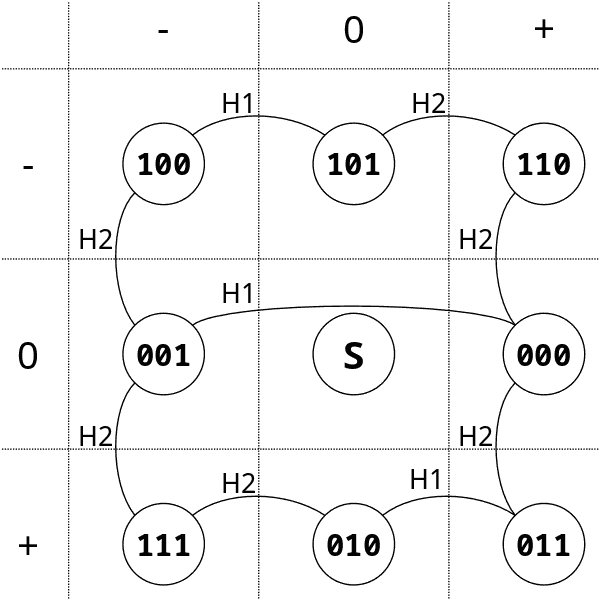

So the 3B/2T code looks the most interesting, as it is a direct divisor of 18 (the word width) and as mentioned earlier in 42. The "same" symbol, the only extra leftover code (0,0) is interesting to reduce activity/power/EMI/Droop.
The actual mapping from 8 codes to 2 trits is to be determined later. It will depend on the MSB's value, since it marks the start of a word. There is one important constraint though: the mark's symbol (11x)b must not be encoded in a trit that starts with (0,x)t or else the frame is shifted and invalid.
Some scribbling later, playing with Hamming distances, and I get this code:
bits trits 000 + 0 001 - 0 010 0 + 011 + + 100 - - 101 0 - 110 + - 111 - + S 0 0 Reverse table: trits bits - - 100 - 0 001 - + 111 0 - 101 0 0 S 0 + 010 + - 110 + 0 000 + + 011
The table looks pretty different from the others, to avalanche bit errors, and it is characterised by a central symmetry, if looked as a graph. I managed to get H2 and H3 for neighbour symbols, except for 2 cases.
And the "Same" symbol is there to reduce redundancies.

One thing is lost, compared to MLT-3 : the differential NRZi is polarity-independent so you can swap the pair's wire at will. The symmetry of the symbol table helps with adjusting to the signal polarity, with just a few XOR here and there:
XOR LSB: 000 → +0 // -0 → 001 110 → +- // -+ → 111 XOR all: 010 → 0+ // 0- → 101 011 → ++ // -- → 100
