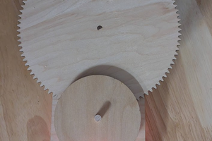

Greetings, everyone! I'm excited to introduce my newest creation—a 3D-printed gearbox! In order to prepare for an upcoming kinetic sculpture project, the objective of this project was to construct a functioning gearbox with two output shafts that spin in opposing directions. To generate spur gears, we installed an addon or extension in Fusion360 called GF GEAR GENERATOR. The gears are then organized so that they can output two shafts, each of which rotates in the opposite direction. We have utilized 3D printing for the gearbox's body and even the gears themselves. Originally, I intended to combine the gearbox and kinetic sculpture into a single part, but it would have been too lengthy, so I split the articles into two: one for the gearbox and one for the kinetic sculpture. The gearbox construction process is the primary subject of this article.

Two sets of gears are used in the model; one set rotates in a clockwise direction, while the second set rotates counterclockwise. Spur gears make up both sets, which were all produced using Fusion360's GF GEAR plugin.
Gear D from one set and Gear A from the other set are connected in the two sets; we modeled both sets so that Gear D can be placed on top of Gear A. Both gears revolve in the same direction because Gear A is attached to the motor.
GEAR SET 1-CLOCKWISE
Set 1 contains the Main Gear A, a 10-teeth spur gear with a 4 mm modulus. The modulus here is the size of the gear teeth.
In order to accommodate Gear D, we have modeled a holder that sits atop Gear A and functions similarly to a key socket.
Gear B, which is the same size as Gear A but is only modeled to transfer rotation from Main Gear A to Gear C, comes next in Set 1. This is the Idler gear, or gear B. The idler gear's main job is to transfer motion from gear A to gear C; it does not alter rotational speed or direction.
Gear C, a 15-teeth, 4mm modulus gear with a shaft in the center, is the rotation output gear. Out rotation will be transferred via this shaft.
Gears A, B, and C revolve in clockwise, counterclockwise, and clockwise directions, respectively.
This setup is useful for maintaining the same rotational direction between the input and output gears while transmitting motion over a distance. It is commonly used in various mechanical systems to manage space constraints and achieve desired mechanical advantages.
GEAR SET 2-ANTICLOCKWISE
In Gear Set 2, we have only two gears, Gear D and Gear E.
Here, Gear D serves as the input gear, receiving rotation from the lower Gear A that it is fitted onto. Gear D can be placed on top of Gear A to fit in position since it has a slot in the middle. The clockwise direction of rotation is the same for both Gear D and Gear A.
Gear D transfers rotation to gear E, which rotates in a counterclockwise direction.
Gear C from Set 1 and Gear E are positioned on top of each other and share the same rotational axis; Gear C rotates in a clockwise direction while Gear E rotates counterclockwise.
