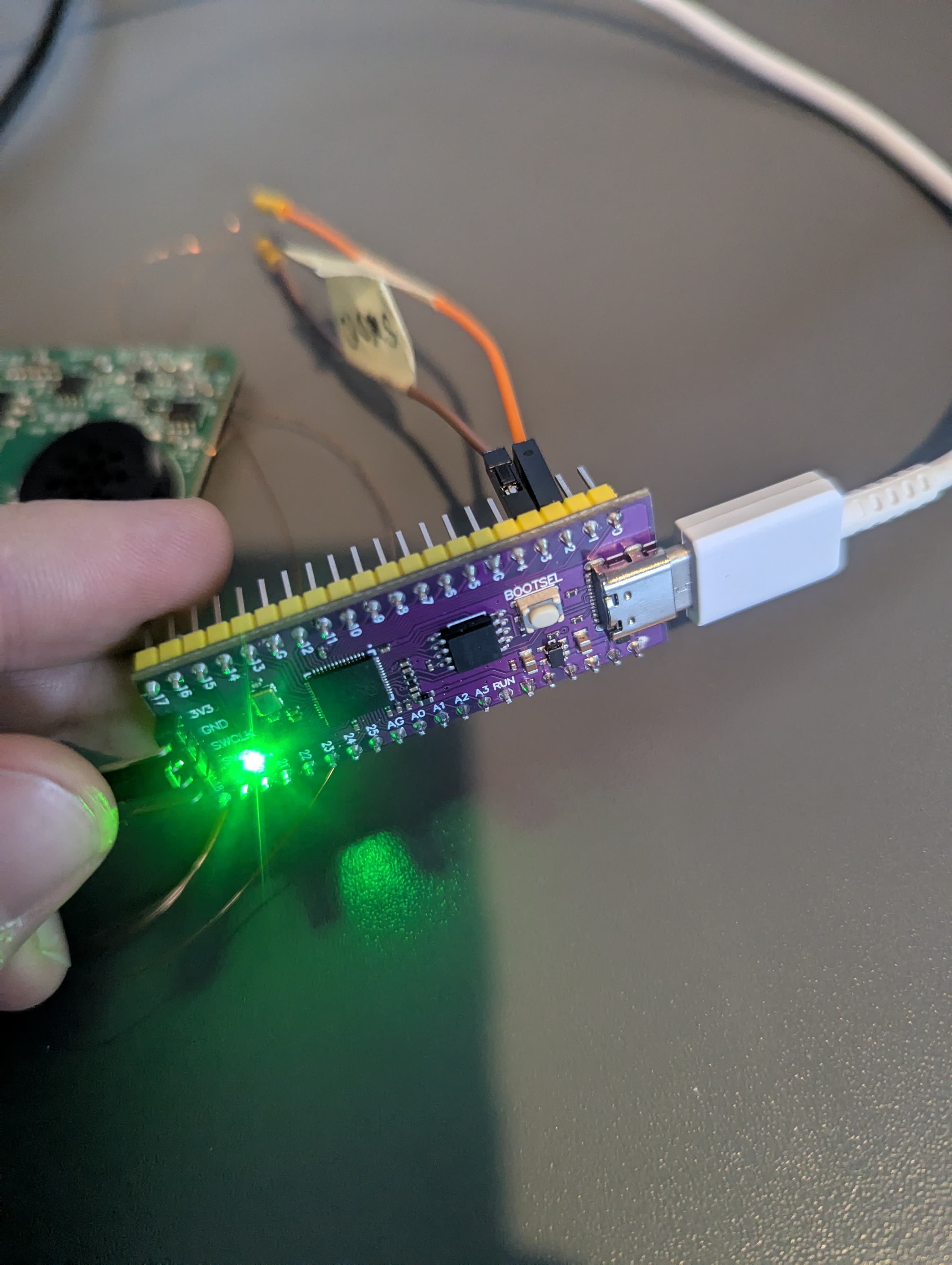

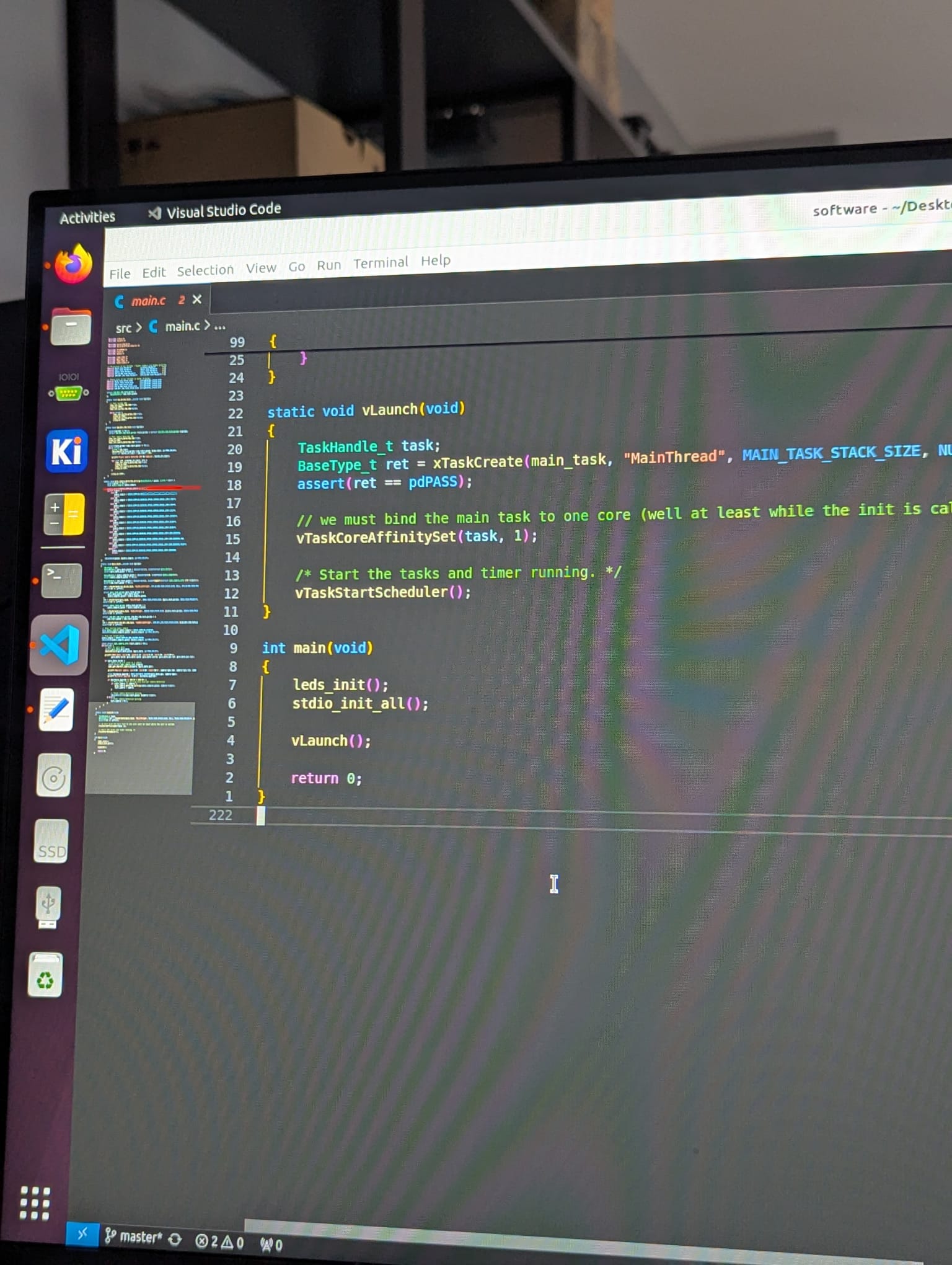

  • Writing and debugging first software
    Ivan Vnucec11/22/2024 at 08:19 0 comments
    Making progress on my #Catchcam project - a speed camera detector.
    Just started writing the first software for it and now debugging using Raspberry Pi Pico and VS Code.
    If you're interested in trying out a sample, send me an email at vnucec.ivan@gmail.com.

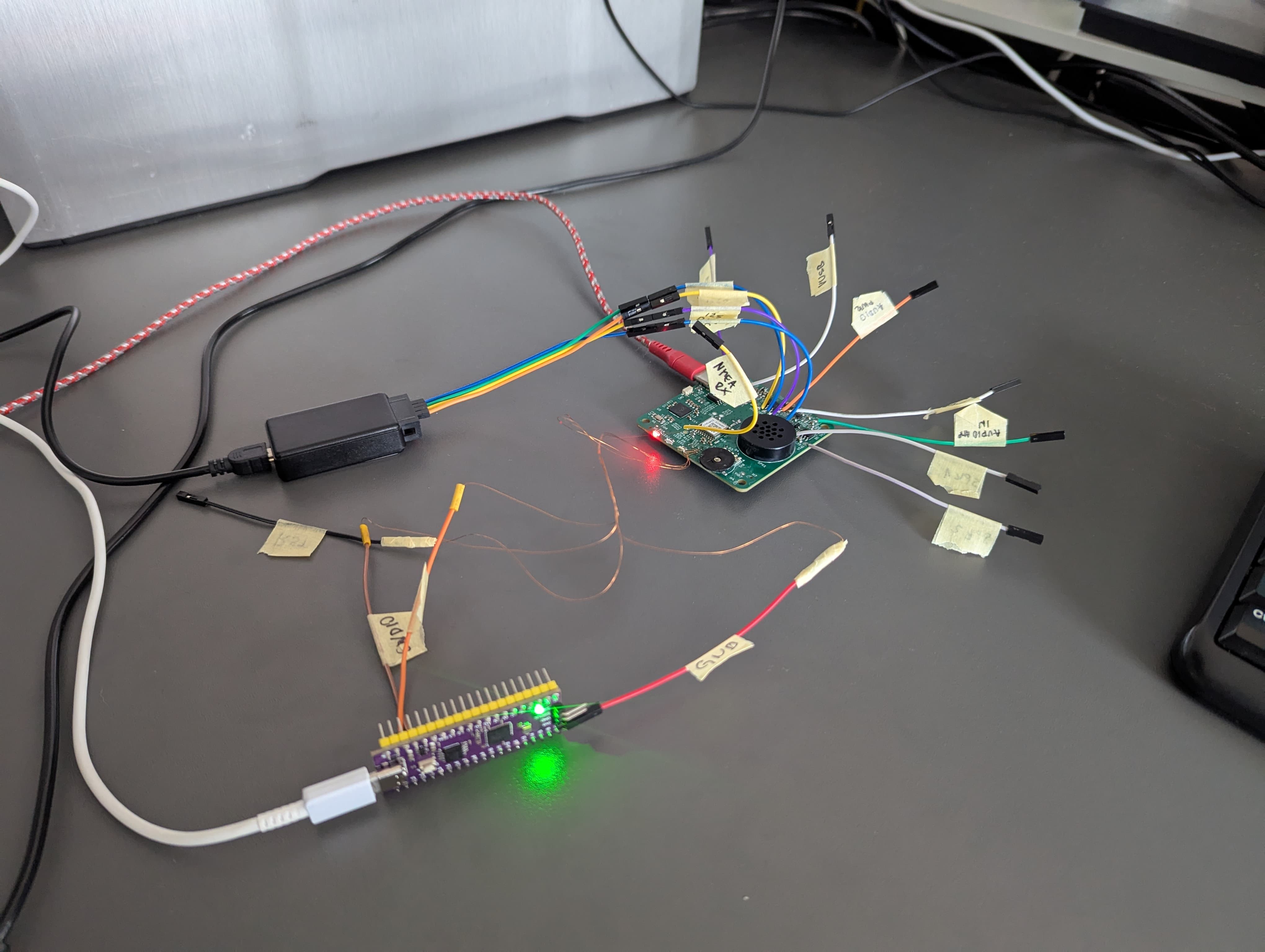

  • Boards have finally arrived
    Ivan Vnucec11/21/2024 at 15:02 0 comments
    After weeks of waiting, Catchcam boards have finally arrived!
    I've ordered 10 boards with components assembly included. The quality of the boards is exceptional.
    The boards are quite clean and the components are well soldered.
    I've powered up the board, and tested the power supply voltages. They all seem fine.
    Next, I will try to flash and debug a simple program. Stay tuned!
