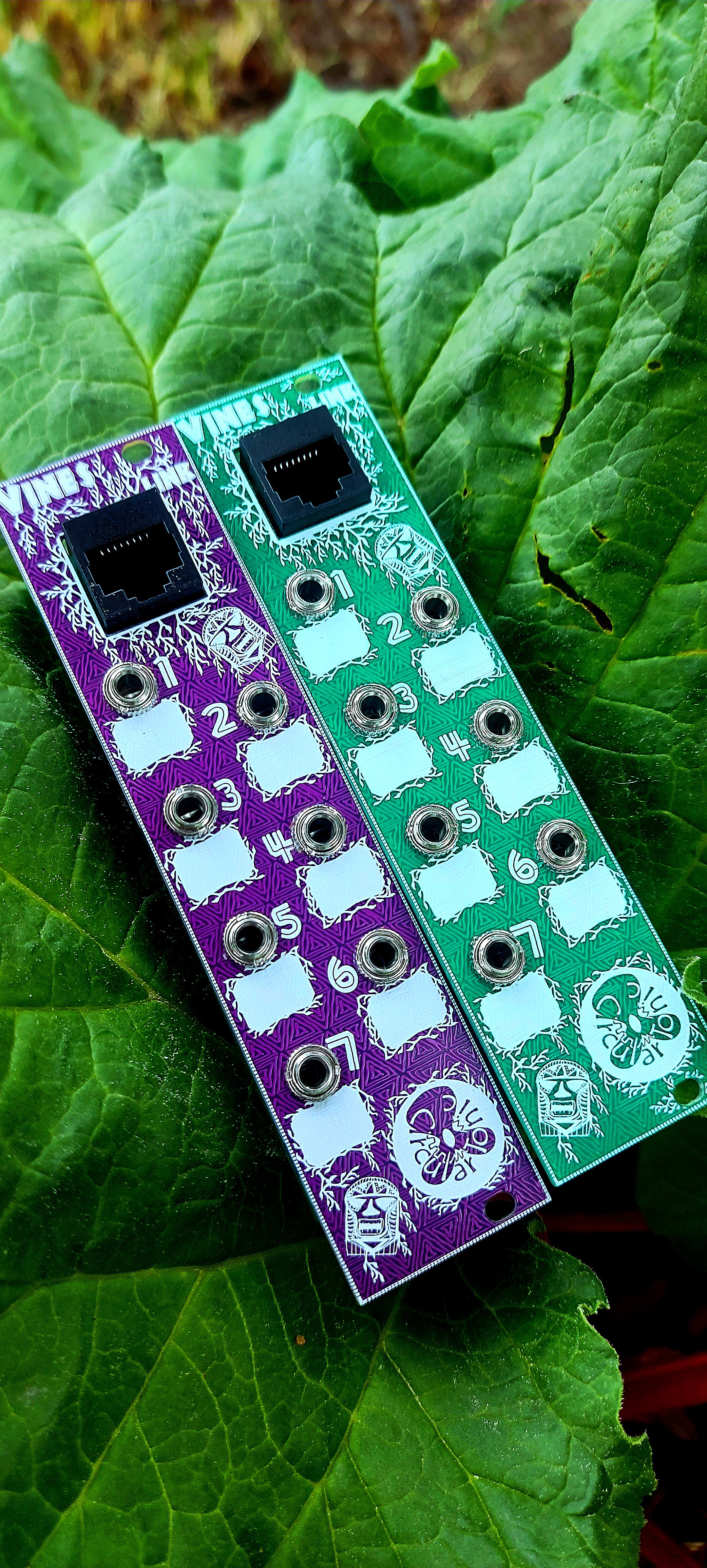

Ordered some Green versions of my VinesLink module. Lucked out twice. Had to drill out more panels. Because the 3.5mm PCB Holes didn't fit again. I must of sent the wrong panel revision. But I got the Drill to burr. Really like how the Green Panels Turned out. They really Vibe with the Jungle Theme. Really Like the added Feature of the inside case Jack as a option for routing.

This is pretty much the finalised design. I think it turned out great. I think as a Passive module is pretty feature complete compared to the Original Design. Really like how the artwork turned out. Not bad for my First use of SMT Parts.
Added The Feature to Display incoming Signals to the Jacks. When the Jacks are Unplugged You can Visually see Incoming Signals. When you Plug a jack in the LEDs are Disconnected to prevent any Voltage Drop to the Patch. The module is still passive and I think it is Quite a clever way to add some Visual Feedback to this module. Still got a few Refinements to do. Before I order the First Prototype.
