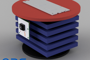

VegTrack360 solves this problem with a simple, cost-effective rotating camera platform. Using a single RGB camera, VegTrack360 captures seamless 360° panoramic images through horizontal and vertical rotation. The system is easy to build and upgrade, enabling advanced applications like thermal imaging or the use of multispectral sensor.

  1. Rotating Camera System: Mounted on a post or building, the system captures panoramic images in multiple spectral bands. Sensors can be exchanged and mounting thermal or multispectral sensors is possible.
  2. Advanced Image Processing: Using the Jetson Nano's edge-computing capabilities, the images can be converted to panoramas using e.g. openCV.
  3. DIY and Self-Sufficient Design: The system is designed to be easily reproducible using very common and relatively cheap components.
