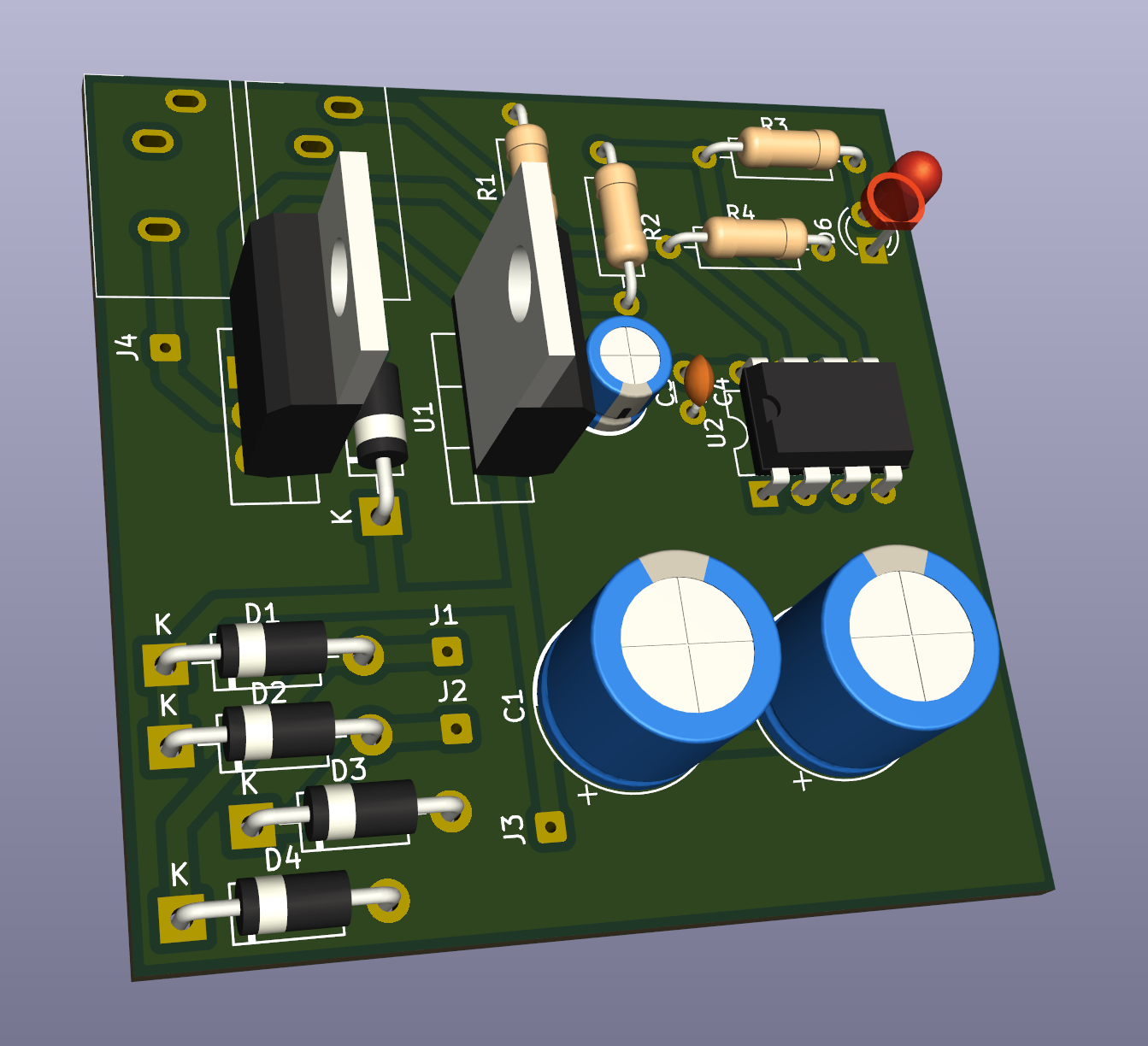

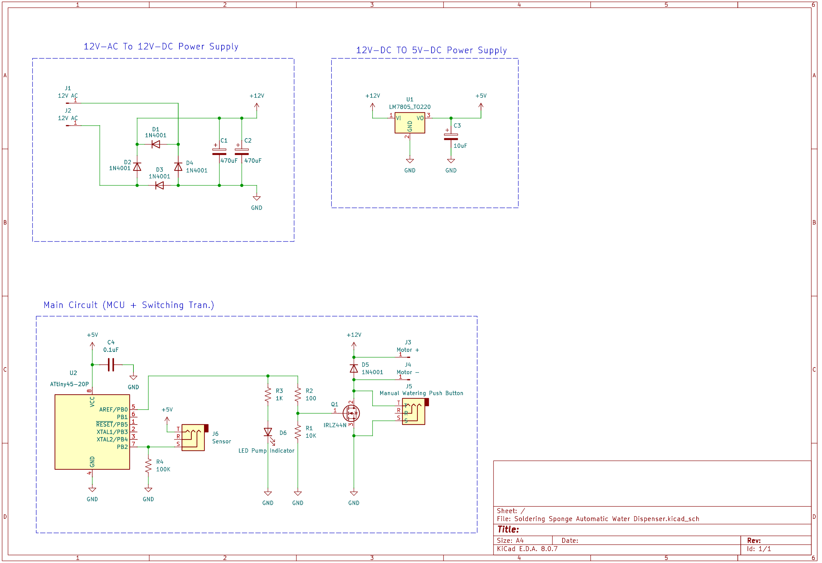

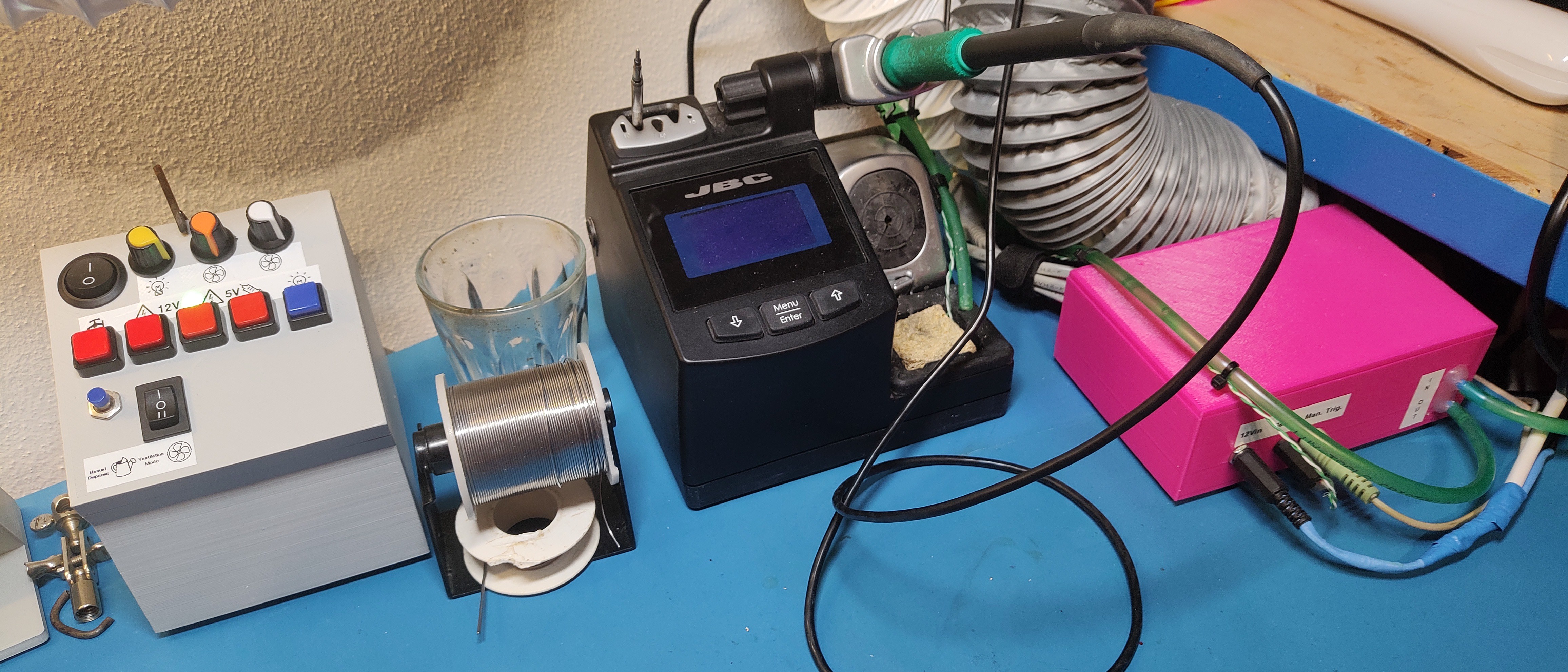

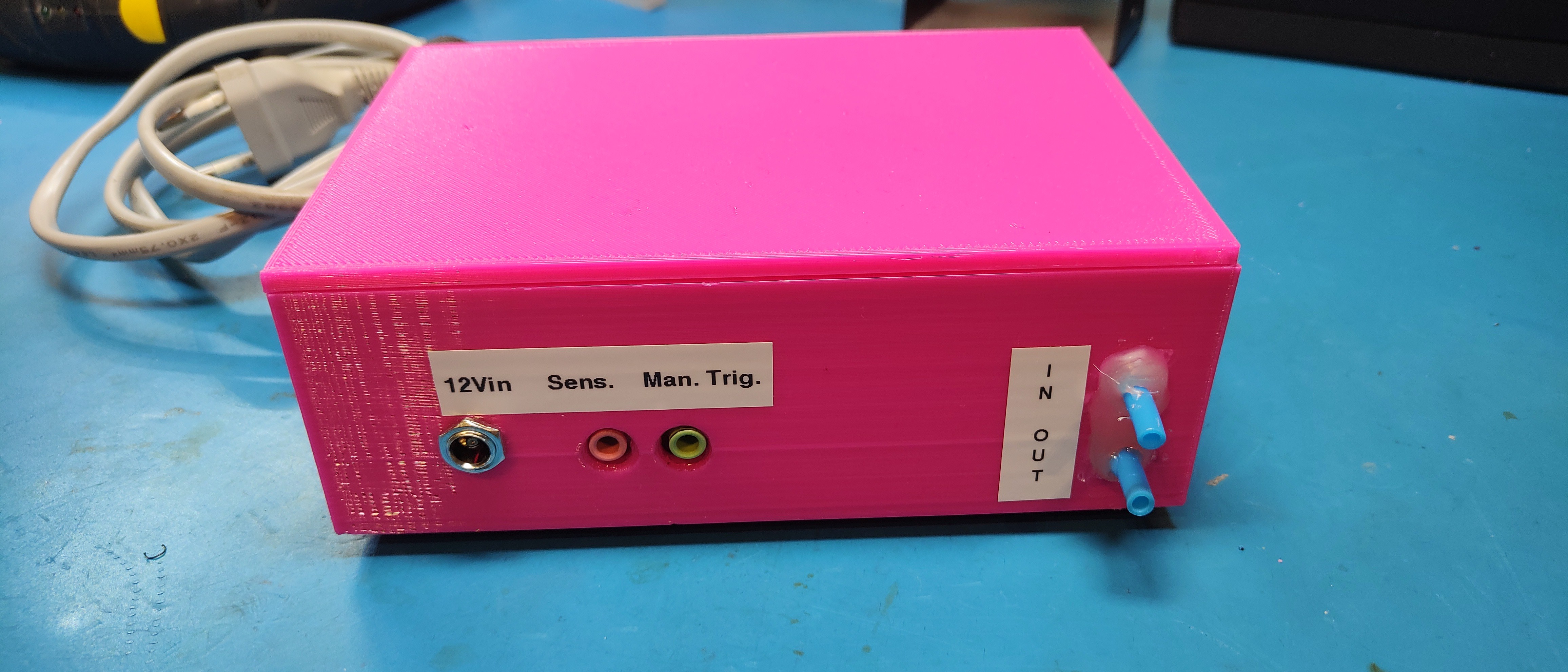

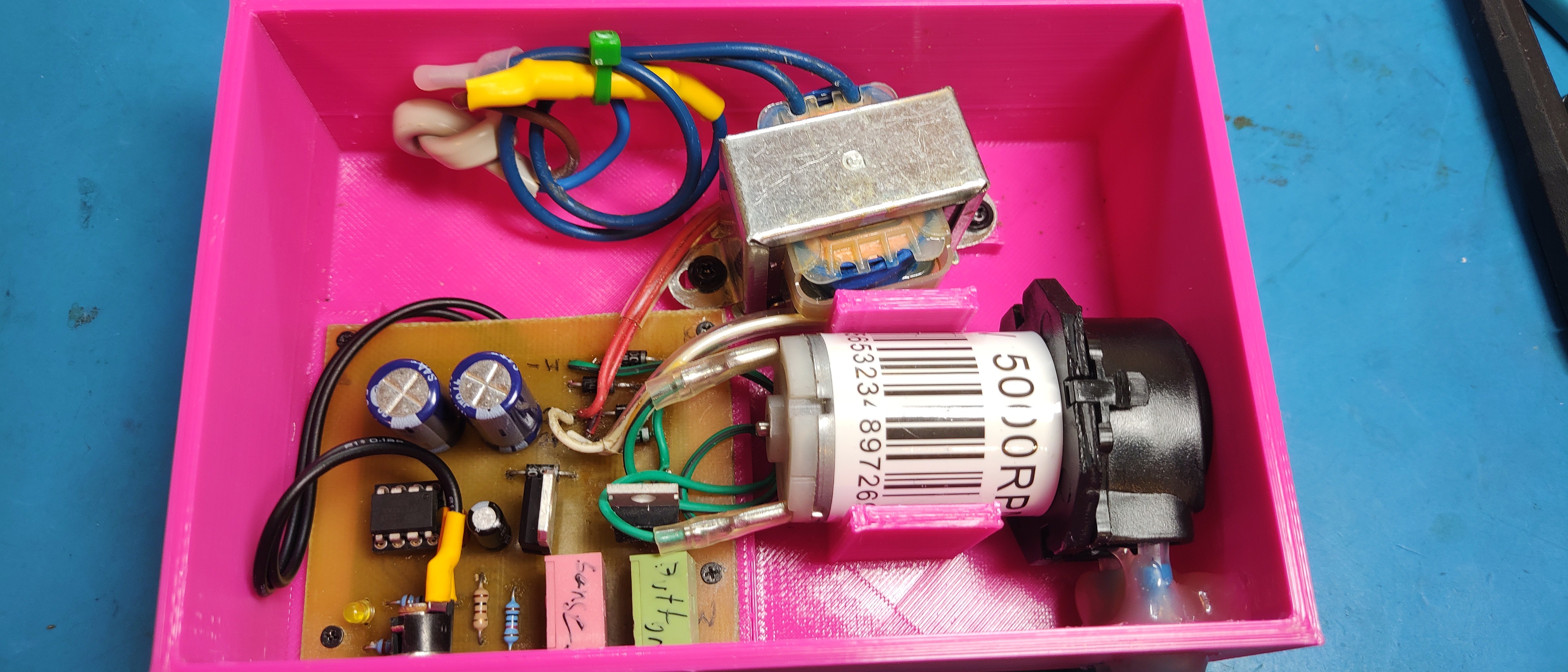

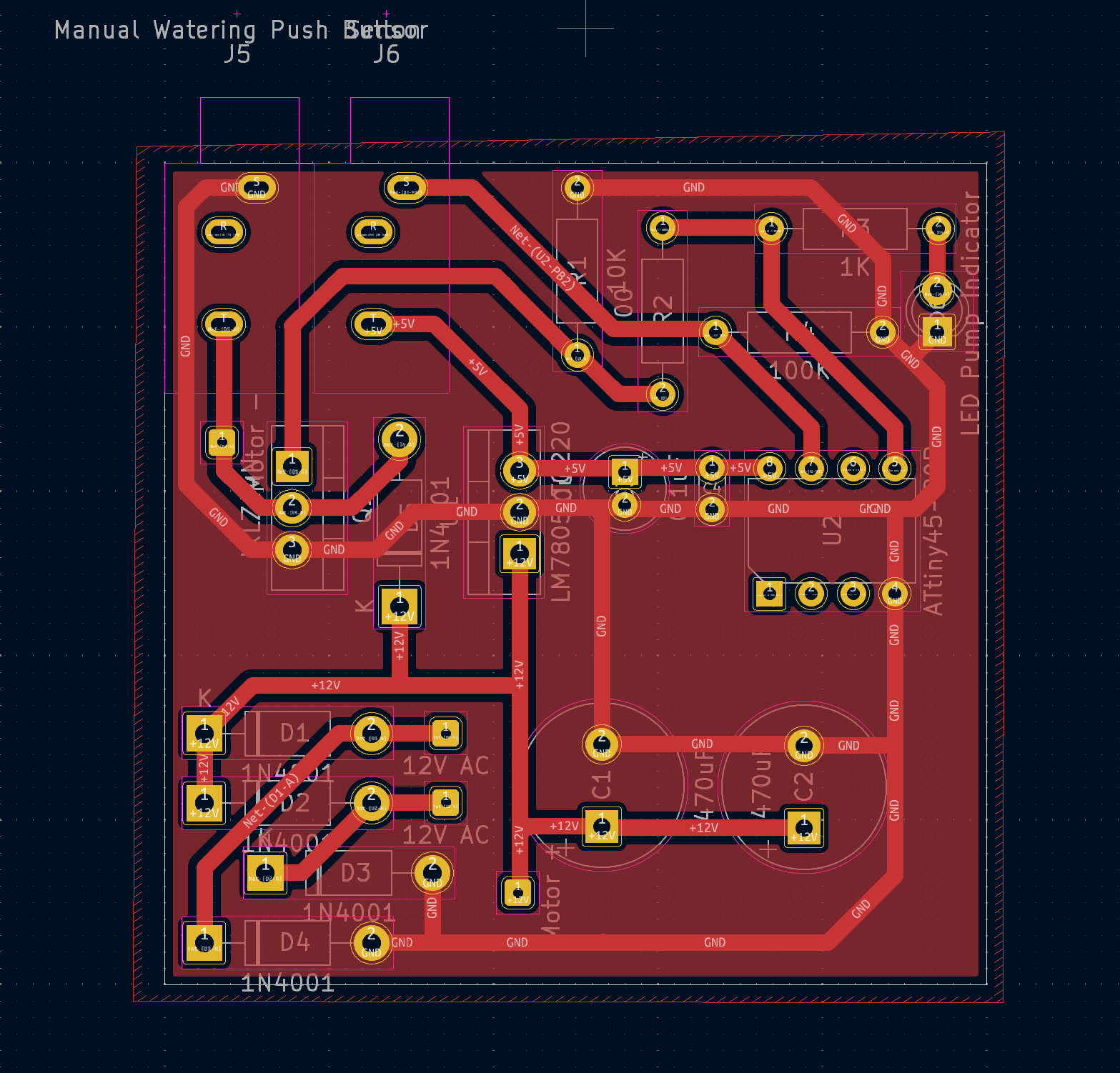

I finally got around(started almost a decade ago) to finishing this project and blogging about it. I made a post on my own self-hosted blog here because I prefer decentralization over centralized platforms like Hackaday, Hackster.io, Medium, etc. But I thought I could at least finish up what I started.
All the project files can also be found on GitHub here.
Schematic
PCB
Build
