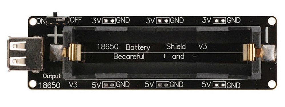

    • I needed a UPS for the Raspberry Pi to handle sudden power loss and prevent file corruption.
    • The "Wemo 18650 Battery Shield" will output whilst taking power and it's cheap. I like cheap.

    A "18650 Shield" is used to maintain power to the Raspberry Pi upon removal of the main power (e-stop) allowing safe shutdown after main power-off. It uses GPIOs to trigger the RPi to shutdown, waits for the RPi to signal it is (almost) complete before opening a relay to disconnect the UPS power and prevent deep discharge of the battery.

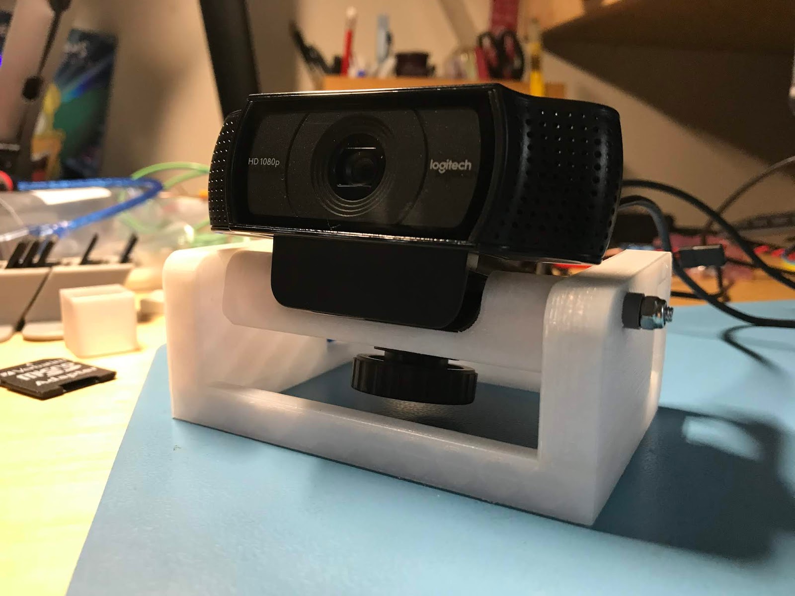

  • Logitech C920 camera pitch mount
    Paul Crouch • 01/08/2019 at 23:30 • 0 comments
    Logitech C920 pitch mount - still needs painting.
    Waaayy back in December I modelled a pitch-roll camera mount for my Logitech C920 (autofocus, HD) to go on the head ring gear. Then I changed the approach and redesigned it... and again, then I dropped the roll axis as I was running in circles and it wasn't strictly necessary. Four or so printed iterations later I have a functioning active pitch control for the camera (yaw is taken care of by head rotation) allowing ±45° swing.
    The 5th iteration (not including previous pitch-roll designs) and includes a remixed version of:
    Logitech C920 Adapter for RaffoSan's Camera Arm by Felwat
    I modified the C920 mount so it now has a flat base for taping or welding. My remix can be found on Thingiverse: https://www.thingiverse.com/thing:3343134
    I subsequently found what may have been a valid alternative:
    Logitech C920 Universal Webcam Mount (Scews or 3M VHB) by ps915
    First time printing with PETG too. I'm waiting for some paint to arrive then I'll see how well it takes it. Methylene chloride seems to work nicely for welding and smoothing.
    Pitch-roll
    Nope
    ABS pitch-roll mount that was way too small
    What was I thinking?!?
    Servo actuation fail
    Almost
    Baggy arm
    Bad bearing retainer
    Getting there
    Tweaked and snapped
    A thing of beauty!
    5th time lucky!

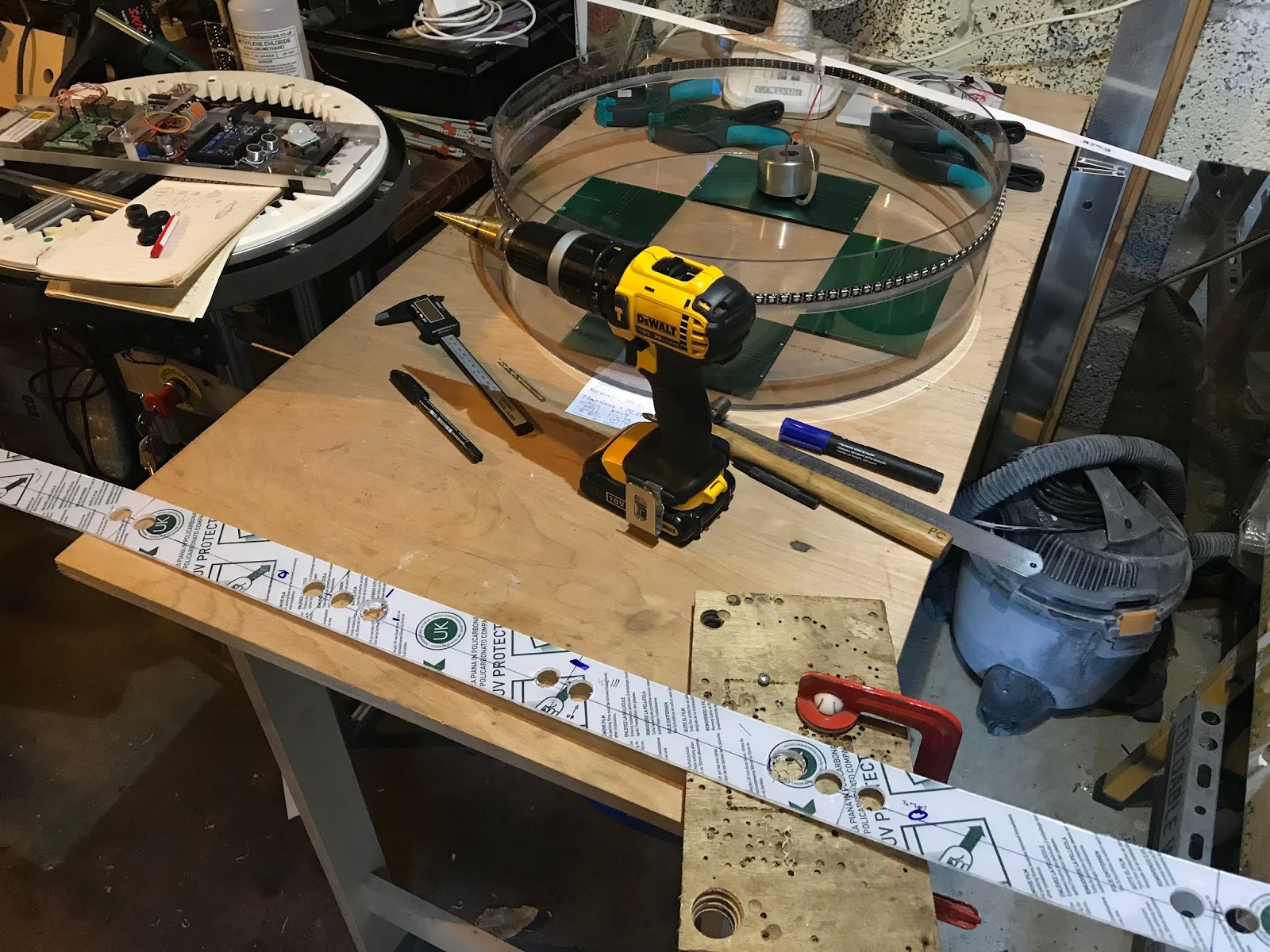

  • Polycarbonate head/camera shield
    Paul Crouch • 08/04/2018 at 19:34 • 0 comments
    I'd read that polycarbonate can be welded with methylene chloride so I bought some (1 litre for less than £10 including the £5 shipping). I tested it on some scraps of polycarb and ABS and can say it solvent-welds polycarbonate and ABS extremely well. In the photo below, the top two pieces are well-and-truly fused and will not peel apart and the bottom piece, that was bonded to a failed ABS print, still has the skin of the print on it after some not-inconsiderable force was used to separate them.
    Solvent-weld polycarbonate and ABS with methylene chloride.
    Just to check; acetone barely touches polycarbonate and though it does fog it slightly it then fades. The polycarbonate strip in the photo below was dipped for a few seconds in each chemical. I would say methylene chloride is better than acetone for ABS too, certainly faster, though harder to spell :-)
    Acetone dip on top, methylene chloride on bottom.
    Assembly
    I did a dry-fit of the parts and checked for any show-stoppers. I didn't want to ruin the material. It's not hugely expensive but it's not zero cost either and would take another week to come through.
    Dry-fit.
    The image below shows my intended plan. The main reasons for the overly complicated layering are because I didn't want the LED strip to sit proud of the main skin and I'd had an internal dimension to match for mounting.
    The plan.
    I just had to hope I'd not ruined the plastic after attempting to solvent-weld the camera shield and cap with a less-than-steady hand. Annoyingly I managed to scuff the polycarb too. As advised, I left it  overnight to fully set.
    Letting it go off over night.
    It's far from flawless, but it fits and I'm making progress! In my eagerness, I didn't take any photos of the spacer strip being bonded. I used four clamps (in the photo above) to clamp the spacer strip after I'd applied the methylene chloride with a small paint brush, then I brought the "oldest" clamp to the newest position, working my way around. If you don't look too closely it looks fine. It's a first for me so shouldn't beat myself up over it.
    Test fit for size.
    Before I mounted the RGB LED strip I again did a test-fit. The wire termination end has heat-shrink tubing on it that I cut off so it wouldn't restrict the wire routing. I'll have to re-insulate it somehow. To my surprise there was another LED under the heatshrink. I hadn't given it much thought, how else would they do it? They're not going to remove one, that's not cost effective. Just struck me as odd.
    First LED is covered up. Common practice?
    With the LEDs stuck on, I clamped the strip of polycarb (that will become the sensor collar) in place to get a feel for how it will look. The white protective film is a close match for the white that it will eventually be painted. I'll need to mask and paint the dodgy-looking welded areas too.
    Mock-up of sensor collar.

    I've purchased the necessary polycarbonate for the protective camera shield and sensor mount, though I've not had chance to assemble it. I intend to use a Microsoft Kinect 2 depth camera (for point-cloud in ROS) and a stereoscopic camera for tele-presence operation, both mounted on the ring. I have the Kinect but I'm undecided on how to do the 3D imaging. To begin with, I'll be starting with a regular camera mounted on simple pitch-roll mechanism (yaw and active camera swapping taken care of by the ring). I have purchased a Logitech C920 for development purposes as it provides HD quality images with auto-focus and comes with stereo microphones (may help get started with remote sound location, though it'll probably be limited as the camera will be behind the polycarbonate shield).
    Testing the RGB LEDs
    A water-resistant RGB LED strip (100 per meter) will provide short-range illumination for the cameras in addition to simple communication (of sorts) to anyone nearby. The LEDs will be recessed around the head, below the camera shield, above the sensor ring (the white strip in image above).
    I printed the ring-gear segments in ABS and solvent welded them together with acetone. The ring was then screwed down through holes drilled in the lazy-susan bearing. A 3DP 8T pinion gear mounts to the gearhead motor to drive the 64T ring-gear. Yes, it hurts if you absentmindedly trap a finger in there.
    Aluminium angle and 6mm polycarbonate (I used what I had handy) form the bridge which carries some electronics and a slip-ring. A small polycarbonate deck spans the width of the bridge above the slip-ring to keep an IMU (MPU6050) centered. The IMU will be used to keep the robot level and balanced. The electronics may be re-housed in waterproof enclosures if I ever get this thing mobile.
