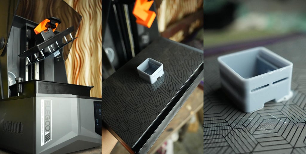

Step 2: 3D Printing
After exploring the model's STL file. I 3D printed each model. The main body is printed using a resin printer with standard resin . Then I spray painted matt black. This project can be also printed using FDM printers but the letter might not be visible in it. The resin printer allows me to produce my model with great accuracy , you can find both .STL file down below
after printing the main body i spay painted in in matte black
also i printed the diffuser in white PLA using FDM printer
