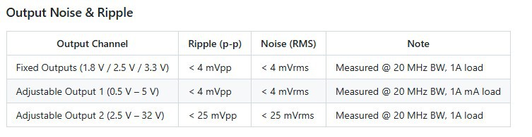

EEEngineer4Ever wrote 10/28/2025 at 14:15 point
Added output ripple and noise measurement results.

lohikarhu wrote 12/19/2024 at 01:24 point
Without actual evaluation of the power output, with good oscilloscope probing, and probing technique...it would be nice to see detailed schematics and preliminary evaluation results, in order to do a first level design review...
EEEngineer4Ever wrote 12/19/2024 at 14:39 point
I will share all the results whenever I make some measurements and I will also share final  schematics soon. Thanks for your interest.
