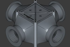

Sonic Propulsion experiments
Using Tesla Valves to rectify AC fluid flows
Public Chat
ChatGPT gave us the interesting idea of trying to turn sound into propulsion. In theory, a Tesla valve in the turbulent regime should be able to block flows in one direction while allowing flows in the other direction. Low amplitude vibrations might not provide sufficient stroke length to allow a net flow, but a high amplitude reciprocating device might work. Jellyfish operate by similar principles, but at very low frequencies and long stroke lengths, with plastic deformation allowed. The principles experimented with here could be useful to build pumps with minimal moving parts, to prevent things from getting tangled in them in locations where pumps would be difficult to service. They may also be useful in systems handling cells or blood, where sealing surfaces could otherwise damage the cells.
The geometry is designed to move through the fluid with low resistance in one direction and high resistance in the other. This resistance corresponds with the force the pump exerts on the fluid. Our design attempts to maximize the difference in force applied to the fluid in the two directions. This asymmetry is produced in two ways.
The first is the asymmetric force applied by a push-pull solenoid motor on our Tesla Valve like geometry. It provides a quick pulling force followed by a slower returning force from the spring. The faster stroke forces more water to move with the geometry instead of moving around it, causing large resistance. Additionally, the higher velocity increases the fluid's turbulence and therefore resistance.
Second, the design of the geometry is asymmetric. On the aft stroke, as shown in Fig. 1, the fluid can smoothly flow around the geometry.
Figure 1: Aft Stroke.
In the Forward stroke, Fig. 2, the opposite is true. The fluid is redirected causing a larger amount of turbulence and flow resistance.
Figure 2: Forward Stroke.
We also designed a similar geometry where the fluid flow is completely internal to the structure, Fig 3. This design was found to provide slightly less force but may work better for certain applications.
Figure 3: Design with internal flow.
Demonstration:
Tesla Valve - Outer Geometry.step
step - 38.07 kB - 01/24/2025 at 19:25
Download
C-Clamp-OuterGeometry.step
step - 27.14 kB - 01/24/2025 at 19:25
Download
Motor-Valve Attachment Piece 1 - Outer Geometry.step
step - 30.47 kB - 01/24/2025 at 19:25
Download
Motor-Valve Attachment Piece 2 - Outer Geometry.step
step - 7.01 kB - 01/24/2025 at 19:25
Download
C-Clamp-InnerGeometry.step
step - 31.18 kB - 01/24/2025 at 19:25
Download
View all 8 files
  • 1
    Bill of Materials
    Tools:
    • Band saw or anything that can cut the plastic tube
    • Soldering equipment
    • Hot glue gun
    Mechanical:
    Electrical:
  • 2
    Mechanical Assembly
    Please watch the demonstration video for an example of this process.
    1. Solder longer wires onto the motors existing wires to make it easier to use.
    2. Attach the C-Clamp to the solenoid motor and tighten with screw.
    3. Force the wooden sticks through the holes in the C-clamp. The holes should be about 0.15mm wider than the wooden sticks for a tight fit.
    4. Cut your tube in half and make 4 notches for the wooden sticks to be flush with the edge and 1 notch to insert the dye.
    5. Use Hot glue to attach the Motor-Pump attachment pieces to the Tesla Pump. Make sure to orient the geometry so the forward, high resistance stroke will be pushed by the force of the motor when in the high state, not the return from the spring.
    6. Attach the Tesla valve pieces to your motor.
    7. Place the motor into the cut tube and then tape the other side to enclose the device.
  • 3
    Electrical Design
    The pump is powered by a square wave provided to the solenoid motor. The square wave has an amplitude of 12V, a frequency of 4 Hz and a duty cycle of 50%.
    Set up your circuit according to the schematic below.
    The circuit includes:
    • V1: Benchtop power supply providing 12V DC.
    • V2: Arduino Mega 2560 generating a 4 Hz square wave via pin 9.
    • L1: Solenoid motor.
    • Q1: TIP35C Transistor to amplify the Arduino signal.
    • D1/D2: 1N4007 Diodes for protection against voltage spikes.
    • R1: 50Ω resistor to limit base current to the transistor.
View all 4 instructions
