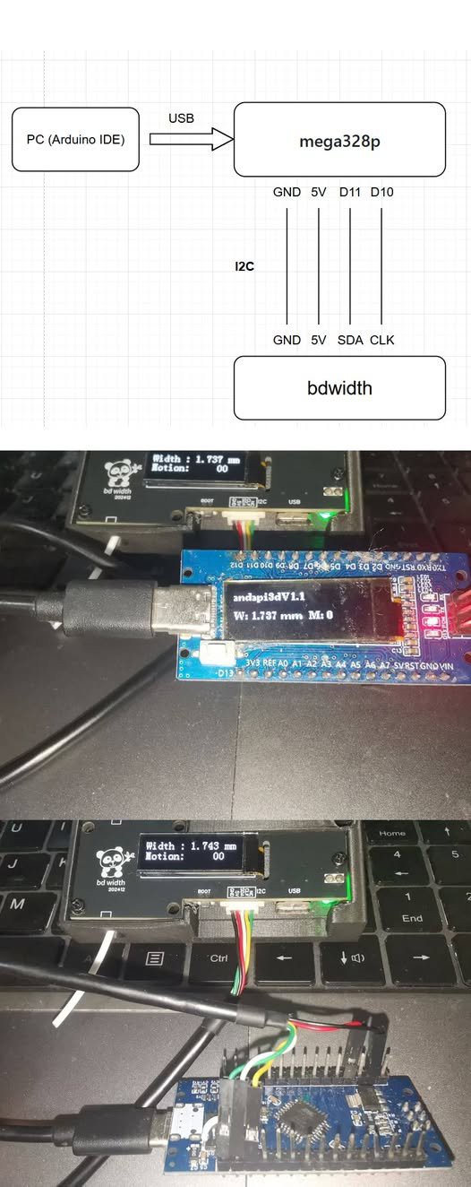

We have developed a unique algorithm that can automatically compensates for the filament shadow on the CCD sensor even if the filament moves at different heights and angles. Flow rate adjust: adjust the flow rate in real time Jam/Runout: Pause the printer while jam or runout (laser motion sensor chip) Width Accuracy: +/- 0.015mm (high resolution 0.005mm ccd sensor chip) Connection: USB or I2C It works right out of the box. No mechanical contact with the filament, no wear due to the use of optical components Just power it, then you can measure your filament motion&diameter. more details: https://github.com/markniu/bdwidth

  • Ardunio code
    mark • 08/13/2025 at 01:48 • 0 comments
    for someone wants the Arduino test code to communicate with bdwidth sensor https://github.com/.../main/arduino/mega328p_bdwidth.ino
