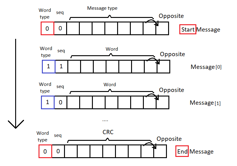

The exchange protocol is very simple yet efficient; it uses on-off keying (OOK): a binary 1 is represented by the presence of a signal, whereas a 0 corresponds to silence.
I designed a minimalist, scalable transmission protocol. Each word has a variable length: it can be 8 bits for a character or a type field. The type field lets the device determine the message length. The last bit of each word is the inverse of the preceding bit, ensuring a transition that triggers flushing the message to memory (see code). The type field and a transmission sequence allow the device to verify the link’s consistency and state. The message length is also variable, and the frame ends with a CRC for integrity checking.

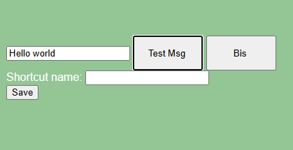

The Emission Web Page
https://cdn.hackaday.io/files/2021968650753664/keypad.html.zip
also available here : https://oktoapp.com/keypad/

The proposed web page requires no app installation; it runs in the browser and stores messages in localStorage,
so the data stays under the user’s control.
The page is a static asset and can be hosted anywhere.
