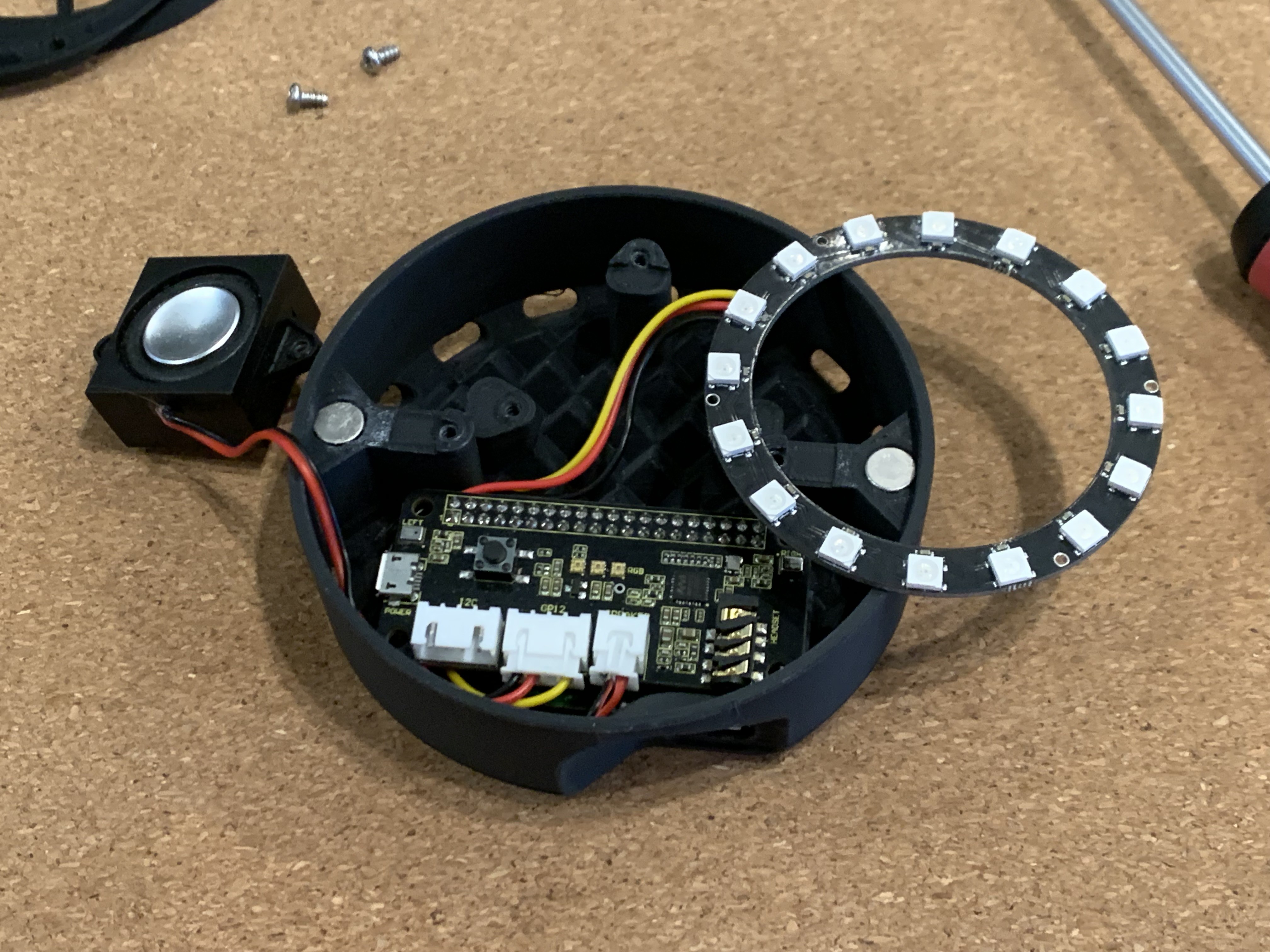

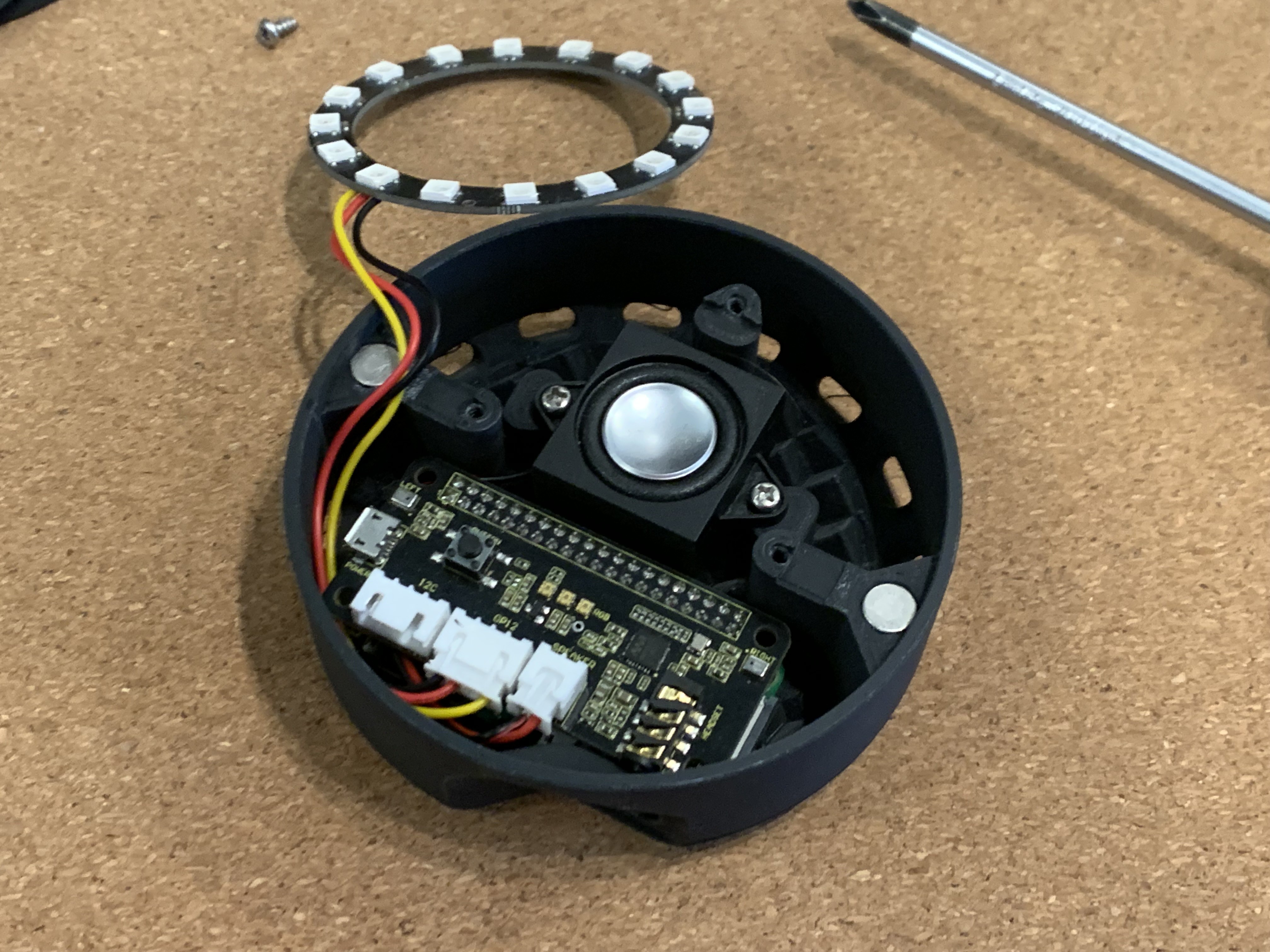

    Connect the speaker and neopixel ring (optional) to the Seeedstudio Respeaker 2-mic hat. According to the documentation for the Respeaker hat, the JST connector marked "GPIO12" is connected to the Raspberry Pi as follows (GND, 3V3, GPIO13, GPIO12). So in the picture below the neopixel data pin is connected to the Raspberry Pi's GPIO12 pin.

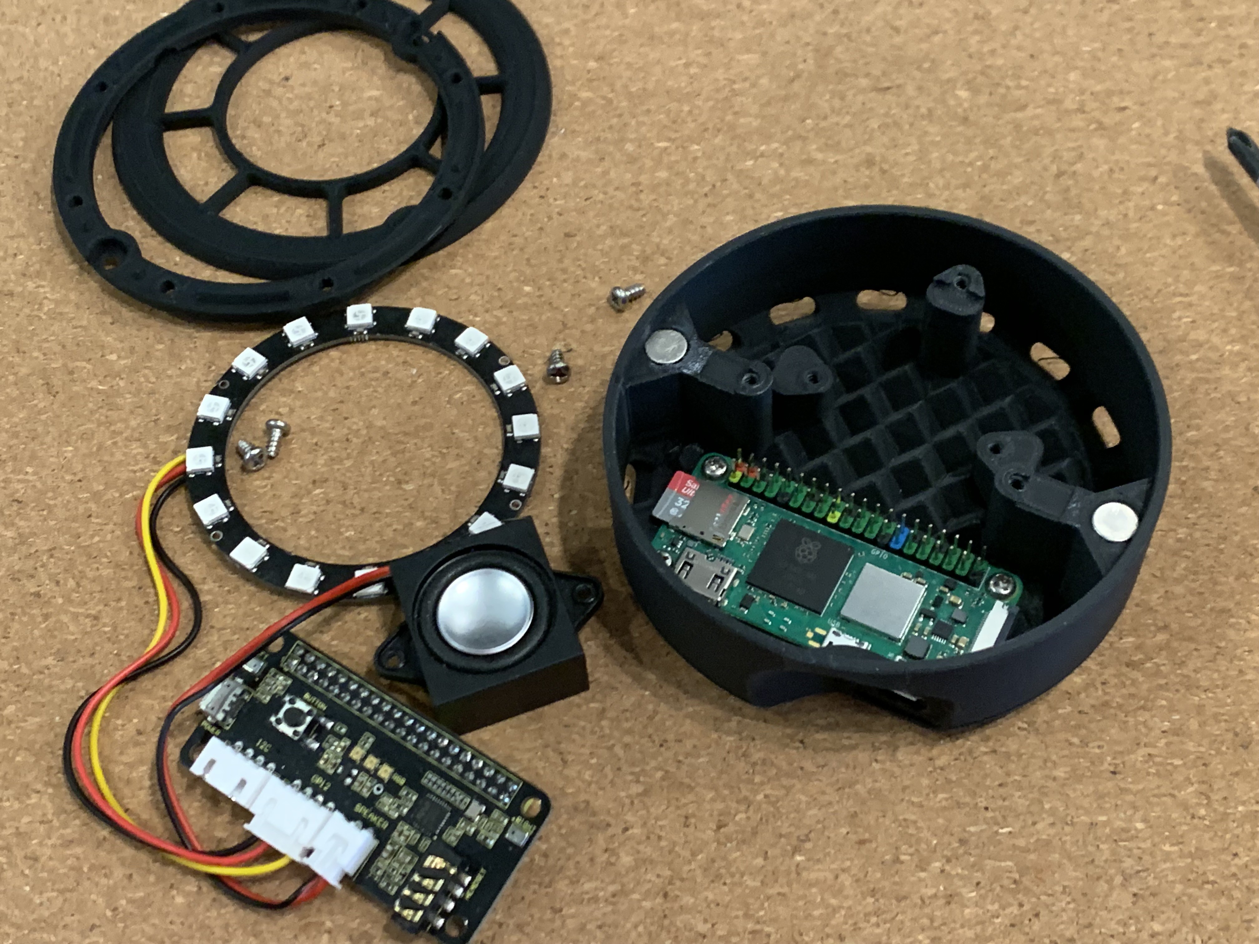

    Install the Raspberry Pi Zero with 4x m3 x 6mm self-tapping plastic screws, and install 2x 8mmx3mm magnets
  • 2
    Further assembly

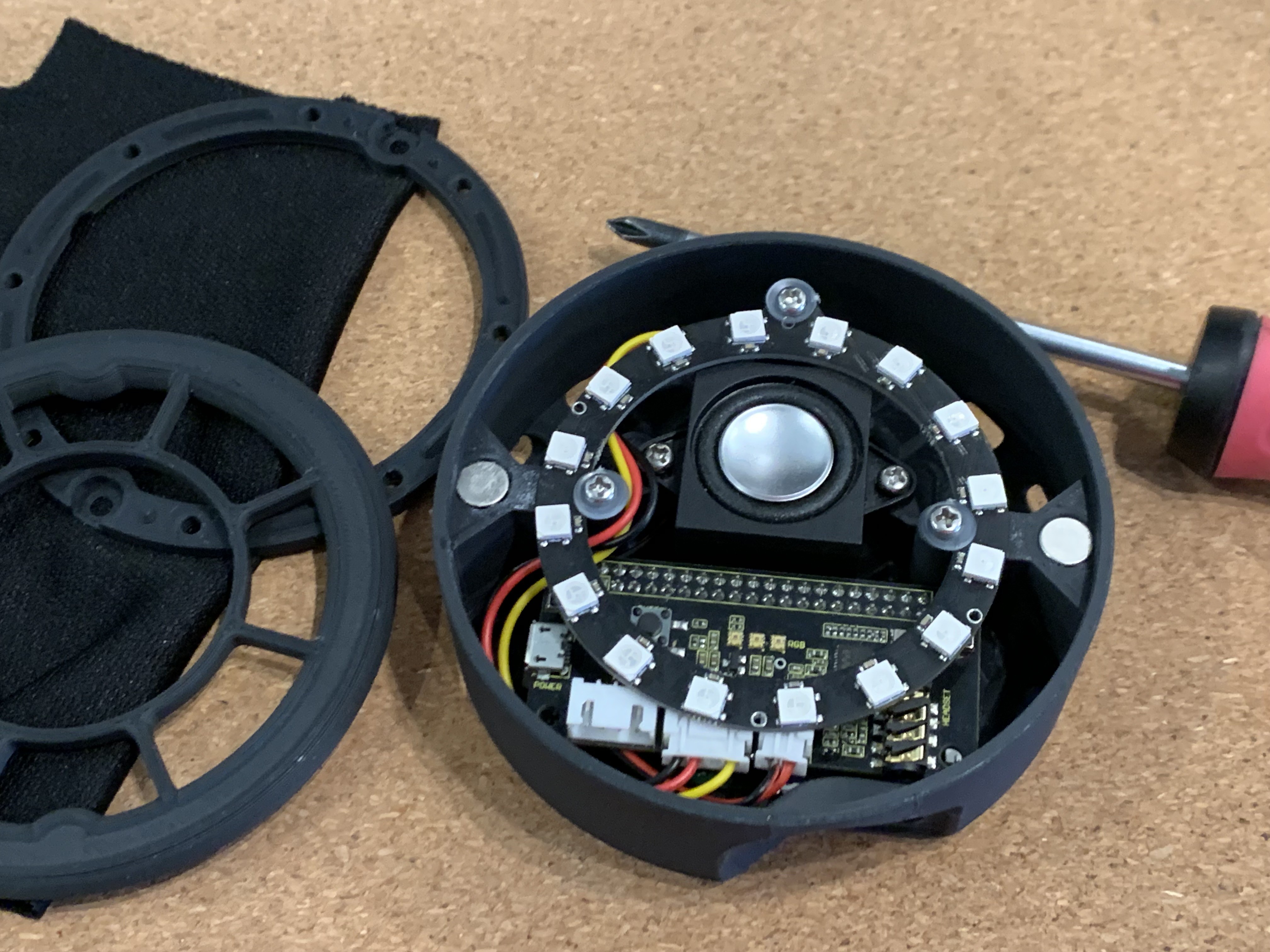

    Install the Respeaker hat, being careful to position the wires
    Install the speaker
    Install the neopixel ring

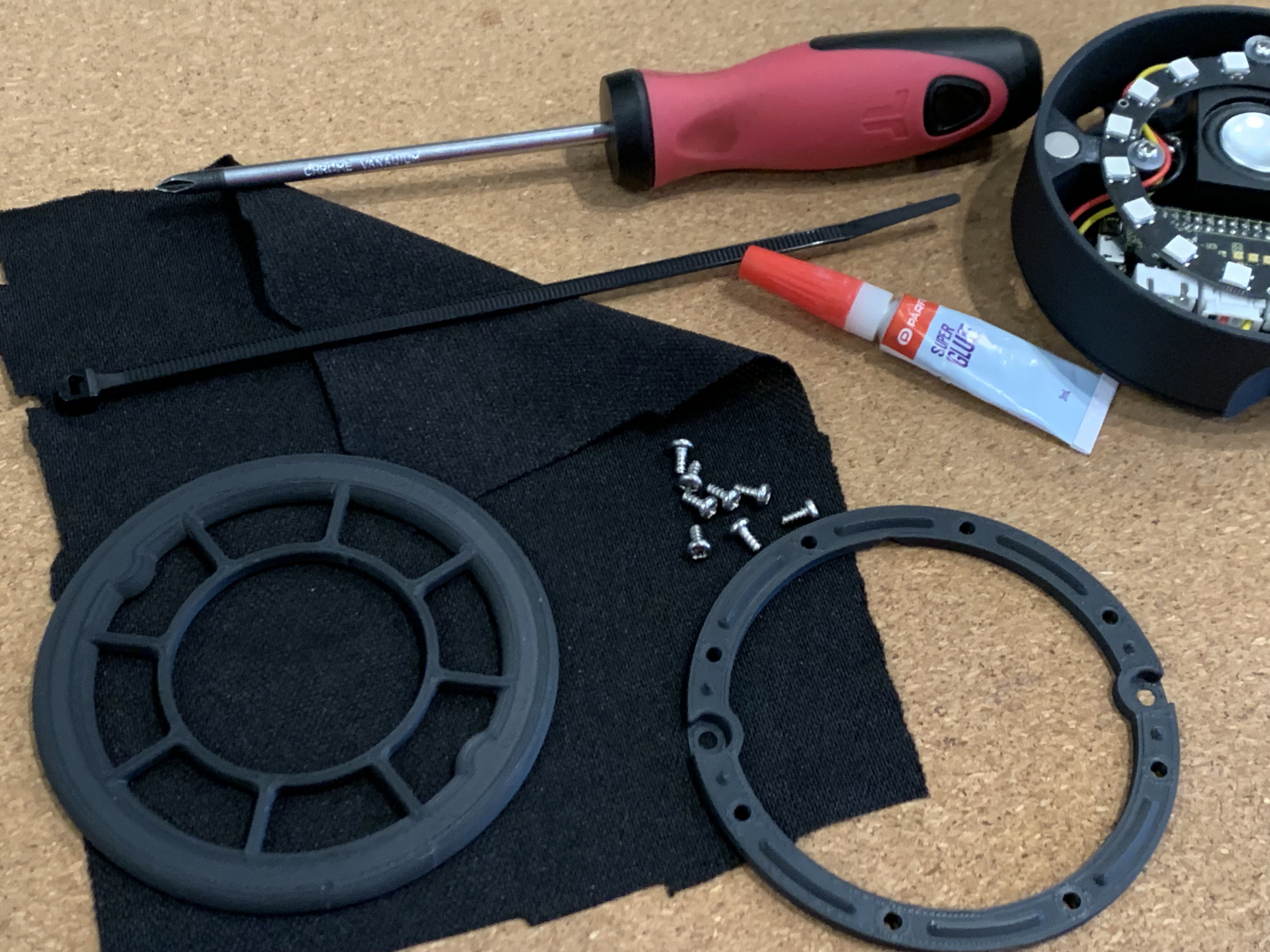

    Prepare the speaker grille
    First, assemble everything you'll need to make the speaker grille:
    • 3d printed parts for the grille: the grille frame and clamping ring
    • A square of speaker cloth about 40cmx40cm (much larger than shown in this picture)
    • A zip-tie
    • 8x M3x6mm self-tapping plastic screws
    • 2x 8mmx3mm magnets (not shown)
    • superglue
