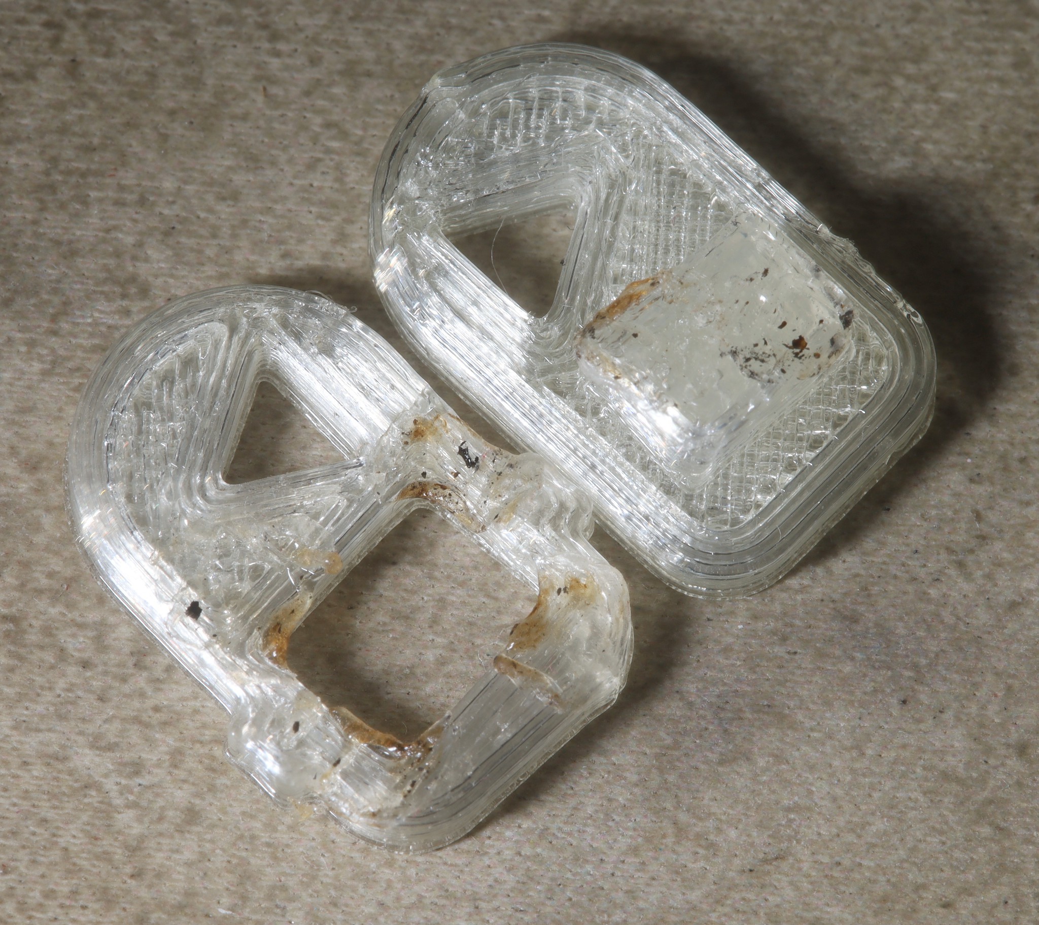

    The mane problem with the cord locks has been the slot for the string to get in.  That causes 1 direction to have half the grip of the other direction.  The string can get out of the slot as easily as it gets in.  You can remove the slot but it still grips more in 1 direction.
    The fully enclosed holes definitely are less prone to becoming undone.  Without the fully enclosed holes, the string had a path to get between the 2 panels, working its way out from the hole.  They're more practical with #18 mason line.
    Clothing farsteners need a bigger opening, but that's going to cause more chafing.
    More layers would be very time consuming to put on.    Then there's the idea of a 2nd opening which forces the string to go in the grippier way.

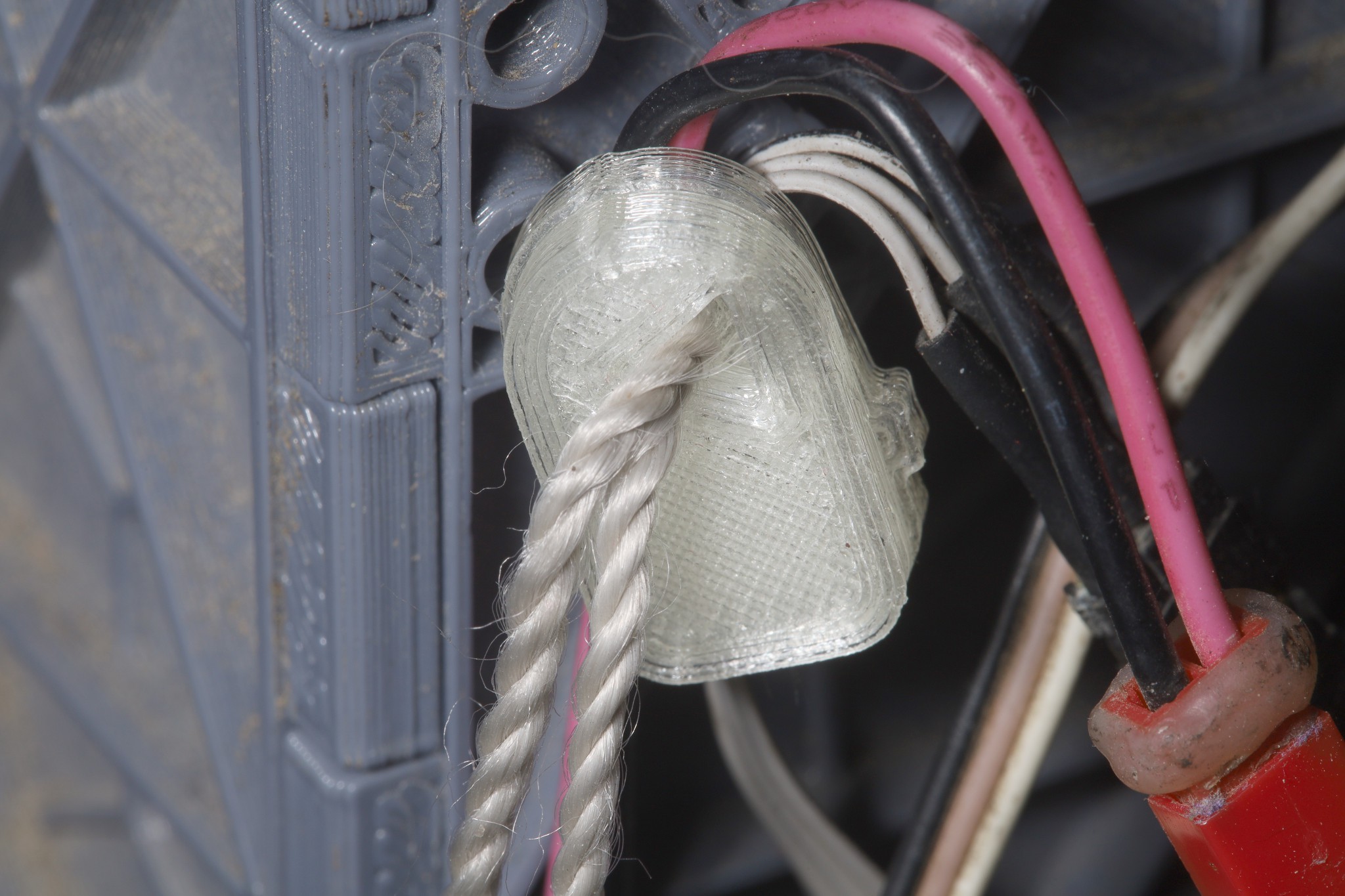

    Eventually made some PLA cord locks with this design for #18 mason line.  The expansion properties of PLA required a lot of fudging to get them to fit.
    Also made a PLA cord lock with slot openings for clothing.  A key improvement was making the button much taller.  Hard materials like PLA have decidedly gripped much better than TPU, despite their tendency to creep over time.  Their advantage is a more assertive button connection.  The 2 pieces stay together more than TPU.  It's become common practice to modify the opening size with the soldering iron to get it to precisely fit.
    Narrower slots, longer slots, thicker stacks, & taller buttons have been big improvements.  Taller buttons seem to allow some variability in the tightness, base on how far apart the 2 pieces are.
    The last round of death stars continued to loosen in the drier, so that design seems finished.

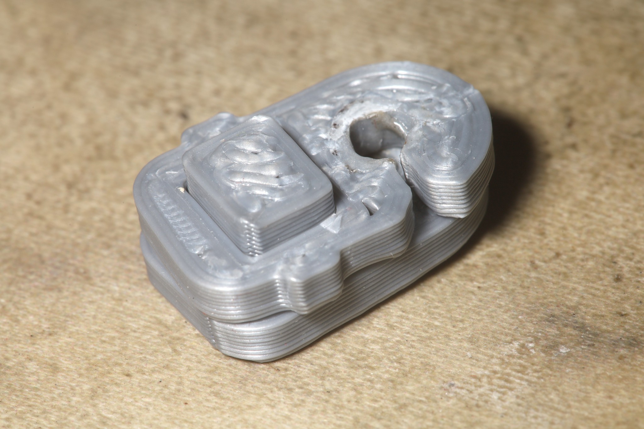

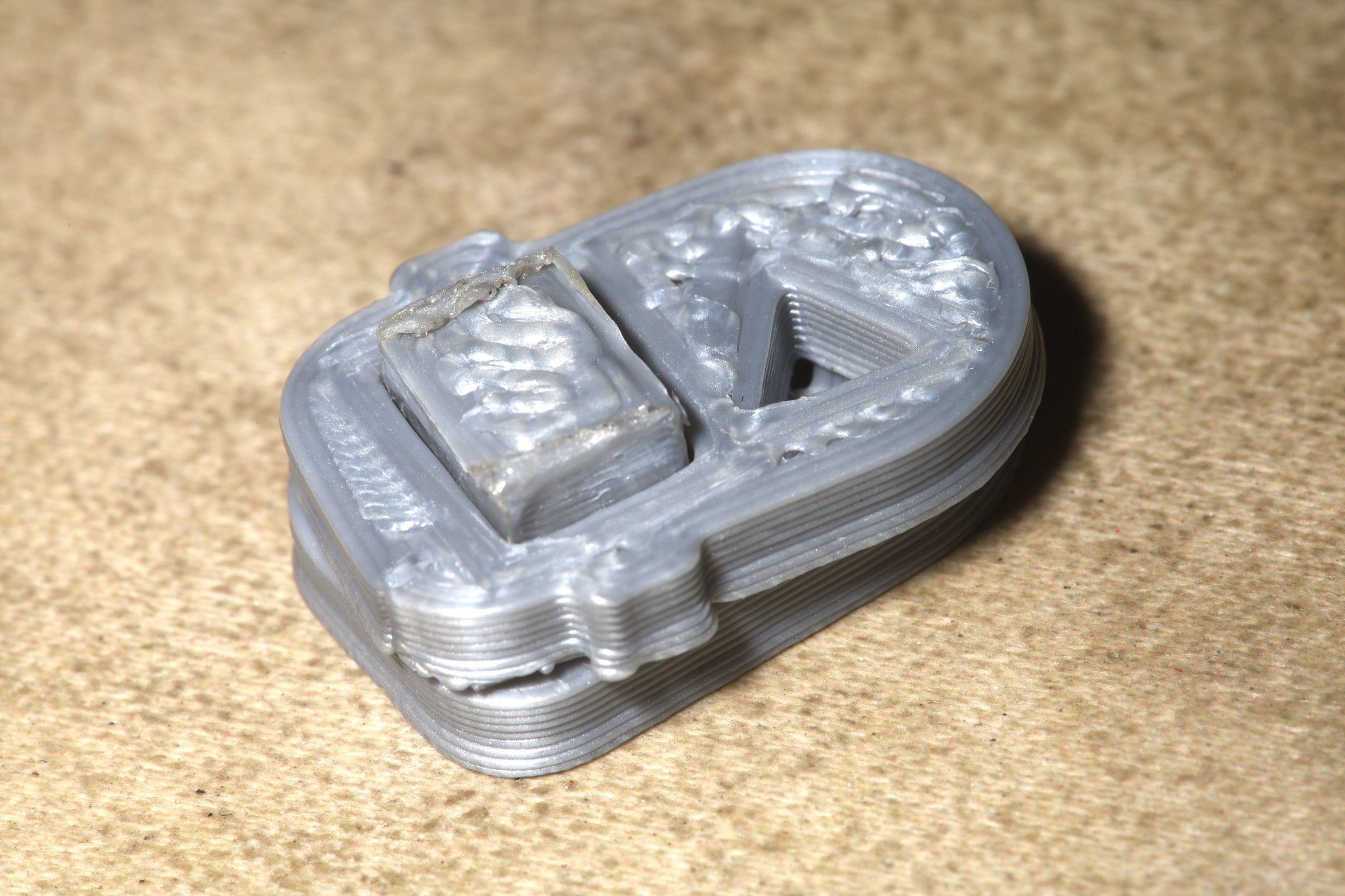

  • Melted death stars
    lion mclionhead02/11/2025 at 06:03 0 comments
    PETG death stars started coming out of the drier melted.
    TPU death stars were proving more resistant to the drier, so the decision was made to try those for all clothing & weld all around the circumference.  That would solve the problem of remembering what cord lock went on what clothing.  The trick with death stars is instead of getting the inner diameter perfect, they can be welded in an offset position.

    The temporary cord lock rapidly converged on this panel thing. It's something we've no doubt seen forever in food packaging but never remembered. Despite its simplicity, it grips better than spring loaded ones. It works better if the elephant foot side faces away from the tension.
    Note: they work better when the string is pulled opposite of the opening, so this design would be best as a O with the 2 openings on the inside of the O.
    The mane problem is it doesn't manage the excess string. There could be a provision for tying 1 end off & letting the other end move. 1 end could be taped together.  When there's lots of excess string, it's traditionally been tied into a loop.
