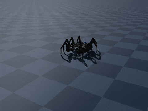

Humble beginnings - Gymnasium + StableBaselines
I started simple by exporting my robot to Mujoco XML and training it in the Gymnasium environment using StableBaselines3. This worked well enough — I got the robot to stand up, but it never truly started walking. I realized I'd need to graduate to a more capable system to get much further.
I liked to call this the drunken spider.

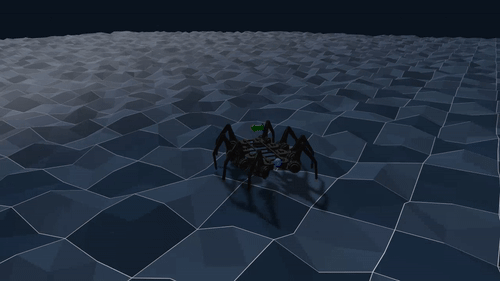

Genesis: A fresh start
Enter Genesis — a new robotics simulator with its first commit in December 2024. It boasts being cross-platform, 100% Python, and faster than any other simulator around. After a few days getting familiar with it, within a week, my robot was not only standing up but taking its first steps!
Genesis deserves serious credit. Not only is their simulation platform outstanding, and their development team is incredibly active on GitHub. They respond to questions, fix bugs, and constantly add performance improvements to make training even faster!
Despite all this, I missed some of the IsaacLab ecosystem. Genesis is a simulator, optimized for parallel environments, not a training ecosystem. IsaacLab, on the other hand, provides a library of composable blocks that abstract away the implementation details, leaving just the important bit.
Genesis Forge was born
Taking inspiration from IsaacLab, I started building a series of reusable building blocks for Genesis environments and named this framework Genesis Forge. It has become an end-to-end system for creating robotic training environments in the Genesis simulator, with all the boilerplate handled for you. You can focus on what matters, while keeping your code clean and easy to understand.
