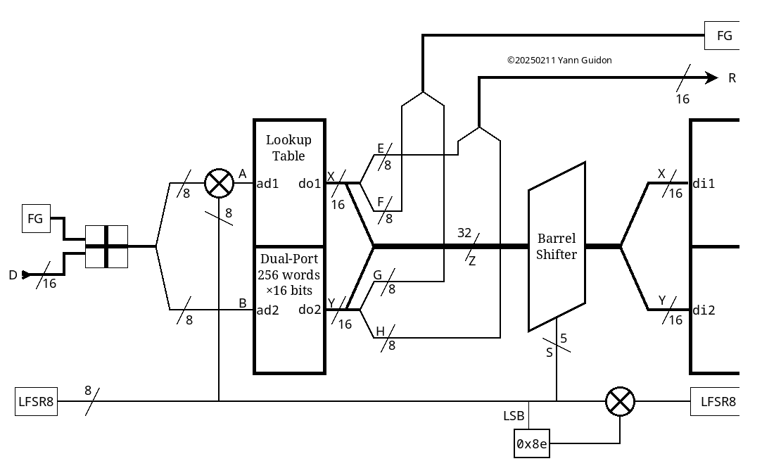

So here is the new version:
It can recover from low entropy, working as a PRNG when D is fixed, uses a 32-bit barrel shifter, a 16-bit add and two 8-bit XORs.
And when the LUT is well shuffled, this works as a good scrambler.
You can't say it's complex:
uint16_t LUT16[256];
uint16_t FG;
uint8_t LFSR8=1;
uint16_t Scramble_round(uint16_t D) {
  uint8_t S=LFSR8;
  LFSR8 >>= 1;
  if (S & 1)
    LFSR8 ^= 0x8e; // Poly can be 0x: e7 f3 a6 b2 8e b8 b1 c6
  uint16_t C = D + FG;
  uint8_t A = C ^ S;
  uint8_t B = C >> 8;
  uint16_t X = LUT16[A];
  uint16_t Y = LUT16[B];
  uint16_t R = (X & 0x00FF)
             | (Y & 0xFF00);
  FG =  (X & 0xFF00)
      | (Y & 0x00FF);
  uint32_t Z = X | (Y << 16);
  Z = (Z >> (S&31)) | (Z << ((-S)& 31));
  Y = Z >> 16;
  LUT16[A] = Z;
  LUT16[B] = Y;
  return R;
