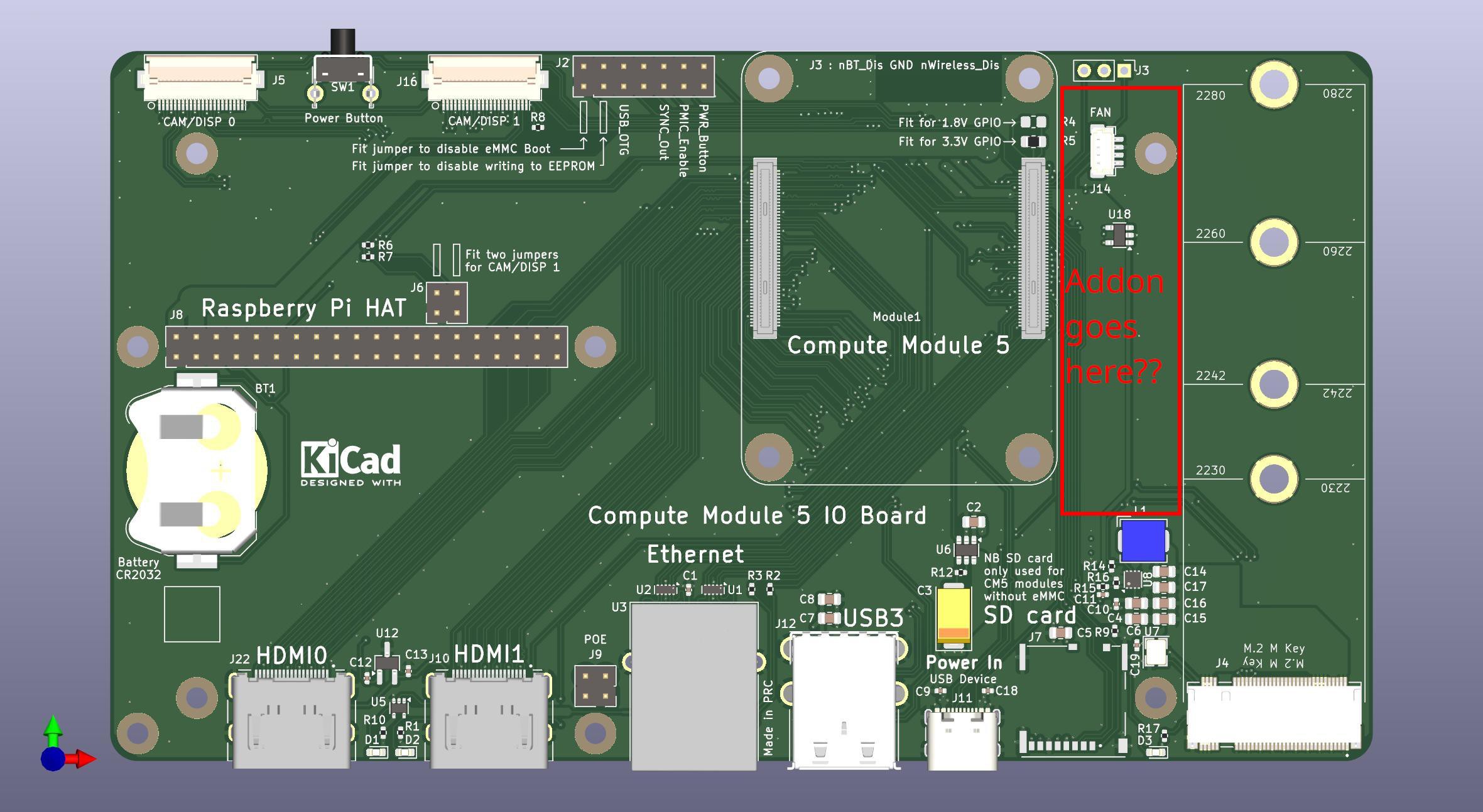

To ensure mechanical compatibility with other addon hardware and the Compute Module 5 IO Case, it's necessary to determine where would be a suitable location for installation so that upper limits on the PCB size can be set. To this effect, I've had my eye on this particular spot on the IO board, in between the M.2 Socket and the Compute Module:
Fan halt addon location
3D render of Compute Module 5 IO board highlighting potential location for the fan halt addon board
This location seems fairly ideal as it's a fairly empty patch of board, with only two conflicting components to work around, it includes one of the IO Boards mounting holes, which could also be used to attach the addon, and it's right next to (well, encompasses) the normal fan header, which help keeps the length of loose wires needed to a minimum when plugging things in.
The downside is that this strip is still fairly narrow, limiting the overall board width to about 15mm to avoid conflicting with the adjacent sockets, which could make it challenging to try and fit everything on the PCB neatly. On the other hand, maybe the extra challenge will make designing the board a bit more 'interesting'? Is 'interesting' a good or a bad thing here?
