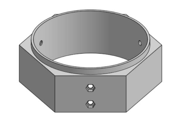

Bubbler Lid Rim.stl
Bottom part of the lid for the bubbler. This rim is sealed to the pipe to create a mounting point for the lid's top.

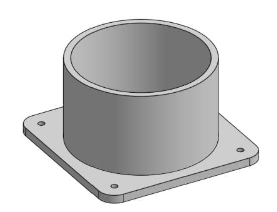

Bubbler Base.stl
Base of the bubbler, meant to cap and seal the bottom of the pipe.

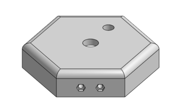

Bubbler Lid Cap.stl
Top part of the lid for the bubbler. This lid seals to the rim with the draw latches.

    Cut the 3" pipe to length, approximately 18". This can be made taller if you want a higher water column for your reaction. The printed base will slide onto one side of the tube, and the lid rim will slide onto the other.
    Before assembling the water column, apply a thin layer of silicone to the entirety of the inside of the pieces. This will help seal the plastic, as the 3D prints will not be sufficiently watertight on their own.
    Once the layer of silicone is applied, run a thick bead to rim of each print, where the edge of the pipe will sit. Due to the length of the pipe, it will be difficult to apply additional silicone to the base once the pipe is set in, so you want to make sure there is enough to completely seal the base.
    The lid of the top for the water column should also be sealed on the inside area. Once that is done, allow the silicone to cure and then fill the water column and let it sit to check for leaks.
  • 3
    Insert O-Ring
    The O-ring will be put around the lid's rim, on the small lip the top will sit on. The O-ring should fit snugly, and will sit between the two printed pieces.
