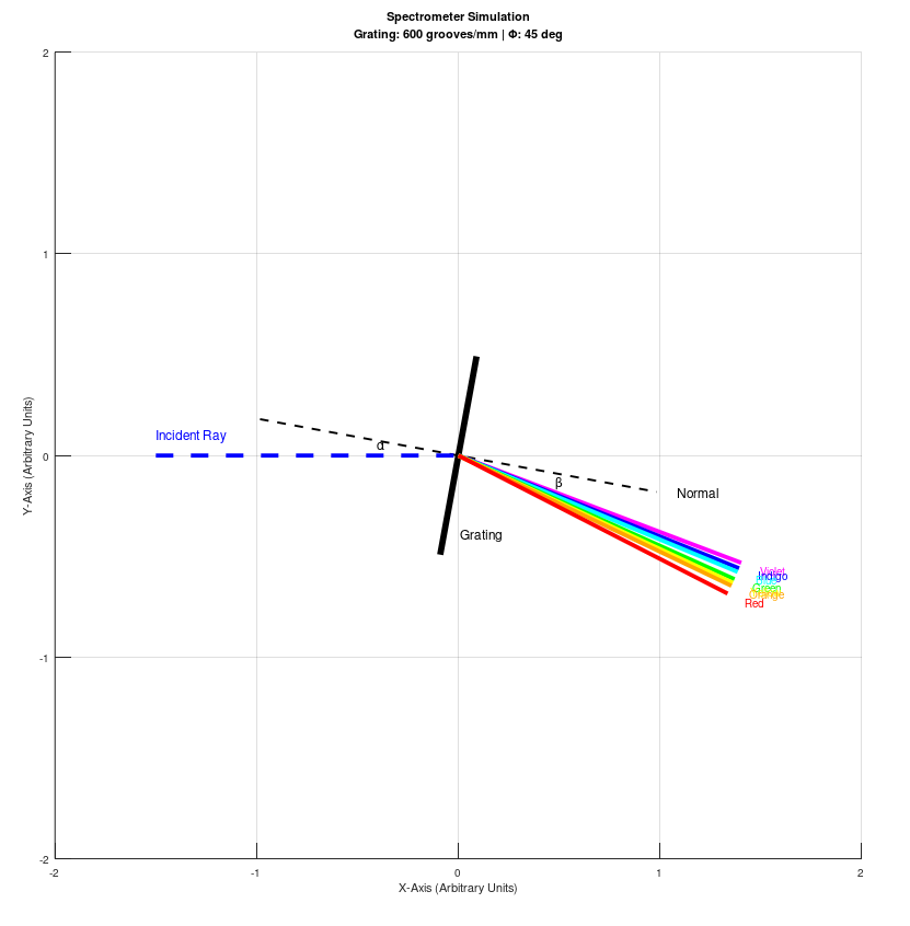

In our previous blog post, we detailed the fundamental geometry of our spectrometer, where the angles of incidence (α) and diffraction (β) are derived from a single geometric parameter, Φ. To bring this theory to life, we've created an Octave script that visually simulates how a diffraction grating splits light into its constituent colors based on this very principle. This script serves as a powerful educational tool to understand the physics at play.
The core of this simulation lies in the equations we derived:
Our script uses these formulas to calculate the diffracted angles for a range of wavelengths across the visible spectrum (VIBGYOR). By setting a fixed value for and the grating's groove density, the code plots a representation of the grating, the incident light ray, and the distinct diffracted rays for each color. This approach, where a single parameter defines the geometry, is often employed in a monochromator setup where the grating rotates to select a specific wavelength.
It's important to note that while this simulation is excellent for educational purposes, our final spectrometer design employs a different strategy. Our practical design will feature a fixed angle of incidence (α), and the diffracted light will be captured by a stationary photodiode array. The choice of the detector's position is a critical design step to capture the wavelengths of interest. Therefore, while our simulator highlights the beautiful physics of a rotating grating, it is not a direct model of our final instrument.
As an example of the output of the published code, we share three example configurations demonstrating the effect of grating groove density on diffraction angle and the diffraction angle placement.
Example Configurations
Phi = 45 and grating groove density = 600 l/mm
Phi = 45 and grating groove density = 1200 l/mm
Phi = 45 and grating groove density = 1800 l/mm
We encourage you to experiment with the code by changing the value of  Φ or the Grating_Density. This will allow you to see firsthand how these parameters directly influence the angles of incidence and diffraction, and ultimately, the spectral output.
