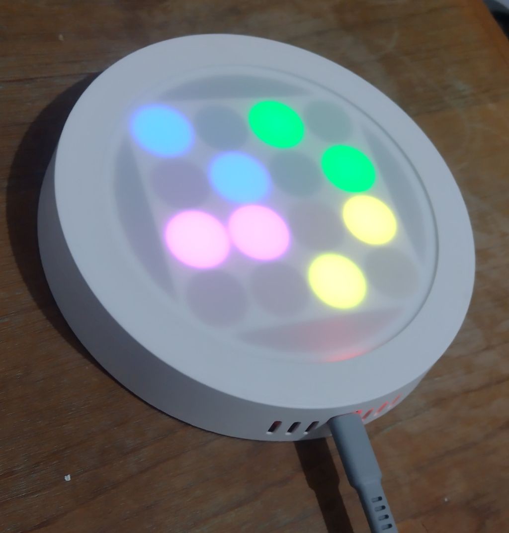

The Cistercians, a Monk order from the 13th century, created a number cypher that was able to map from 0 to 9999 using a single digit. This project implements a clock that uses a 4x4 display to show the time using a minimalist representation of the Cistercian numbers. (note: in a previous project I have used a 5x7 matrix display ) The clock can also present the time using Additional features provided are: - Ability to show the time using decimal digits. - Ability to change the display colors - Auto brightness control - Buzzer to beep every integer hour (can be turned off).

The Cistercian numbers can be represented minimalistically in a 4x4 dot matrix display, thus providing 4 digits to represent the time on a digital clock.
The Decimal numbers can also be presented on the 4x4 display and the decimal time can be displayed scrolling the digits row by row.

  • Completed!
    danjovic06/27/2025 at 03:54 0 comments
    And finally the clock is complete.

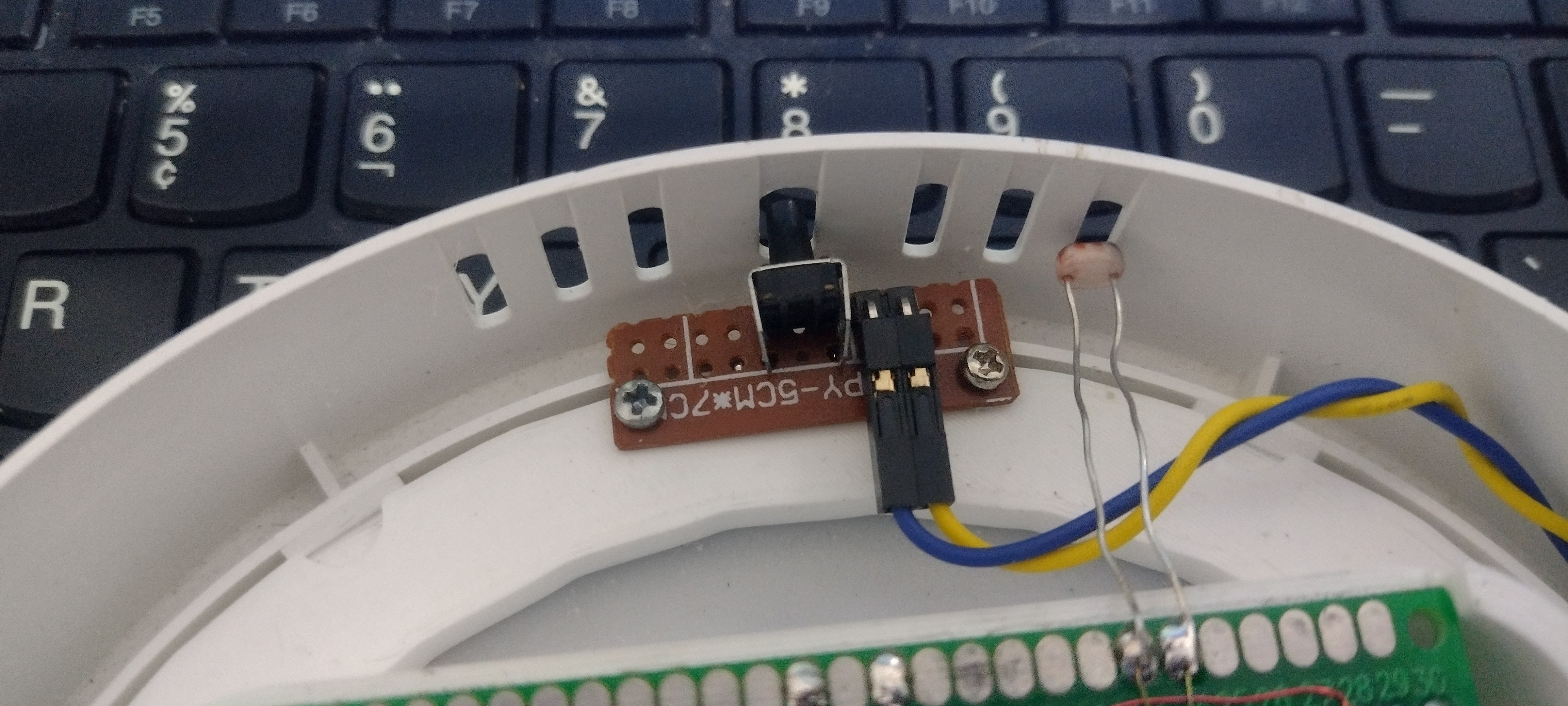

  • Assembly
    danjovic06/27/2025 at 03:36 0 comments
    The DigiSpark was mounted on the lower side of the PCB, close to the slots of the ceiling light body. It was necessary to open space for the USB cable using a rotary tool (Dremel).
    The button was installed over a small piece of perfboard on the top side of the case and it is connected to the main board using jumper wires.
    The LDR was placed in front of one of the slots on the top of the case.

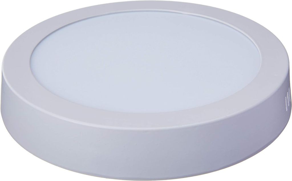

  • The Perfect Case
    danjovic06/27/2025 at 02:59 0 comments
    Found the perfect case for this project, a LED ceiling light. Cheap and beautiful.
    it measures 17cm (diameter) x 2.8cm (height)  (roughly 7" diameter x 1" tall)
