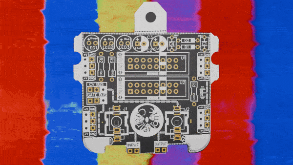

I wanted to Design good Interface for use when Playing and Designing Euro-rack and related Synth Circuits on Bread Board. When making these projects. I found out pretty quickly while prototyping that it is always useful and most of the time need more jacks. Prototyping and Combining it with The Euro-rack Power Rail system it is a pretty nice idea and addition to this series . It is quite a bit easier to use a Adaptor PCB common components with a PCB. These Can be used Interchangeability with other Styles since they were made for Breadboard Spacing. These
Features
-Breadboard Compatible
-Uses common Style Euro-rack PJ301/PJ398 (3.5mm) for a Input and Output interface with the Bread Board prototyping Synth Related Circuits.
-Jumpers for Connecting 3.5mm to the CV/Gate Bus on the Power Connector
-Small Silkscreen place to write what the type of Input/Output Jack is Labeled
-Diode Protection for Reverse Polarity
-LED for Voltage Indication for +12v rail, -12v and +5v Rail
-+12v, -12v and +5v Rail Headers for Power
-3m Built in PCB Screw mounts. So you can mount it on wooden base for a more Firm grip.
-Standard Filter Capacitors for Power rails for Synth Circuits
