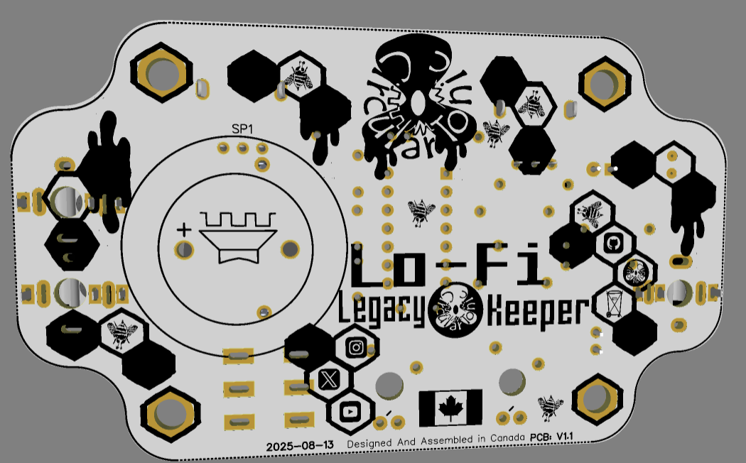

Getting The Basic Layout Down.
A project log for LO-FI Legacy Looper
An In the Pocket Voice Recorder Based of the ISD1820 Recorder IC.
neil-mundtNeil Mundt 08/14/2025 at 19:290 Comments
Been Chipping away at this PCB. Finalised the layout is pretty much done. I really liked how the layout turned out. I like to think that this combines a cross between the PatchMate: Power Transmission Chip style and that I tired to Make with my First complete Project the Atari Punk Console Semi-Patchable SynthCard
