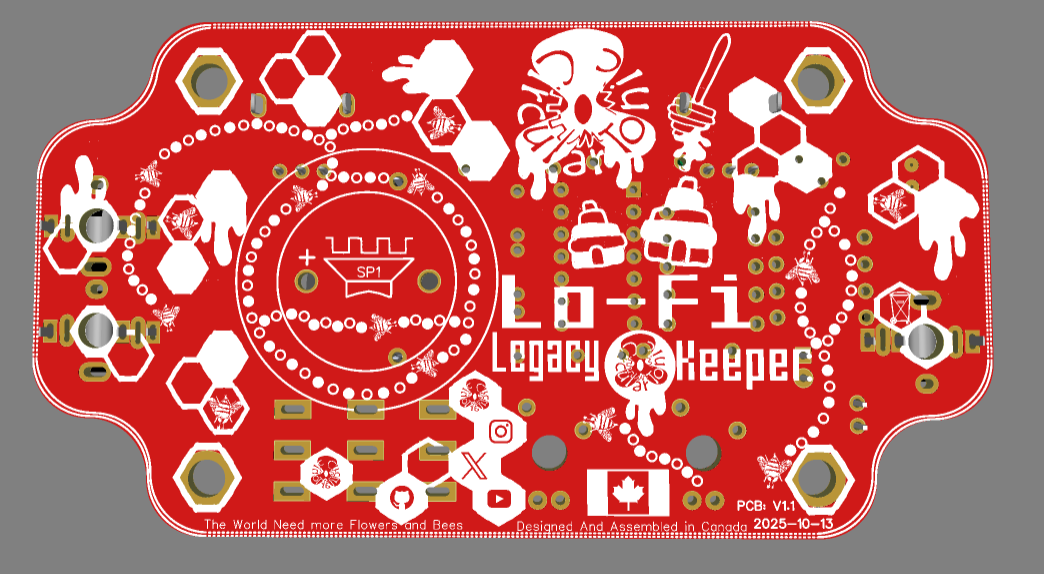

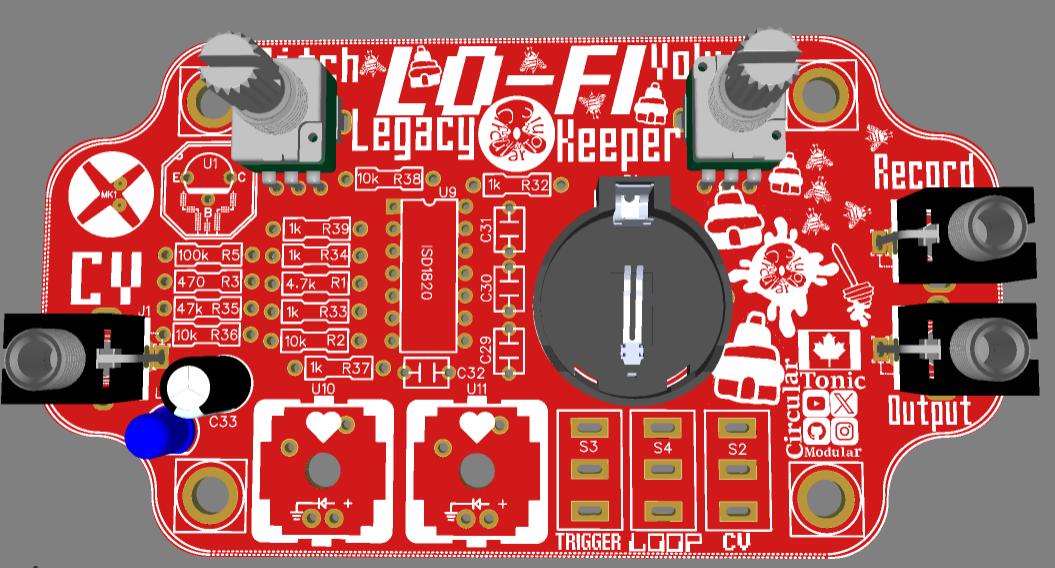

Been Messing around with the layout and tracking down a 2 x Coincell battery holder for the samplers power supply. Loving the layout so far. Rounded corners and Slightly larger then I thought it would end up, but it looks pretty nice so far.
A project log for LO-FI Legacy Looper
An In the Pocket Voice Recorder Based of the ISD1820 Recorder IC.
Been Messing around with the layout and tracking down a 2 x Coincell battery holder for the samplers power supply. Loving the layout so far. Rounded corners and Slightly larger then I thought it would end up, but it looks pretty nice so far.
Become a Hackaday.io Member
