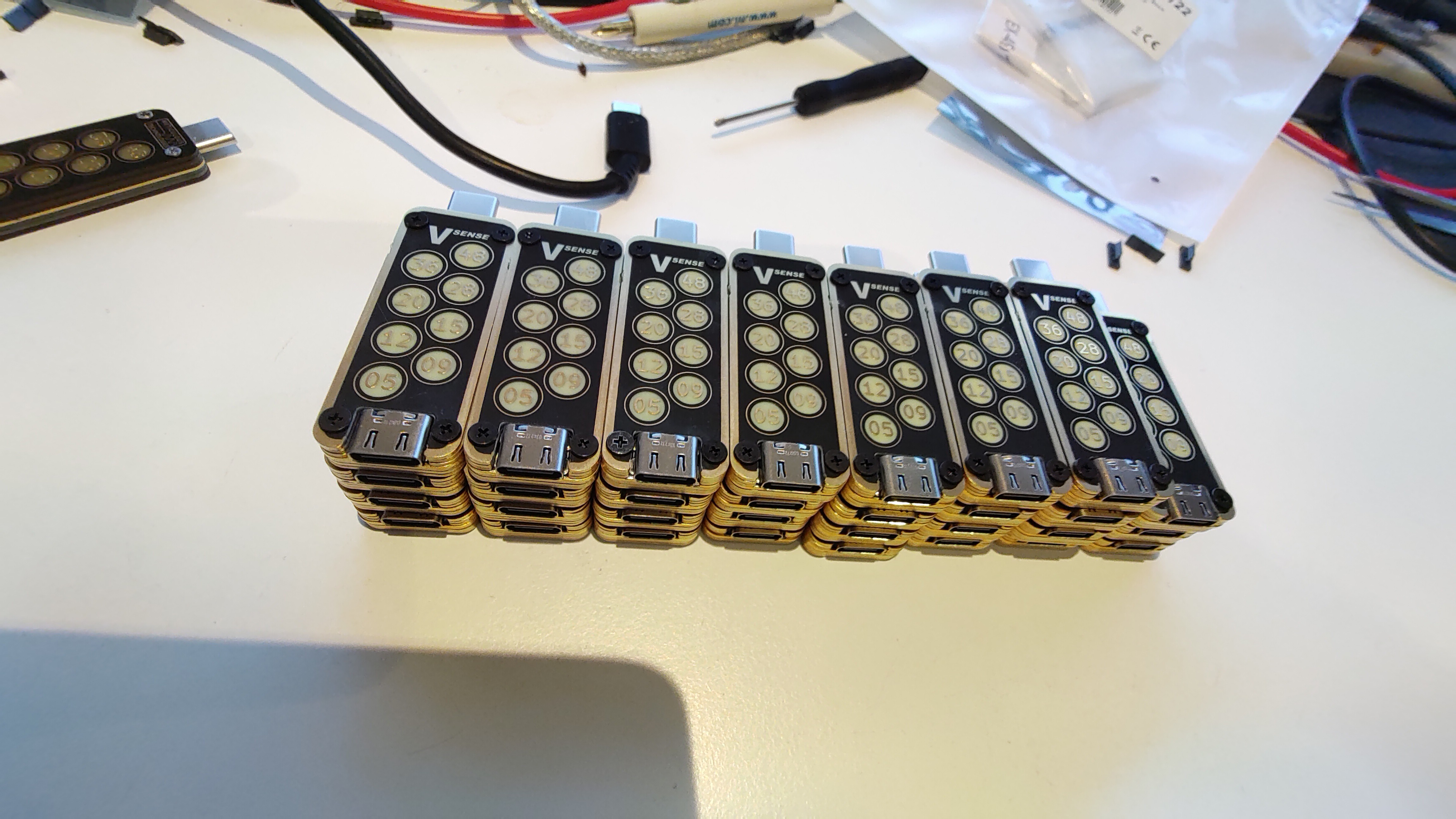

Current Status
Small production run of 32 units has been completed with satisfactory results
