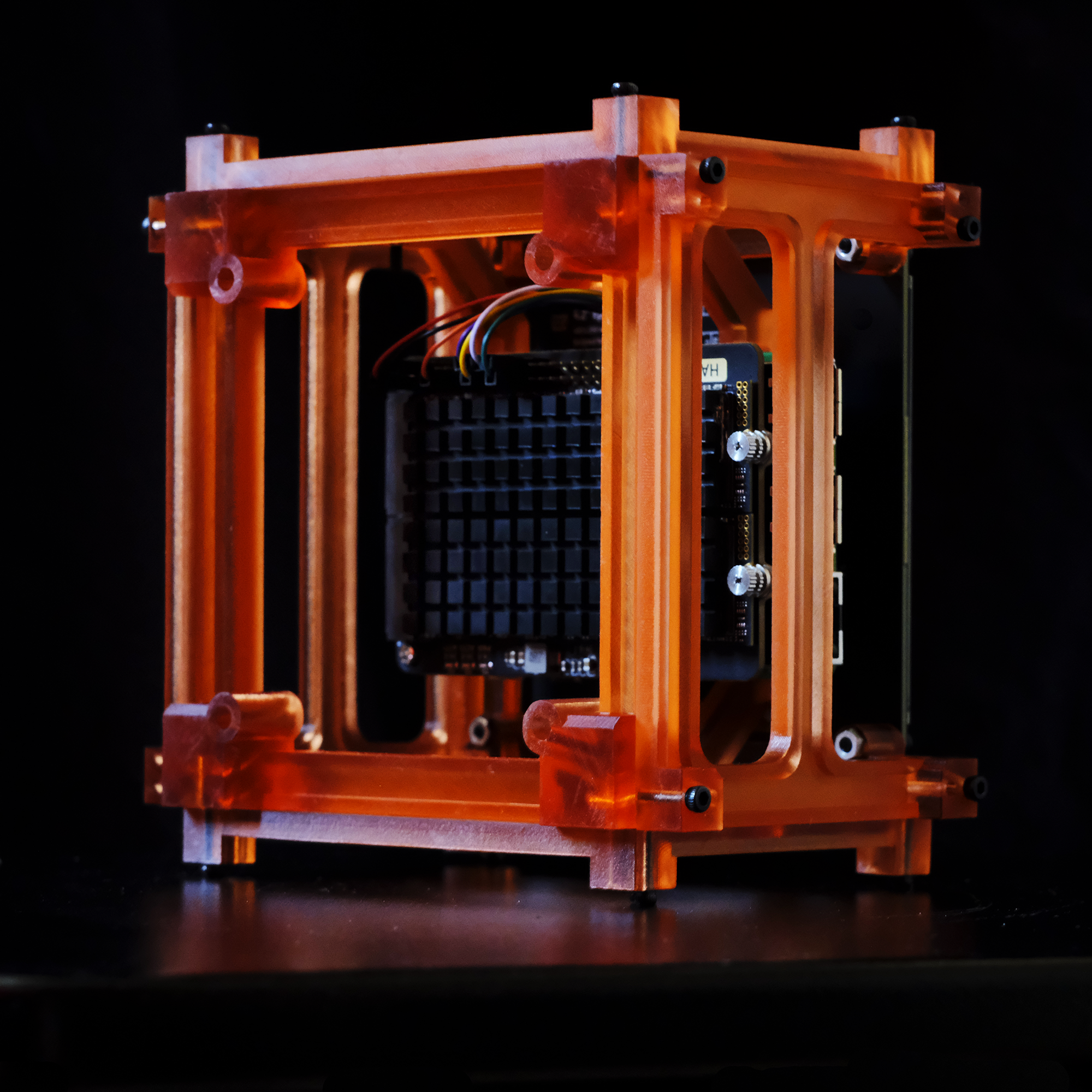

The goal of this project is to create an inexpensive and easy-to-build yet performant backup server. At its core is a passively cooled Raspberry Pi 5, paired with a Waveshare NVMe hat that supports two NVMe drives for fast and reliable storage. A front-mounted WeActStudio e-paper screen displays essential stats like storage usage, CPU load, temperature, and the timing of the last backups.
While the software is still a work in progress, I plan to develop a playbook for automatic deployment and implement time-locked immutable backups on one of the drives. Currently, the code for the e-paper screen is complete, and the custom enclosure parts have been 3D-printed in UTR thermal resin by PCBWay. I’ve relied on their fast and precise printing services for a while now since I prefer to avoid resin printing at home, and having their professional lab handle it has been a huge help for past projects.
Thermal resin is ideal for this application, as it’s resistant to temperatures of up to 100°C and has a higher life span than other resins. During testing, the maximum temperature I measured during backups was around 60°C, well within the resin’s limits. Plus, the aesthetic lends itself perfectly to the futuristic look. If resin isn’t your thing, no worries—the design is also compatible with FDM printing, and the files below work with a wide range of materials.

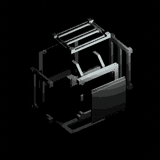

Toaster assembly
The design is modular and easy to assemble, with an open layout that makes swapping adapters and components simple. I've always striven for simplicity in my projects to make them accessible and easy to build upon. Stay tuned for updates as I continue refining the software.
