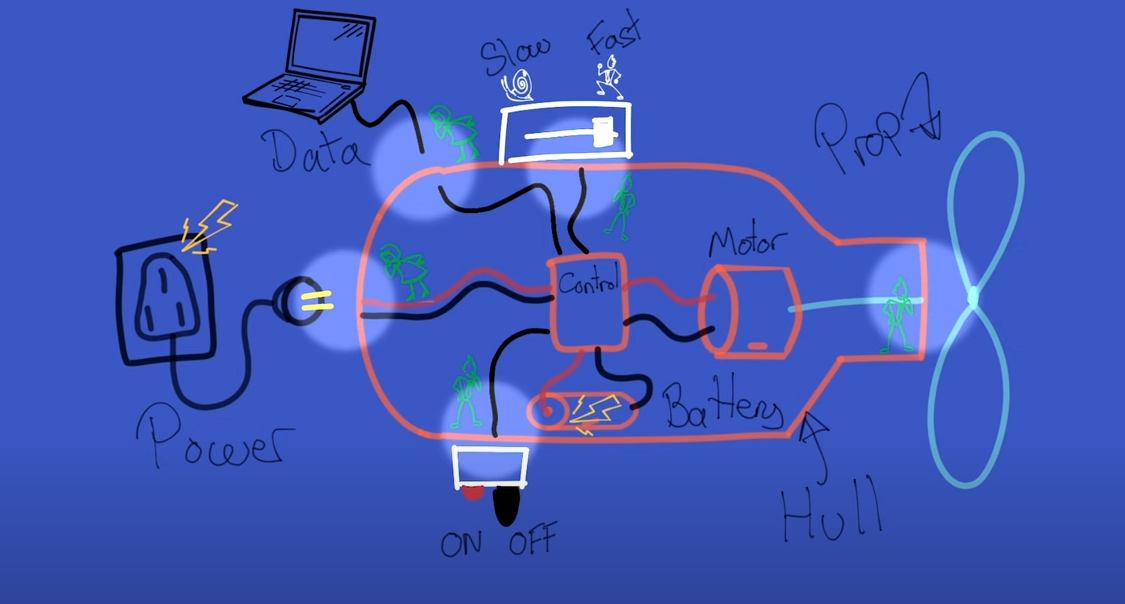

The two main design constraints are:
Sea scooter design constraints
Video summarising the two key design constraints
  • The body of the sea scooter must be printable in one go as a single 3d print.
    • How on earth can the electronics, batteries and drive system be added during the printing process?
  • The body must be water proof and hermetically sealed with no holes for  a motor shaft or cable connectors.
    • How can I get power and control signals into and out of a system that has no physical connection to it’s outside environment and how can we drive a propeller if I cant make a hole for a shaft?
