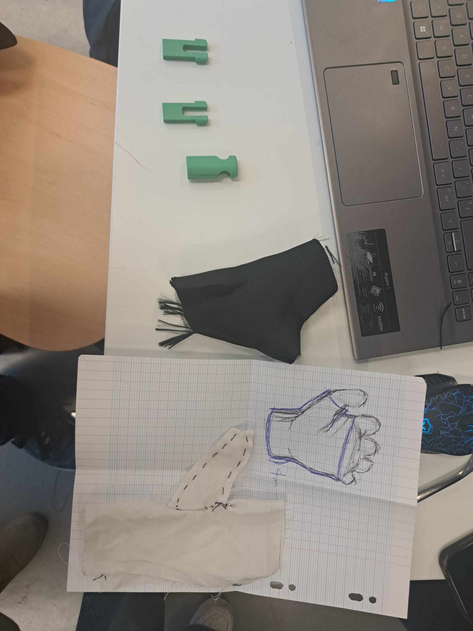

Celenn did a new prototype, a new person joined (Yeji), the snap fit Maxence did was a failure (quite heartbreaking), Inyoung and Maxence began to do a fork 3D model to test the snap fit inside fusion or the other application. The snap fit will be made bigger, will be more resistant around the edge since too thin (by making the rectangle hole inside slightly smaller), the handle is too short, the hole handle needs to be made bigger, the handle need to be empty, the bit up the handle need to be slightly smaller, overall, it broke in 3 sec. As for the sewing prototype, we finally have the right pattern. We’ll make a better prototype next week.
