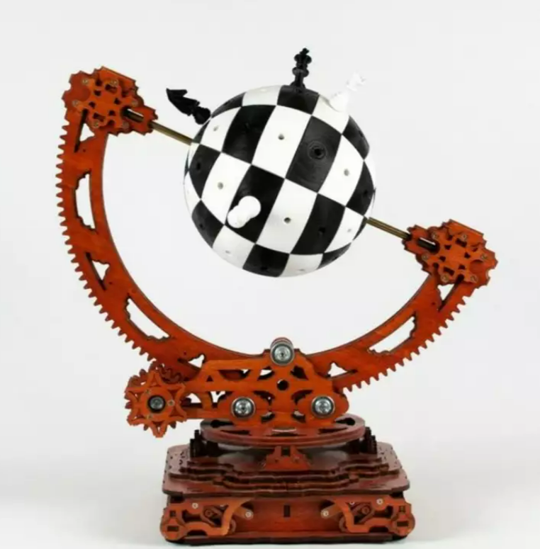

For inspiration, as mentioned in our first log, we looked at Orb Chess by NKD Puzzle :

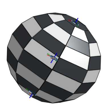

We first began modeling the spherical chessboard :
For ease of manufacturing, since the chessboard will be 3D printed, we designed it to be assembled from two identical half-domes. Since the sphere will be mounted on a threaded rod, it can be securely fastened with nuts on both sides to form the sphere when put together.

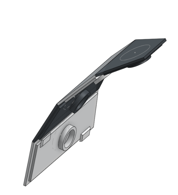

Additionally, each square of the chessboard will be inserted into designated holes on the dome, completing the playable surface.
The squares features holes on the inside for inserting magnets, allowing the pieces to stay securely attached while still being easily movable.
