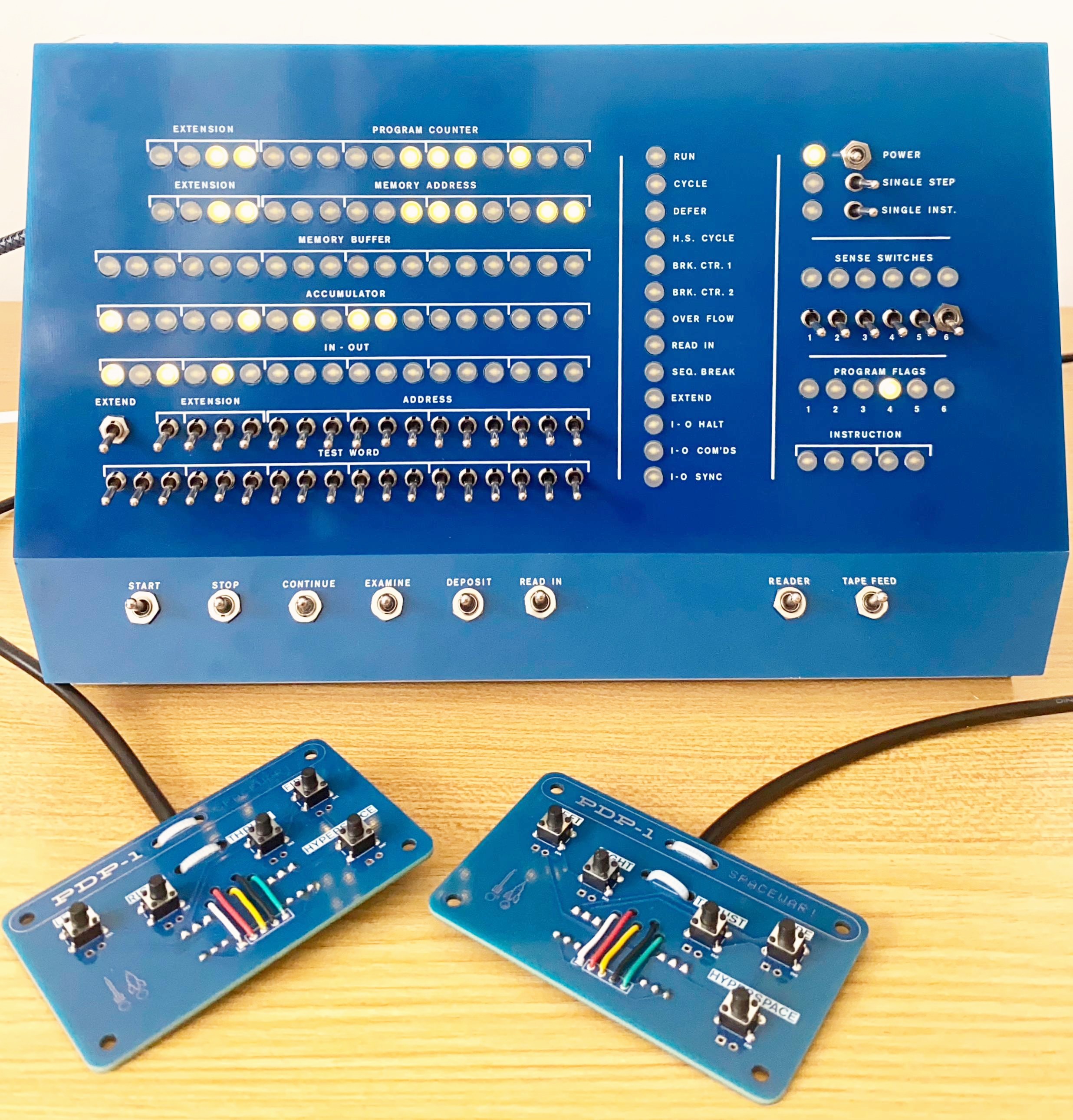

7 days ago • 0 commentsSo, we want to make the PiDP-1 a very affordable kit to make. Because, the more affordable the more chance that it will find its way to young coders who want to try their hand at PDP-1 programming!
But we're battling feature creep, we'll just have to add two spacewar controllers. The idea is to make it them tiny, low-cost PCBs that will do the job on their own, but at the same time, can be the PCB inside a proper custom-made wooden spacewar control box. As the original ones were all quite visibly one-off jobs too, a proper spacewar controller must look - artisanal.
But for those who do not like to tinker, they can use the PCB as-is:
As we had 36 extra IOs for lights or switches, we did spend the whole day thinking of other exotica to add. For instance, the three PDP-1s that made it onto Arpanet had extra button boxes - the time-sharing operating system used them to hook up multiple Teletypes.
But we decided against such things, they can all be done in software and the kit is already a package of 15 PCBs as it stands. And though PCBs are cheap, it does add up.

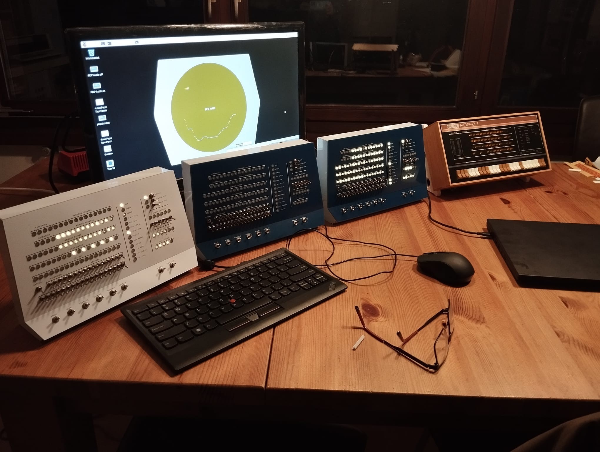

03/01/2025 at 22:13 • 0 commentsThe problem with the PDP-1 is, its looks are iconic. You have got to get it right. At the same time, we want to make this a low-cost kit, affordable for anyone. So here is the first problem:
How do you get such looks in a replica, for a low cost?
The second problem is of our own making. PDP-1s came in various styles and colour schemes. The iconic blue one is mostly famous because that one is the only one left, at the CHM. There were blue and white front panels, rack-mounted and stand-alone front panel consoles... and between the two of us, we could not agree on the one to replicate.
Three of the many PDP-1 variants: stand-alone and rack-mounted, white and blue, various peripherals
So we spent a silly amount of time discussing options. And decided we'd make them all. As in, we'll make a super low-cost 'stand-alone console version' and a 'rack-mounted' version that can actually be hung on a wall (as the rack depth needs to be mo more than 1.5 inches...).
Also, we'll supply both a blue and a white front panel with each kit. Make the colour choice the problem of each kit builder. The idea is you can take off the one colour panel and replace it with the other colour.
For the rack-mounted version, we opted to replicate the PDP-1 at Lawrence Livermore, because that avoids the problem of making a mechanical replica of the paper tape reader seen on the front of the middle image. Making that would break the budget. USB sticks will act as paper tapes instead...
