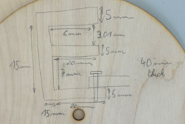

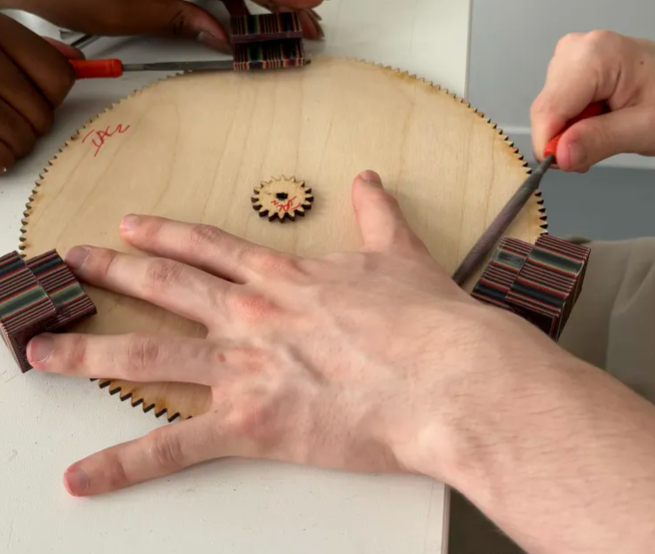

    During the first session, we printed the E-shaped blocks designed to hold the inner dial and provide structural support for the rest of the assembly. At first, everything seemed to be going well. However, we quickly ran into a problem: we had printed the blocks as solid pieces, and we hadn’t planned for any internal cavities. As a result, we had to manually drill holes into them—a task that slowed us down quite a bit.
    Then came the second issue: two of the E blocks didn’t enable the internal gears to fit and rotate properly. These gears are essential for the functioning of the entire mechanism, so we had no choice but to file the inside of the blocks down. This took a lot of time—several dozen minutes—because we had to be extremely careful not to damage the pieces or make them unusable.
    Unfortunately, our frustrations didn’t stop there. When we finally tried to insert the dial (with the numbers and clock hands) into the E structure, we realized it didn’t fit entirely. It stuck out slightly and didn’t sit properly. That moment was quite disappointing for all of us, and we ended the session feeling a bit disheartened.
    The next day, we talked to Arnaud about the issue, and he made a simple but very logical suggestion: just remake the dial slightly larger so it would align better with the structure. In hindsight, it made perfect sense—we just hadn’t thought of it ourselves in the heat of the moment.
    So in the final session, that’s exactly what we did. We redesigned the dial and even came up with a new, more realistic design for the clock hands. However, that part came with its own set of challenges. Since we didn’t know the exact dimensions the dial needed, we had to make multiple attempts before finding the right fit. Designing the hands was also tricky—we tried using online models, but most of them were either not suitable or couldn’t be directly imported into the lab’s PC application.

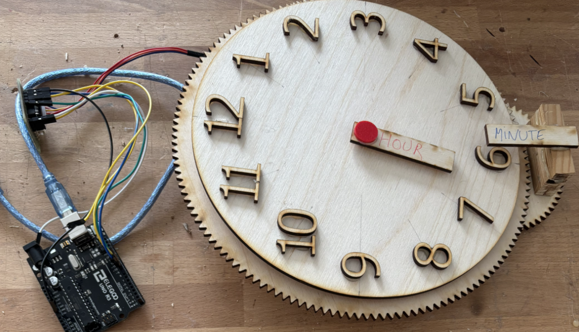

    Despite all these hurdles, we managed to get everything assembled and functioning. The final result turned out to be quite satisfying, especially considering all the difficulties we faced along the way.

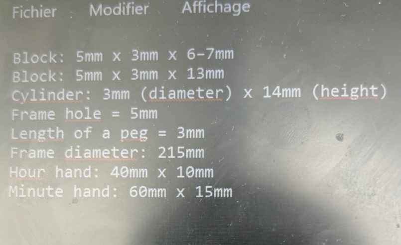

    After calculating and listing the dimensions of the different parts that would serve as axes for our various gears, we cut them out with the laser cutter. We also 3D-printed a cylinder, which would also serve as an axis, since it is not a shape that can be made with the laser cutter.
    We realized that the cut-out shapes would not make good axes for the gears that are not directly connected to the motor because they would need to have a circular shape. So, we rounded and widened the holes in the gears using a drill. Then we modeled new cylinders on Fusion with the same dimensions, but this time, we added bases to be able to fix the axes to the dial.
    We also used the laser cutter to make the numbers for the clock. We took the opportunity to remake the dial and the hands, which were lacking a hole to pass the axes through. We then glued the numbers to the dial with a hot glue gun. After that, we used it to start assembling our clock, gluing some of the gears.
    We finished the 3D printing of the cylinders with bases, then we assembled them with the rest of the structure by sanding the parts that needed resizing. We then finished the assembly of the clock by fitting all the gears as best as we could. We faced some difficulties because the clock dial obstructed our view and our movements, but we still managed to handle it. We also added pieces around the dial: a shim to keep the dial in the air at a fixed position so it wouldn't block the movement of the gears, and the support for the minute hand, which we had to elevate to allow it to pass over the dial.

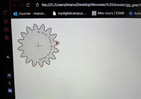

    Hi, this week we spent a lot of time thinking about the gear problem, which turned out to be more challenging than expected. The main issue was that the gears couldn’t rotate properly unless they were slightly elevated—otherwise, they would rotate at the same speed as the main gear, making the whole mechanism ineffective.
    To fix this, we explored several solutions using both the laser cutter and the 3D printer (which we had never used before—so it was a first for us!). We considered adding a small cylinder as a spacer and also designed wooden blocks that would perfectly match the size of the holes, helping to lift the secondary gears.
    After calculating the right dimensions, we laser-cut and 3D-printed the necessary components. Arnaud focused on producing these parts, while Carl started working on the final version of the code and laser-cut the clock numbers to improve the design.
    All our components fit together nicely, and the manual tests showed that the gears could rotate freely without slipping or locking.

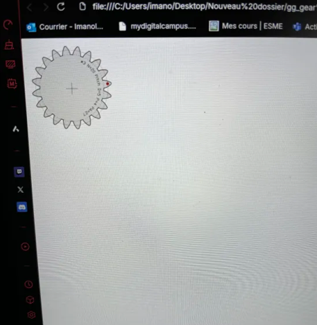

    Hello, today we made some progress on our project, but one member of our group was missing, so it was difficult to move forward quickly.
    We realized that we actually needed to add a hole in the center of our gears because there seemed to be an issue when drilling holes with a drill. So, we went to the 7th floor once again to get the gears and used the printer to cut holes in the center. After many issues (lots of crashes...), we finally managed to get the gears!
    Even though we couldn't make full progress, we identified two main problems that needed to be fixed for our project to work during the final session:
    • The gears need to sit straight on the servo motor, because if we stack gears on top of each other, the whole thing leans to one side.
    • Also, some of the internal gears need to be able to rotate, since we still don’t really know how to make the gears work properly.

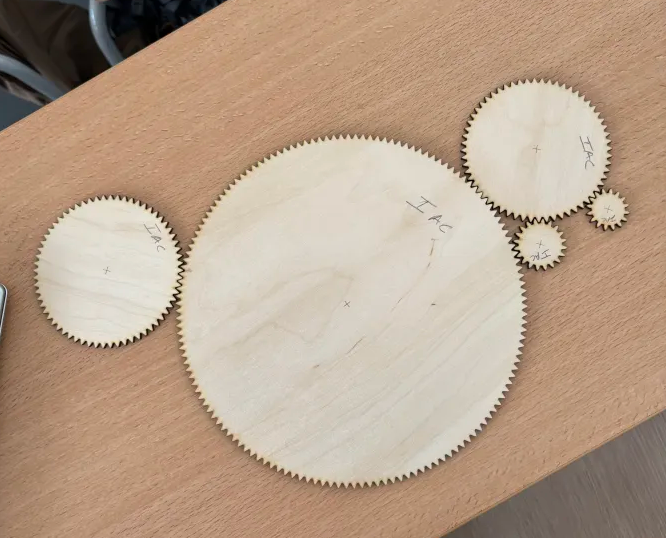

    Hi, today we dedicated the entire session to laser-cutting the shapes we had designed last week.
    To begin with, since we couldn’t retrieve our previous settings, I had to reconfigure all the laser cutter parameters from scratch. After that, we downloaded the necessary component files—though we had to pay for them, as they weren’t freely available.
    Then, we went up to the 8th floor to use the laser cutter. Cutting the gears took a while because the teacher was assisting other students, so we had to wait for our turn. However, once we got started, the process went smoothly.
    The best part is that the gears we made fit together perfectly. When we tested them manually, everything meshed well, with no jamming or misalignment—proof that our measurements and design were accurate.
    By the end of the session, we had a set of beautifully cut gears, precise and ready for assembly. It was a very satisfying outcome, especially after all the preparation that went into the design.

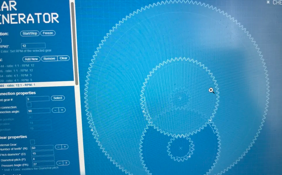

    We started this session (08/04) by telling Vladimir that we didn’t know how to design the gear mechanism for our project. He told us to start a new sketch for it and to come back to him once we had something to show.
    After going back to Vladimir to ask if our sketch was correct, he explained to us how gears work using a website called https://geargenerator.com. So, we created two diagrams on this site: one with an internal gear and another with only regular gears.
    The main problem with this was that we needed to center the gear that will be connected to the hour hand. We spent a lot of time trying to solve this centering issue. In the end, we managed to get this result:

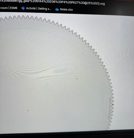

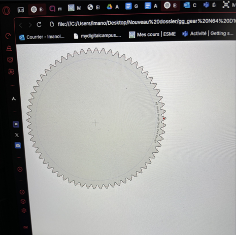

    • Gear 1 : 144 teeth, 36 cm diameter
    • Gear’s hole : 5mm x 3mm
    • Gear 2 : 60 teeth, 15 cm diameter
    • Gear’s hole : 5mm diameter
    • Gear 3 : 16 teeth, 4 cm diameter
    • Gear 4 : 20 teeth, 5 cm diameter
    • Gear 5 : 64 teeth, 16 cm diameter

    2. If you want different gear dimensions, you can use the website https://geargenerator.com.

    • Three E blocks (see over dimensions in the logs)

    • Glue Gear 1 to Gear 3, making sure the holes are aligned.
    • Do the same with Gear 4 and Gear 5.
    • Glue the Axis 2 of Gears 4 and 5 to the dial. To determine where to glue it, adjust its distance from the center of the dial using Gear 2 as a guide.
    • Glue Axis 1 to the hour hand.
    • Make two holes in the lower bar of each E block (the largest one) for the screws.
    • Do the same with Gear 1.
    • File the screws so they don’t extend past the lower bar of each E block (to avoid blocking Gear 5).
    • Screw the E blocks to Gear 1.
    • Insert Gear 1 and Gear 3, which are glued together, onto the motor.
    • Pass Axis 1 and the hour hand through the dial.
    • Pass Axis 1 through Gear 2.
    • Assemble Gear 5 to Gear 3 by passing Axis 2 (glued to the dial) through Gears 4 and 5, which are glued together.
    • Assemble Gear 2 and Gear 4, passing the dial between the central and upper bars of each E block.
    N.B. : Make sure to file the E blocks and Gear 5 if necessary.
