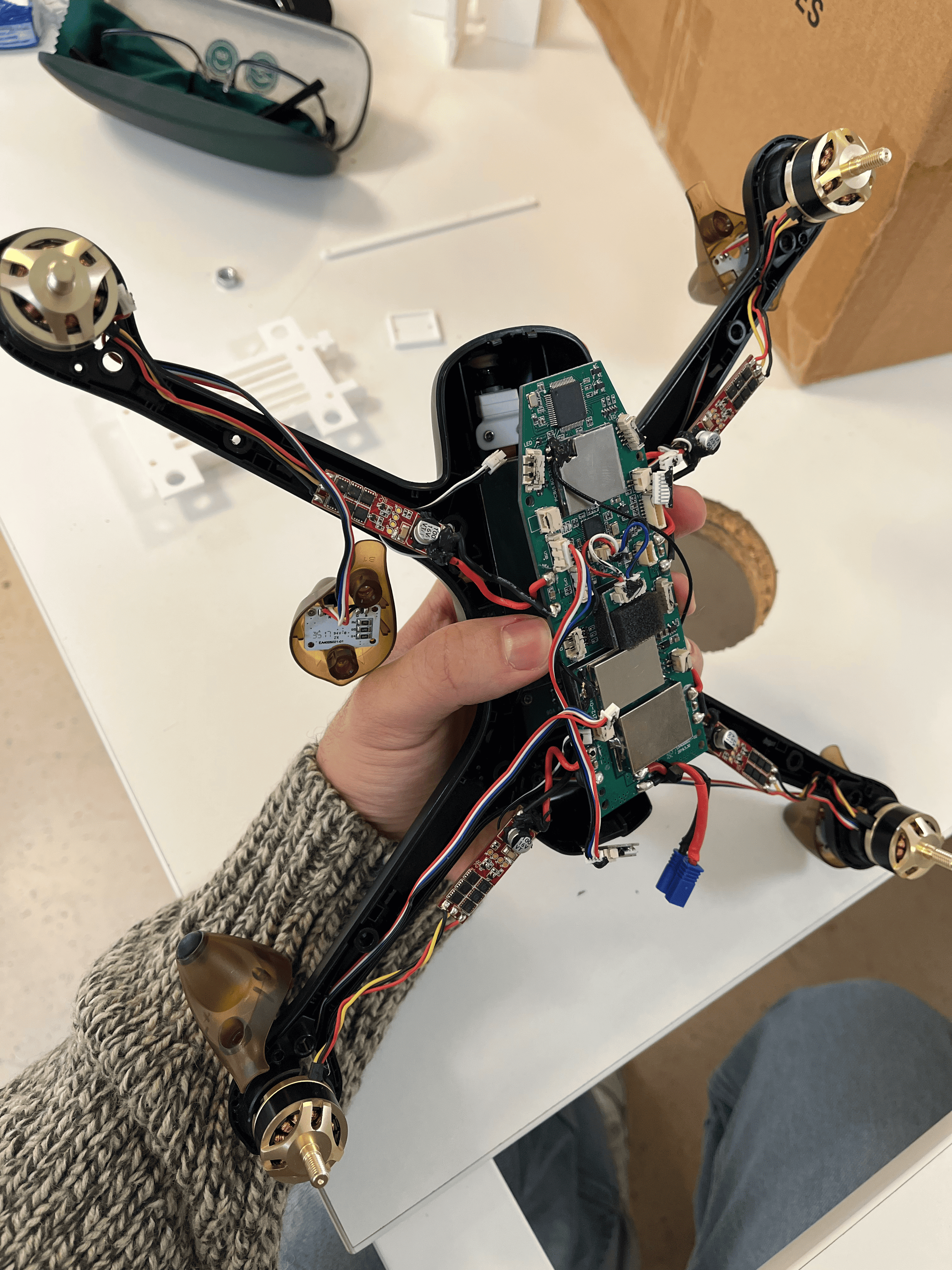

After printing all our parts, we tested the box where we plan to place our various components. However, it turned out to be a bit too small to fit everything inside. As for the gripper, we tried assembling it to check if everything fit properly, and we took all the necessary measurements to order the different screws required for assembly. However, we need to modify the main body in order to attach the gripper arm to the gear, as its current design interferes with the gripper’s movement.
Session 6 -  3D Printing
We worked on designing a part that could be attached around the drone to hold our gripper. We also completed the gripper, and both parts were 3D printed. You can see the design in the attached files.

We also opened the drone because we want to create a small opening where the camera is located, in order to move it.
