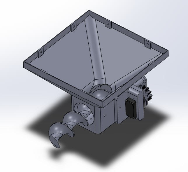

Mechanical design
Mechanical design is based on a pyramidal hopper which is dropping the kibbles on a big worm screw auger.
The worm screw is driven by a 360° RC servo and two gears.
A 360° servo allows a continuous rotation in both direction CW or CCW.
Anti jamming :
to prevent blocking the worm gear, motion is controlled in both directions by software. This will "shake" the kibbles and help them drop from the hopper into the worm gear.
To avoid blocking the worm gear in "forward motion" a rubber lip is glued into the hopper on its front side. This soft lip will absorb all the constraints and, together with the back and forth motion,  prevent any jamming. Trust me it works !
As you can see on this picture a PVC pipe is inserted around the worm gear and a slot is cut on top of it to allow kibbles to drop into the worm gear.
PVC is perfect to allow a friction less motion into the pipe. It is strong, very soft and naturally shiny (almost "oiled").

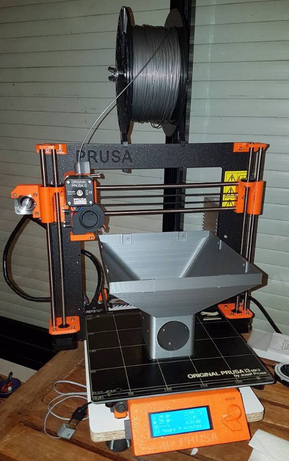

Printing the catfeeder
Most of the parts are printed with PLA filament.
The biggest one is the hopper ! It can however be printed directly on my Prusa i3 Mk2.s printer without any support.
The auger must be as strong as possible and as smooth as possible. For these...
