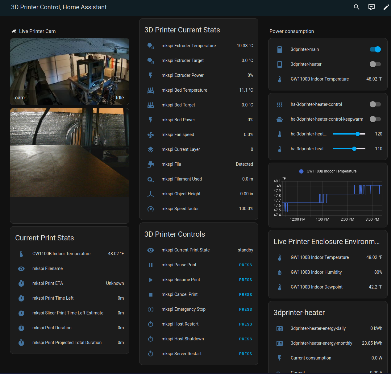

HA Dashboard
Besides the obvious Neptune sensor cards I created power control and consumption monitoring cards.
- Power control toggle switches (that are also the power meters) for each the printer and chamber heater.
- Heater-control toggle to tell it to use the automation to keep it between the set high and low temperatures.
- Keepwarm toggle to tell it to run the heater automation script to keep temp even when the printer is not printing. (I use this for pre-warming it on those very cold days).
I had to utilize the Utility Meter helpers to calculate the KWh from the meters, but that worked like a charm! Now I can tell exactly how much power I use (and money I spend) to print each component.
HA Automations
I created settable Helpers to set the high and low temperatures for those scripts (those slider bars). I then used the HA GUI to create a couple automation scripts:
- to turn on the heater; when it dropped below temp AND (status == printing OR keepwarm == true)
- to turn off the heater; when it reached high temp

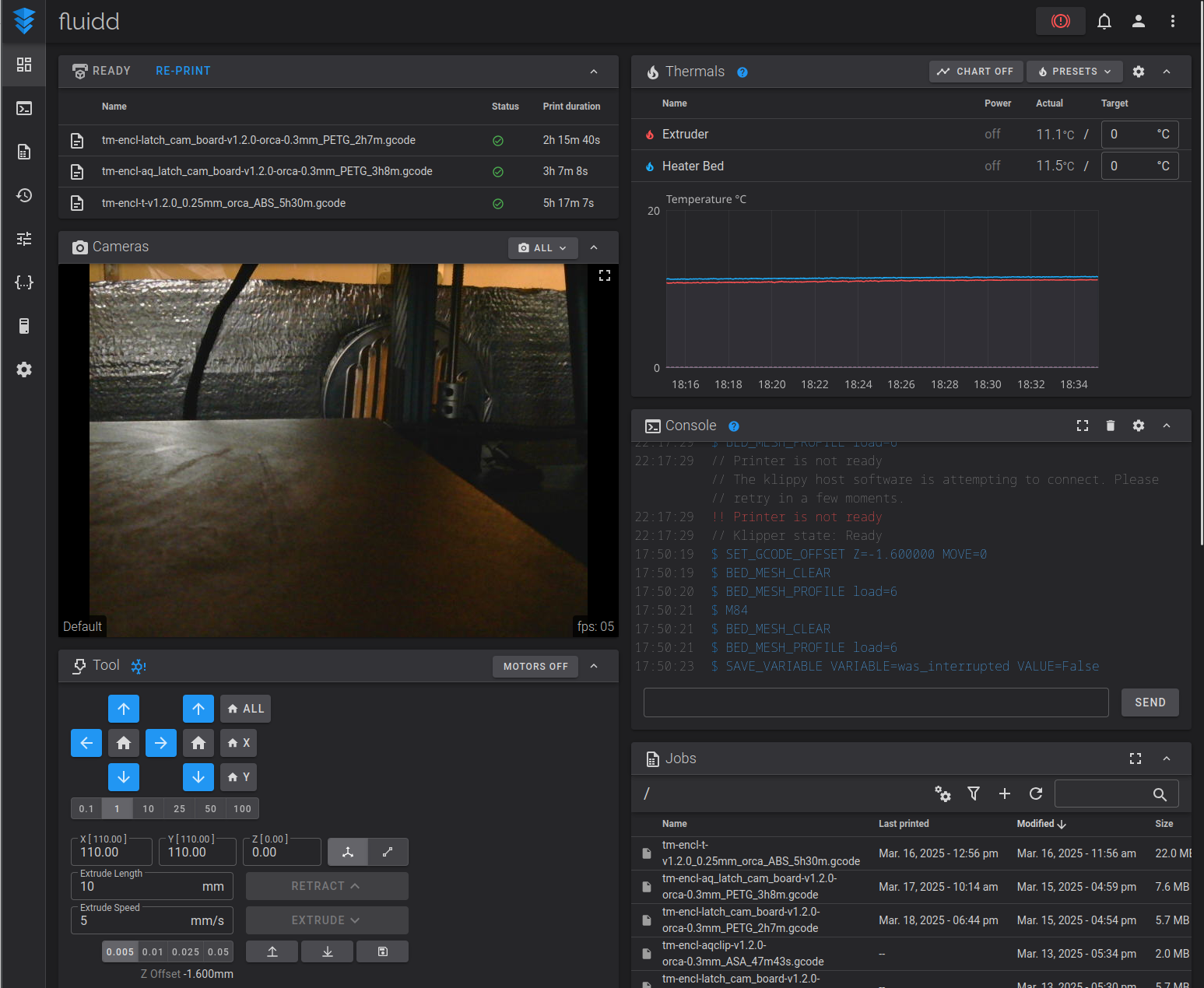

Although I use the Home Assistant dashboard primarily to monitor. When I need fine-tuned control or understanding of what's going on with the printer, I use the Klipper fluidd dashboard. I will typically keep both windows up next to each other.
