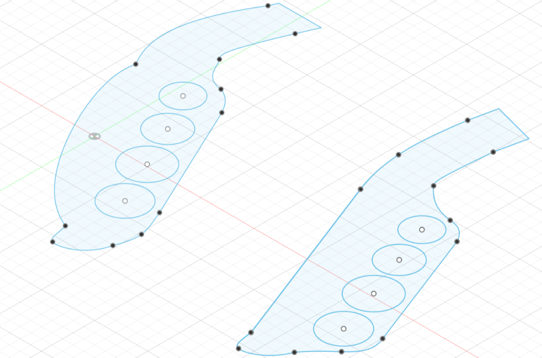

First of all, we used FUSION to do the handle : We imported the picture and put it into scale and we used 'lines' to put point and used the 'tangent' to curve the side of the handle.
We used the laser cutting to see how the handle would be. And we talked to Yousra about it. She agreed so now we need to make it into wood.

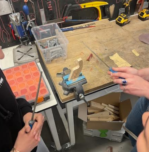

Today Yousra was supposed to be here to check our prototypes but finally she could not. So, we used this session to make those more usable. So we sand the wood and sticked together the layers of paperboard.

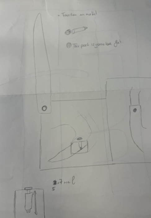

-The attachment issue -> We tried to look at different ways to attach the blade to the handle and came up with a possible solution : a metal tourillon to have a flat surface and a good support at the same time.

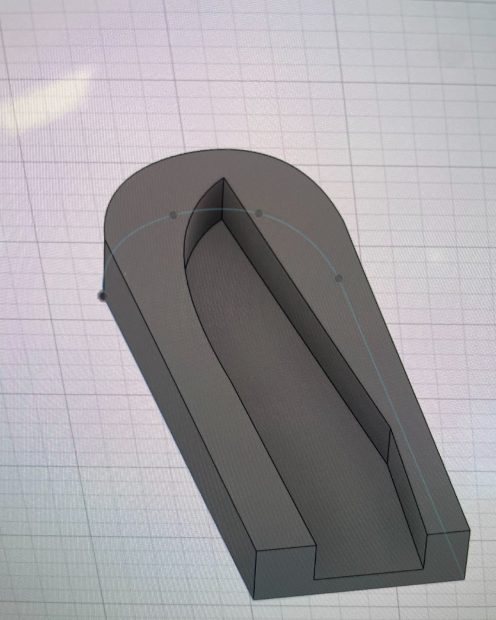

-The cover ( making the inside of the cover more round to make it cleanable or making the inside fit perfectly the blade) -> We started to modelize on fusion some prototypes as well as making a cardboard version. We still have to work on this part by taking into account the cleanability, practicity and aesthetic.

    Today we have received the prototypes of the cover in 3D printing. They fit with the magnets, so we need now to print it in black as Yousra want. Then we have to print in layering the two handles. Indeed,  we have found nails to fit holes in the handle to fix it with the blade. So the final result will be two knifes.

    Today we finished the modeling of two prototypes for the cover of the handle to print it in 3D printing. Then we found solutions for the handles : we are going to do layering. And to fix the handle with the blade we are going to use a rivet.

    Today we worked on the cover of the blade. So we ended up with two versions. Then we searched a way to put together the blade to the handle. We are thinking about a trunnion. We also sent a video to Yousra about our progress.

    Today Yousra could not come, so we perfected the handle in wood by sanding it.
    Also, we put together the layers of paperboard of the two prototypes that we have done with laser cut.
