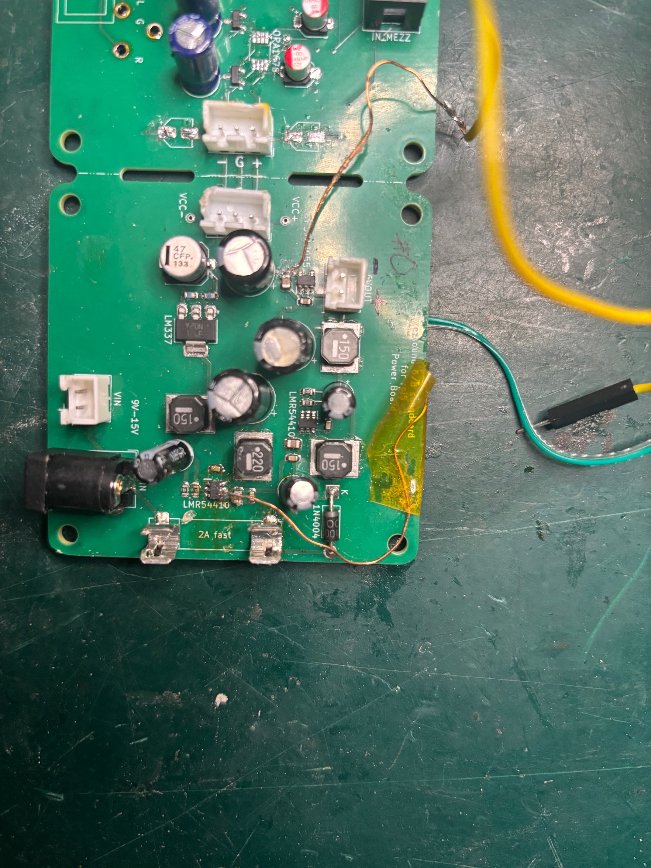

    After checking my design files, I realised that the files I sent to PCBWay actually had this flaw in them. I suspect I had made a change and did not refill the zones before exporting the files for manufacture. Lesson learned! Anyway, this was pretty easy to fix by using a scalpel to cut the piece of copper in question.
    After that, no more short circuits, but the -6V output from the switching regulator (which is then fed to an LM337 to generate VCC-) was not starting properly - it was locked at 600mV. If I shorted it to GND briefly, then everything worked fine, and I was able to validate that aside from that, the HAT was working perfectly. I've got to admit that I don't know exactly what mechanism causes this problem, but it seemed like delaying the startup of this regulator could be a potential fix. It has an EN pin that I had hardwired to the power input; if I connected it to VCC+ instead, then I figured it would start after the other supply had started.
    In order to test this, I desoldered the regulator in question, bent the EN pin up, resoldered it to the PCB, and soldered magnet wire to the EN pin. This was very fiddly and took me a couple of attempts - the pins are pretty easy to break by mistake. I ended up needing to scavenge a replacement regulator from the previous prototype.  Eventually, I superglued the magnet wire to a nearby capacitor to provide a little bit of strain relief, and then taped it to prevent it snagging... you can see the result in the photo below (the superglue came off later). The a green jumper wire is connected to the magnet wire which goes to the EN pin on the LMR54410, and the yellow jumper is connected to the other magnet wire, which is connected to VCC+ (soldering that one to the MLCC was easy).
     Once I finally got it set up, I quickly learned that connecting EN directly to VCC+ wasn't going to work. A bit of delay was required to allow VCC+ to stabilise before bringing EN high. A good solution to this type of problem is a voltage supervisor IC. It simply waits until its input is above a threshold voltage for a specific amount of time, then brings its output high. In fact, the codec board already included one to keep the chip disabled until VDD is stable. I identified a part (TLV809EA46)...
