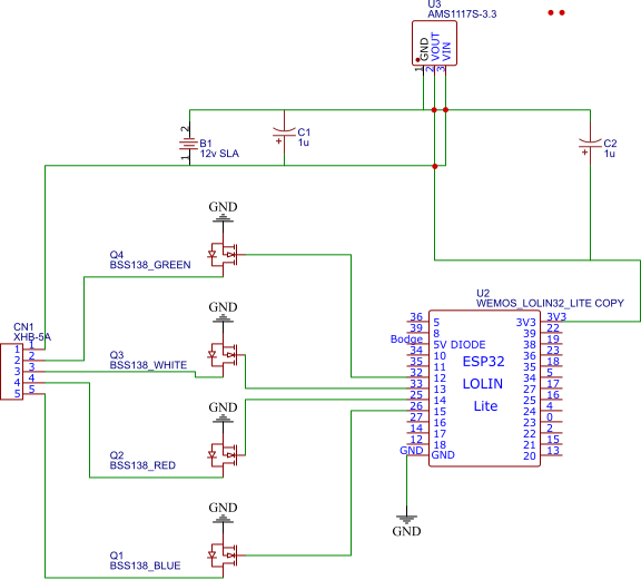

The requirements were pretty simple. I needed to provied additional lighting elements by attaching rgbLED strips to those pillars and control the leds on the columns remotely. I had worked on past project for the stage where I made this remote controlled lightup trident. All I needed to do was essentially the same setup but for six elements instead of one. I used ESPNOW on the trident and it should work fine here. So, I figured I knew this part and for the most part, I could lean on gpt to get the code I needed.
Now, I just needed to drive the leds. This would be simple enough and we could use the 12v needed to power the ESP32. A MOSFET for each color could be driven from gpio each color line goes to a drain, source to ground, gate to GPIO. Rad. Let's get the power sorted out.
For power, we need 12v with enough current to pump 16 feet of RGBW. Let's go with sealed led acid battery. --here's where I should mention budget-- that part is unclear to me. It was explained. but I'm a bit like a weak vacuum, I need to go over it a few times to pick everything up. Anyway, batteries are expensive, and trying to source SLA batteries from salvage would be time prohibited. I considered the 18650s I have from projects past. But I'm planning on gathering them all up and disposing of them. They're over 8 years old and just a house fire waiting to happen. So, I did what any asshole would do. I went to a local battery franchise and bought the 1.5 Ah SLA batteries and, at the checkout, I politely asked what their return policy is. "14 days, in like new condition" the guy responded, delivered in a tone which made clear that he understood I was essentially renting these.
So, let's prototype. The schematic in my head looked like this:
And when I breadboarded it:
--picture here--
It worked fine. The LEDs have 5 pins: 12 volts in and a ground for each color. To drive them, the color's pins are essentially 'active low'. So, a mosfet with gpio at the gates should 'open' them when the gpio is pulled high and lets the current flow, turning the LEDs (for that color) on.
