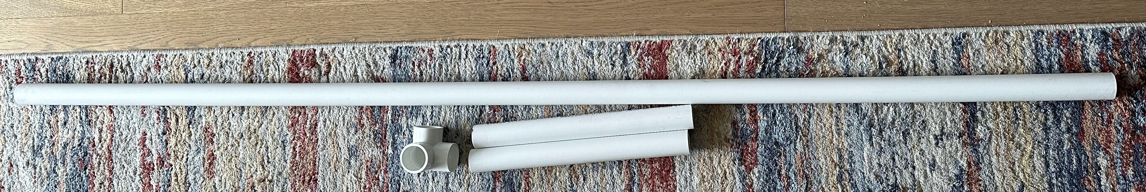

1. Cut the 1" x 10 ft pipe into the following:
  a. 1 x 5ft section
  b. 2 x 1 ft sections
2. Join the 5ft section with the 2x1ft sections using the 90 degree coupler

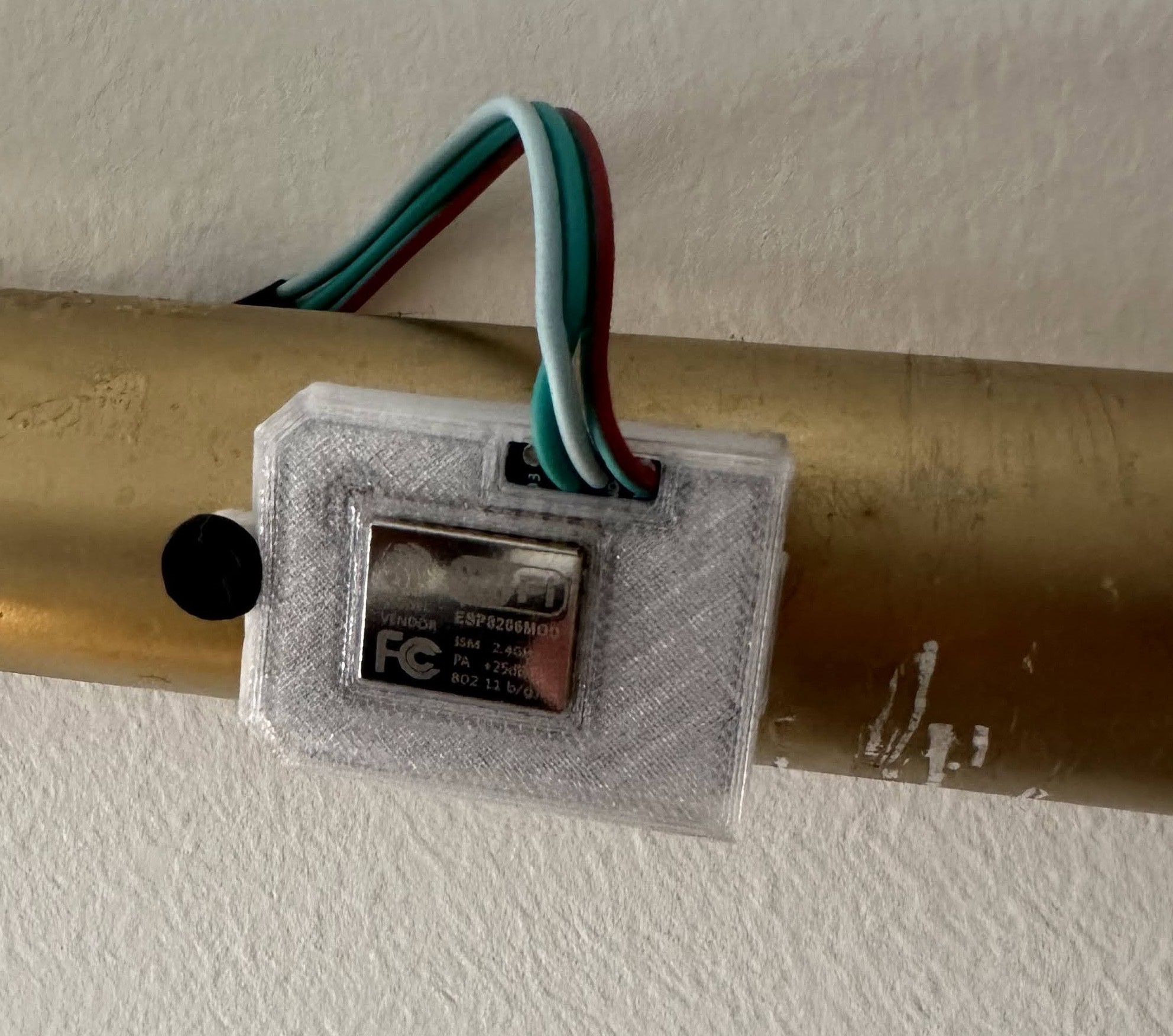

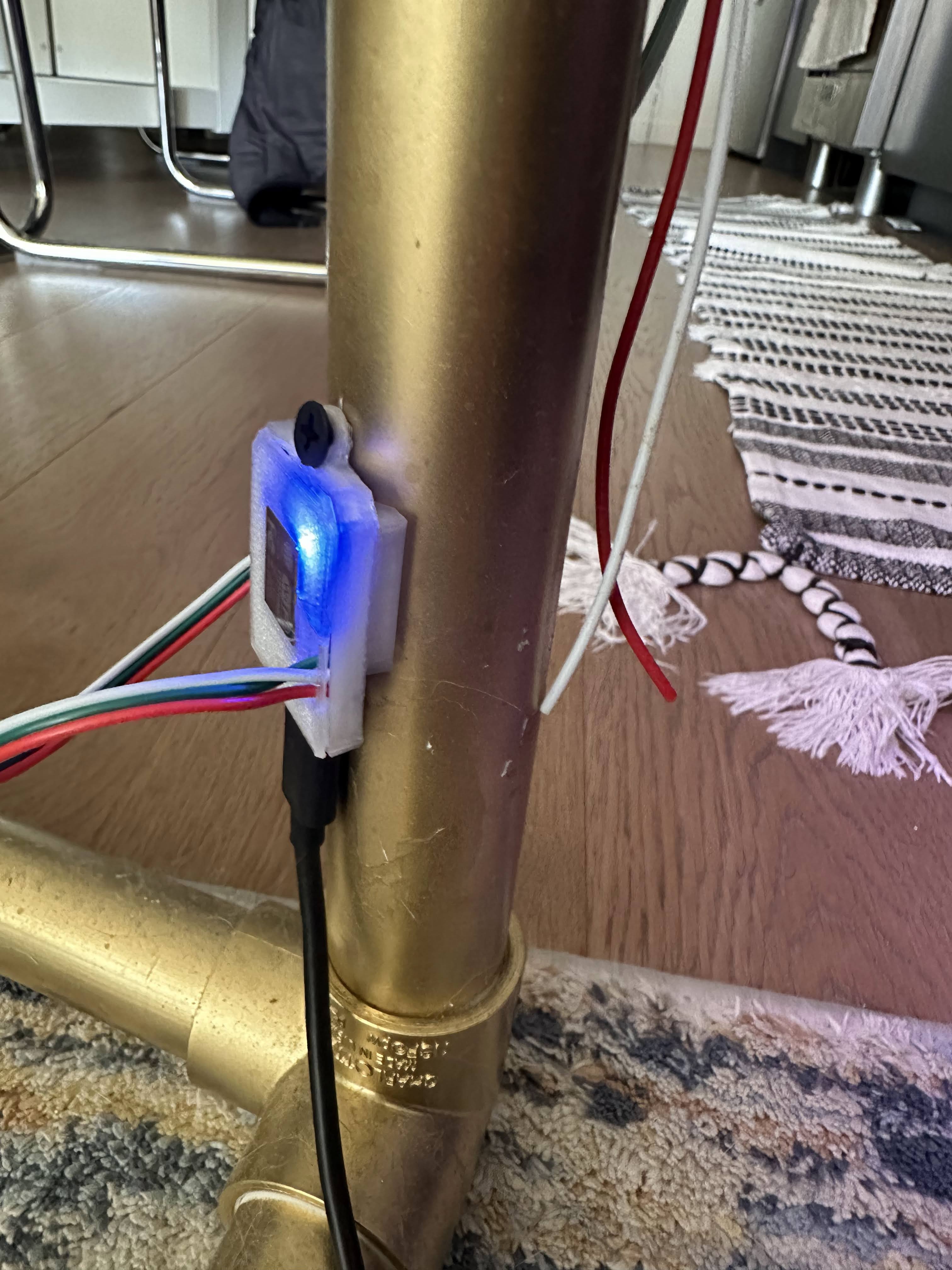

6. Solder wires onto the esp8266 and install it into the plastic housing. Note you need to attache the lid before you solder the wires.
   a. Connect Red to 5V, Green to D4, White to GND
7. use superglue to connect the shim to the main plastic
8. Drill a small pilot hole in the pole, then use a screw to attache the esp8266 to the pole

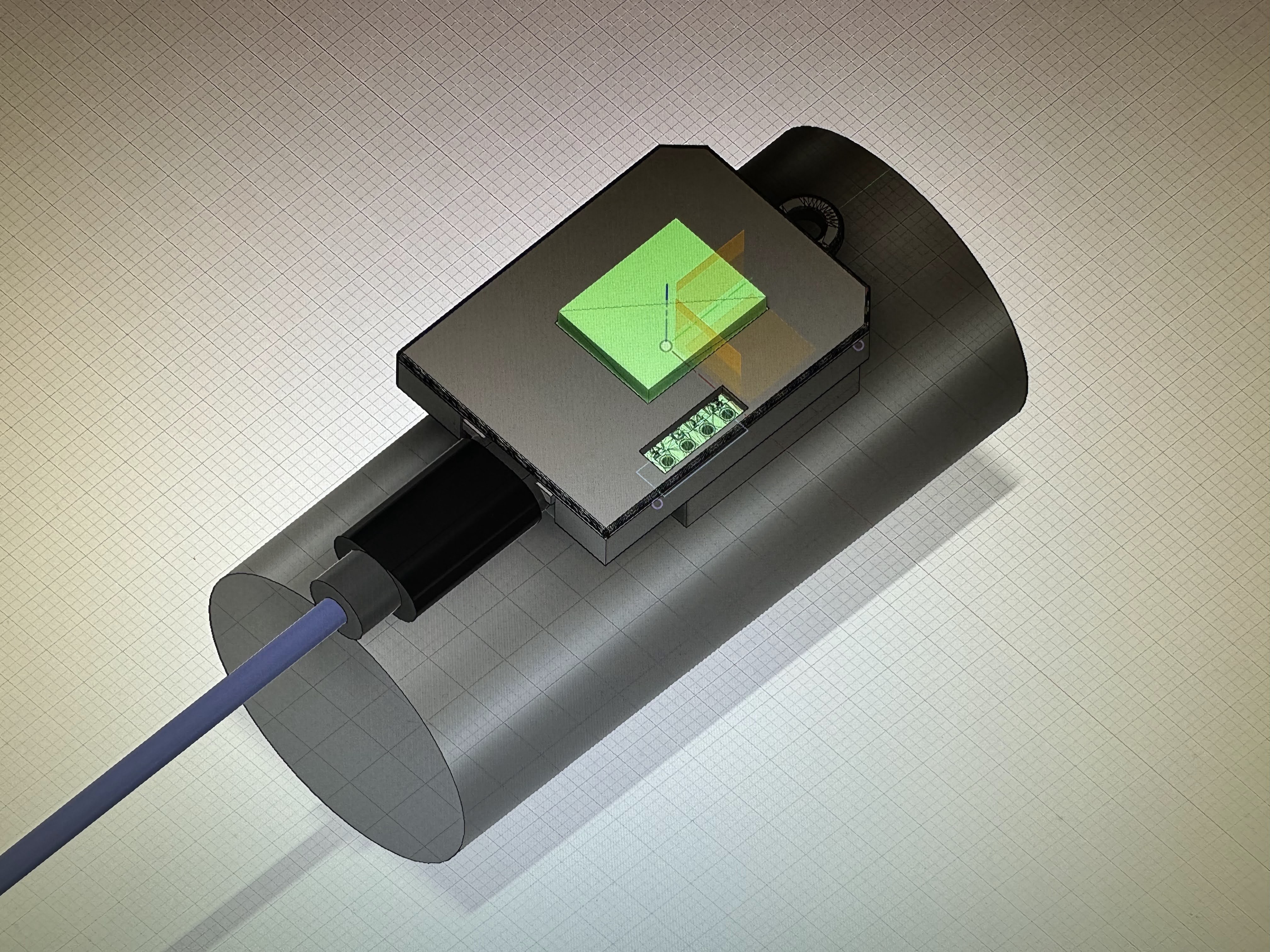

This is how the stackup should look
CAD model for reference:
