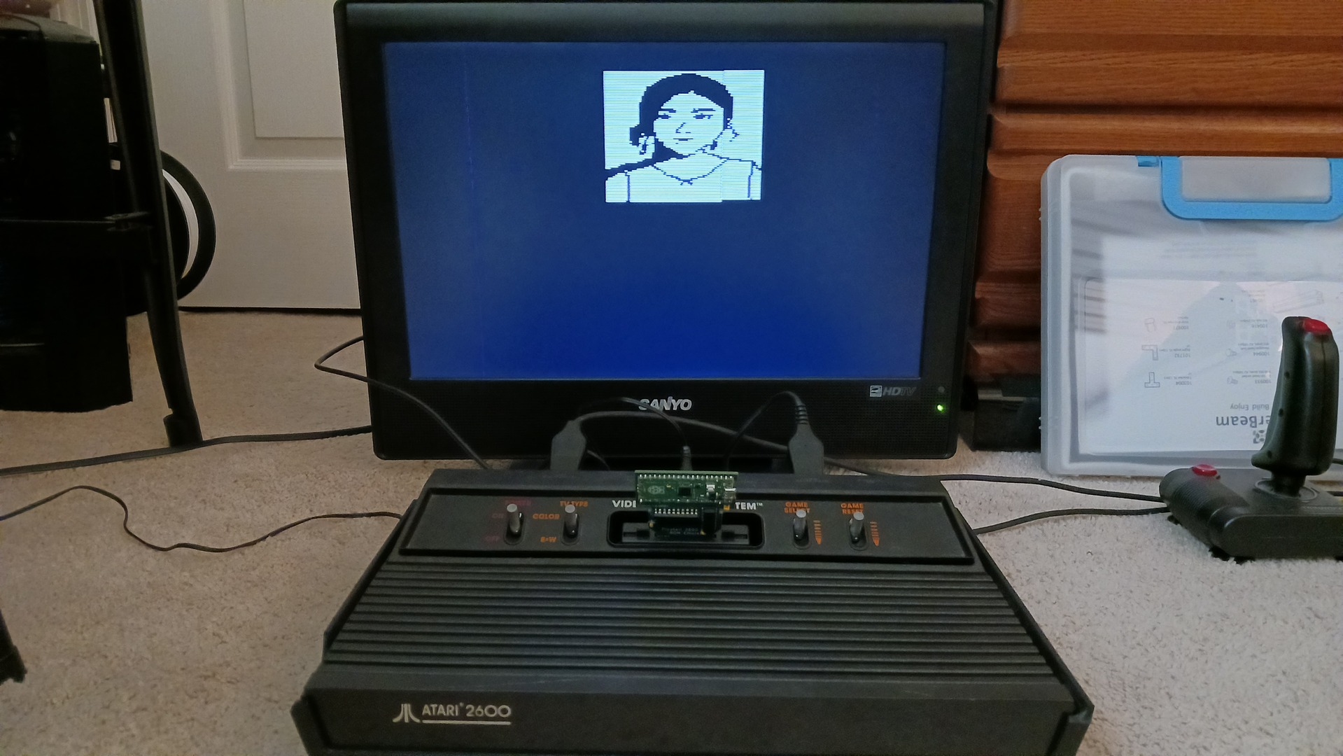

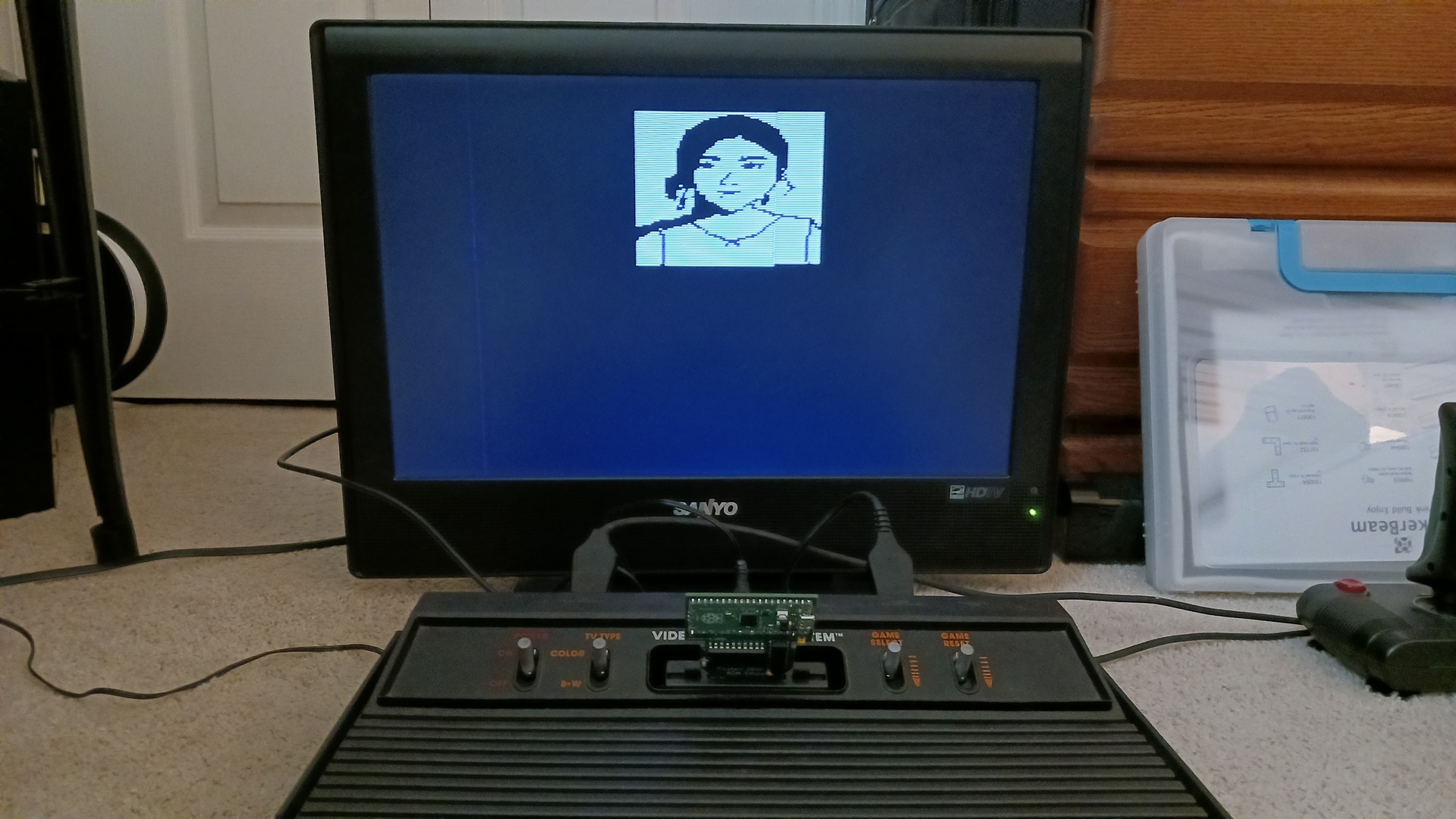

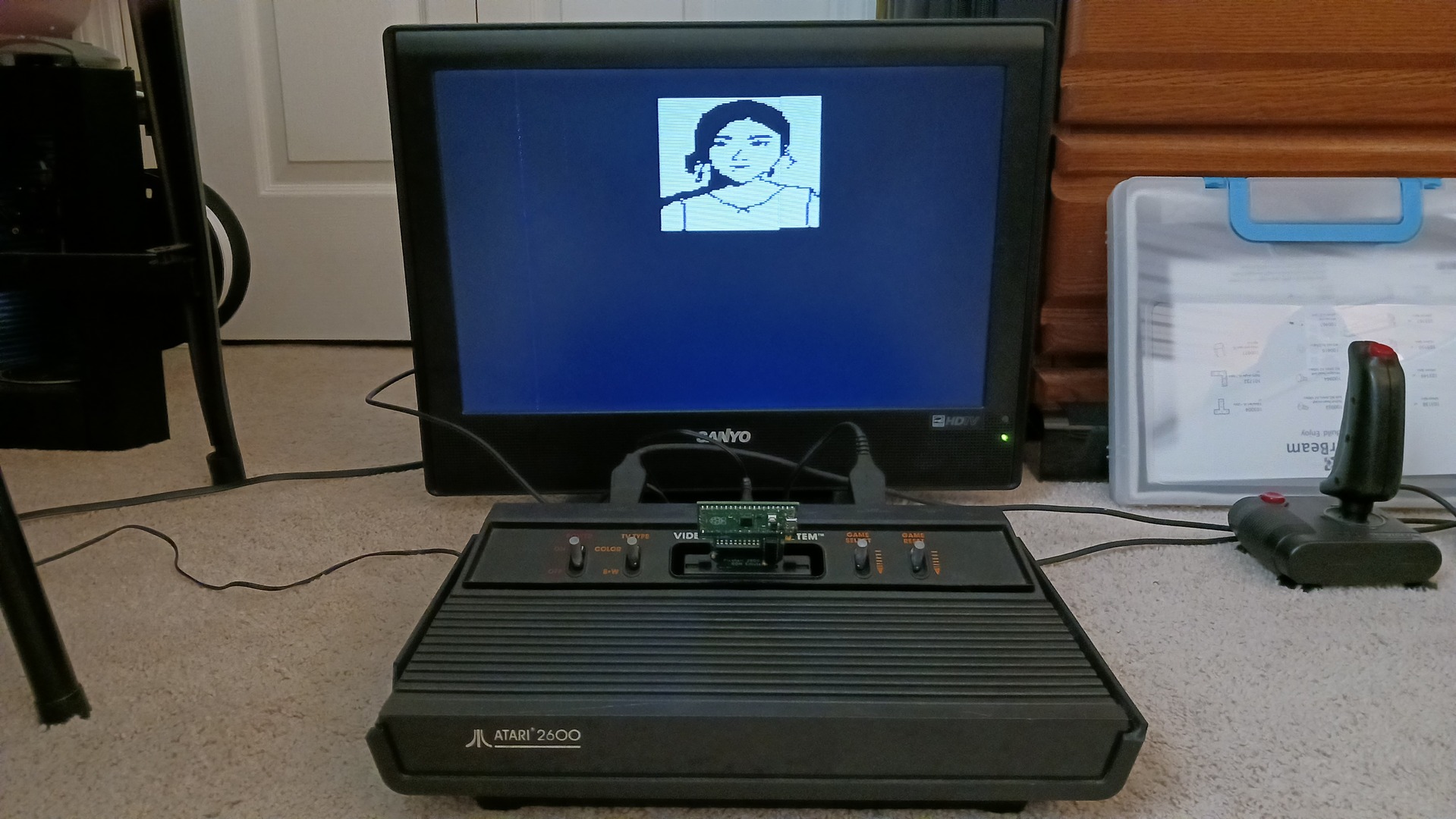

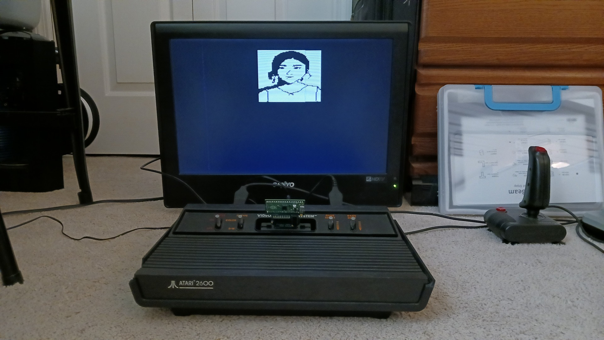

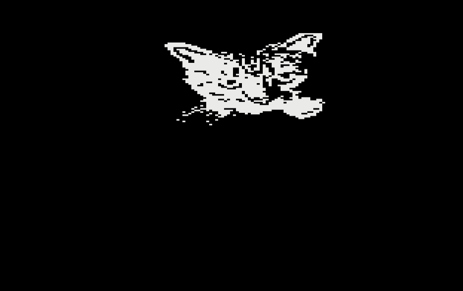

Then I ran it through Pixel It to help 8-bit-ify it before doing a little manual touch-up in Gimp. The results are something like this:
Next, I used this Python script to read the image data and turn it into a data strucutre that can be used by the Picotari. The Atari ROM is also turned into a data strucure using this script.

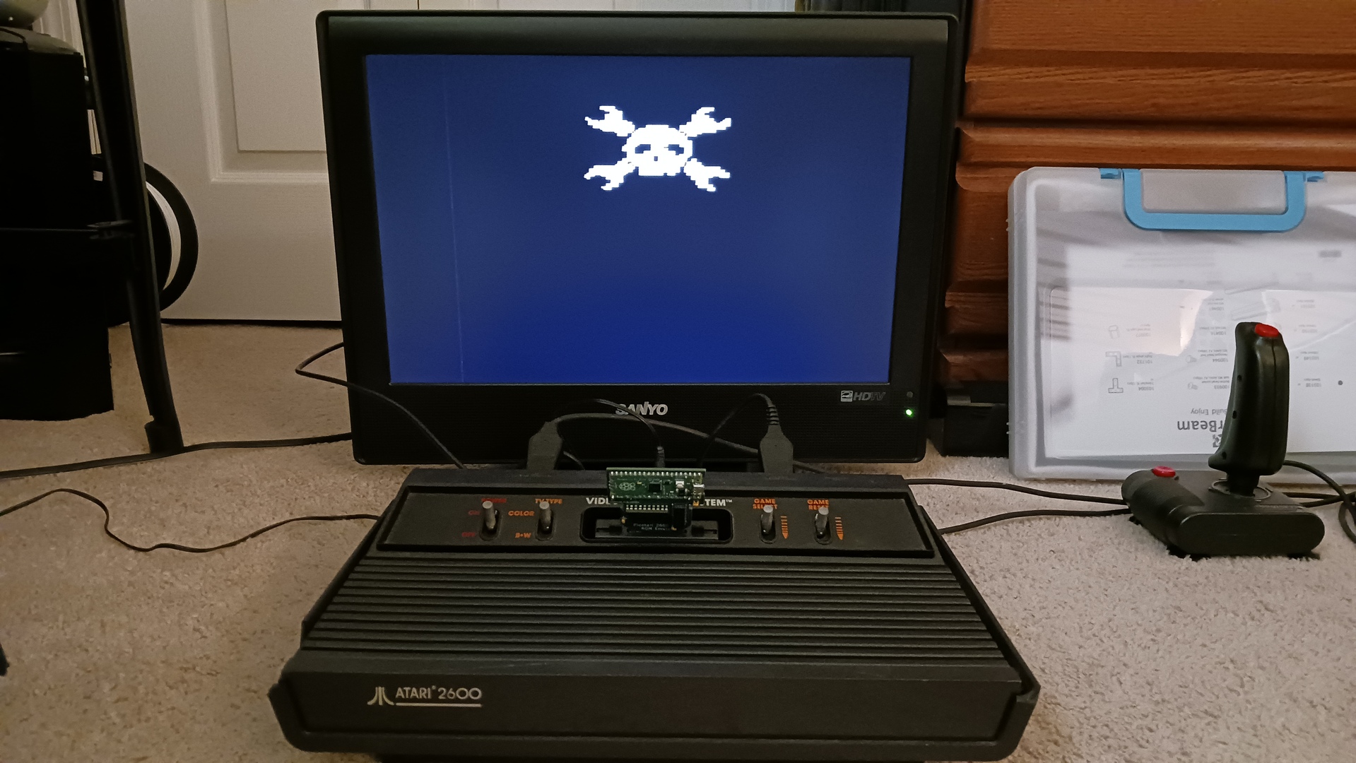

Once the Picotari is flashed with code containing this data, it only needs to be plugged into the Atari like any other cartridge. It is fully self-contained, drawing its power from the Atari.
As presently coded, each image is displayed for about 30 seconds before the next is loaded. After the last image is displayed, it will go back to the first image.
