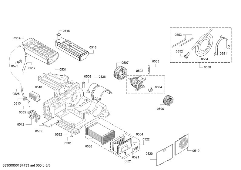

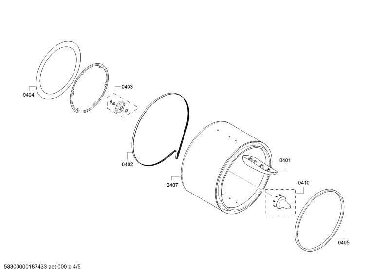

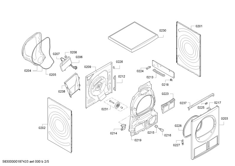

Remove worktop (230) and sides (201,202). Remove heater hood and seal (204 and 205). Remove drum bearing (231) Remove back panel (209) Remove drum (407) Remove front fan lid (526) Loosen bolts holding the motor (502) down.
Lift motor to slide the new drive belt (402) over the front fan (506) and onto the grooved motor axle. Replace old tension pulley (504)
Tighten bolts holding the motor (502) down. Restore front fan lid (526) Restore drum (407) Restore drum bearing (231) Restore back panel (209) Restore heater hood and seal (204 and 205). Restore top (230) and sides (201,202).

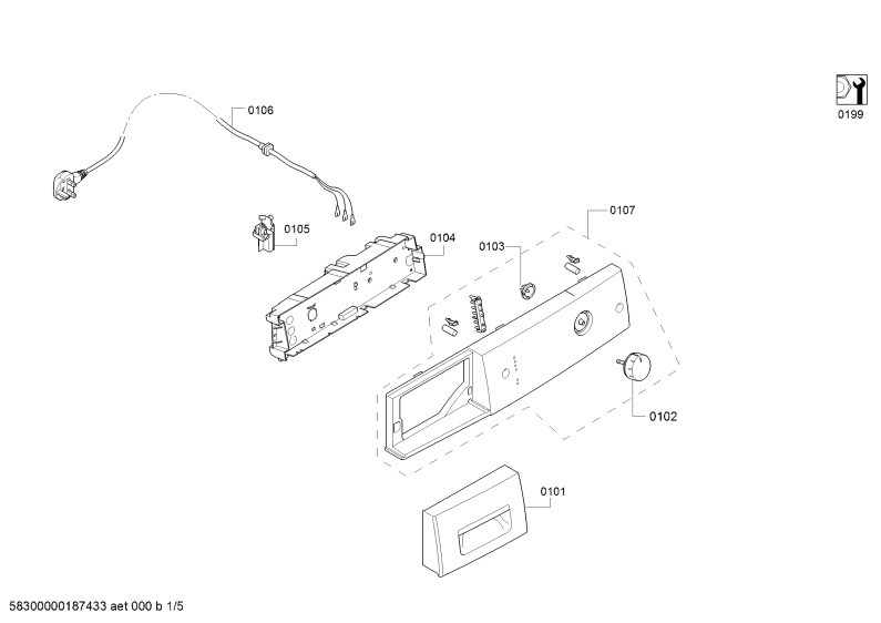

Note there are several types of screw.
Fine-thread screws join metal to metal. Coarse-thread screws join metal to plastic. One countersunk screw fastens the plastic front fascia (107) to the metal frame.
