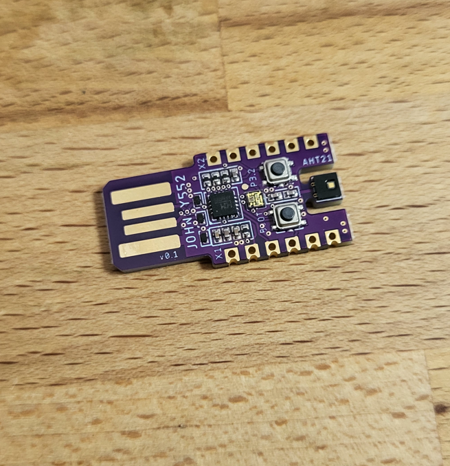

    First Prototypes Are Here!

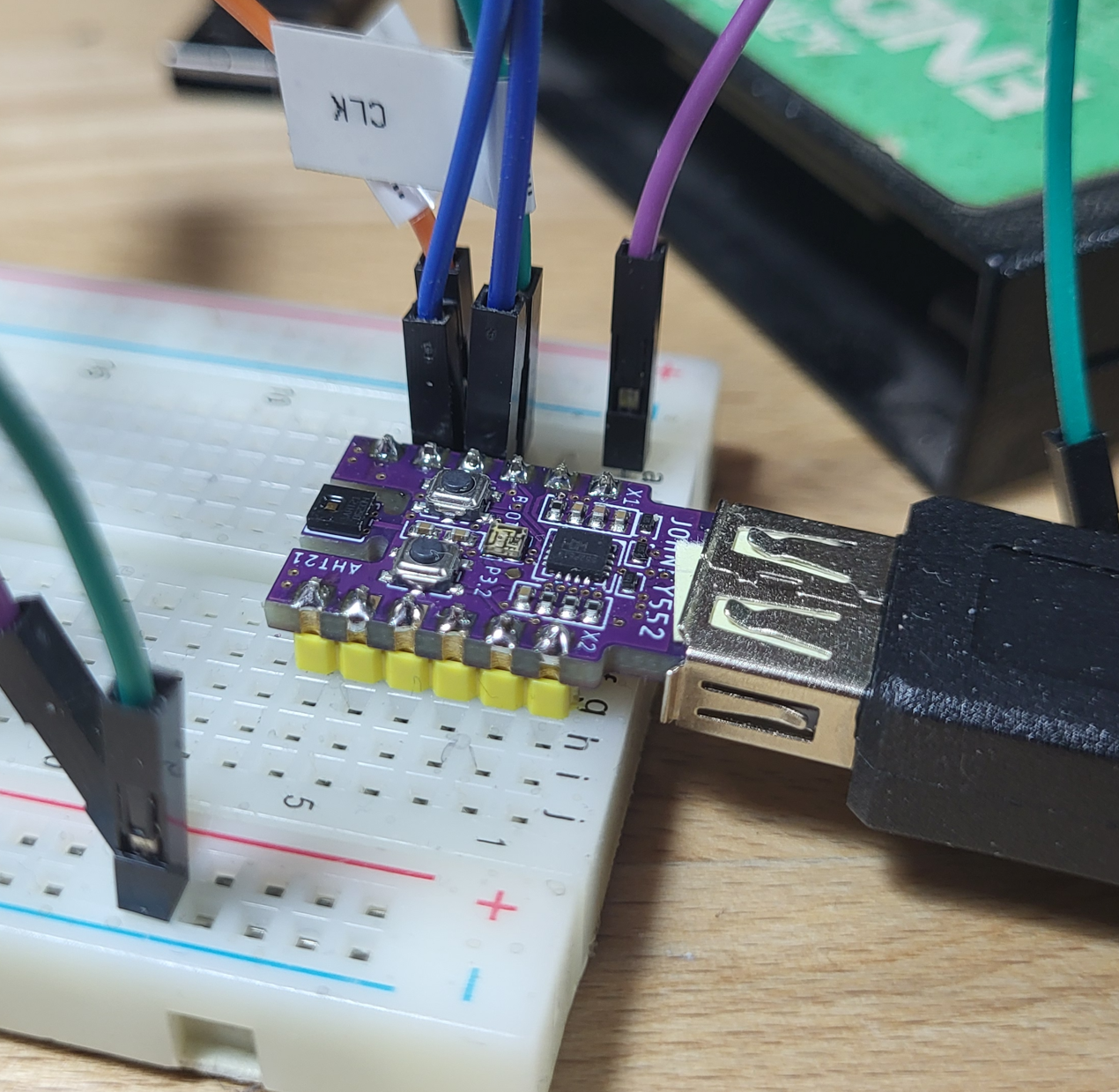

    We finally got the first batch of Johnny552 boards back from the fab, and it’s been exciting to see them come to life. There’s nothing quite like holding a physical version of something you’ve spent weeks (or months) shaping in CAD.
    The CH552P microcontroller fired up beautifully, and the onboard SK9822 LED and AHT21 sensor worked out of the box. USB communication also worked — technically. But that’s where the story shifts.
    As we began plugging and unplugging the board, testing it on real USB-A ports (including some old-school servers and laptops), a flaw became obvious...
    Farewell USB-A PCB Plug (We Loved You)
    We had gone with a 2mm thick PCB edge to act as a direct USB-A male plug — a super minimal, connector-less approach. Even better, our design allowed the board to be flipped 180 degrees and still plug in, which felt clever and elegant.
    But in practice?
    • The fit was unreliable
    • It lacked physical durability
    • It could easily be bent or misaligned under stress.
    Despite loving the idea of it, we realized: it just wasn’t robust enough for real-world use.
