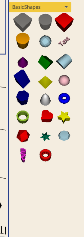

  • Search Bar added to shapes pallet
    Kevin Harrington04/19/2025 at 20:02 0 comments
    I added a searching mode to the shapes pallet. You click the search button and it enables the search bar. you type the name of the object you want and it will populate the pallet with the example objects that match the name you specified.

  • Added threading to the BasicShapes
    Kevin Harrington04/15/2025 at 13:01 0 comments
    Based on a comment i decided to make Threading a BasicShape. It was always possible to use the Ring shape to turn it into threads, but this makes it a standard shape.

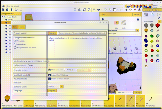

  • I added a confirmation window for when you are about to erase your history
    Kevin Harrington04/13/2025 at 21:52 0 comments
    If you use Undo to go back in time, then change something CaDoodel has to do something with your future operations. This dialog lets you undo that change before it erases the future work from this step.
