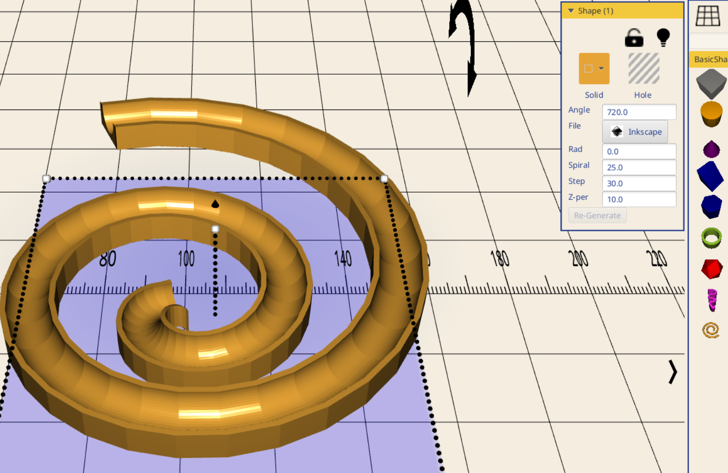

I added a new parameter to Sweep operations that adds the ability to specify a radial increment to increase by for every rotation. This means you can create regular spirals out of any of the sweep objects such as ring or thread.
I added an example of the spiral to basic shapes that is a marble run for a 10mm ball bearing (Hextraction compatible)
