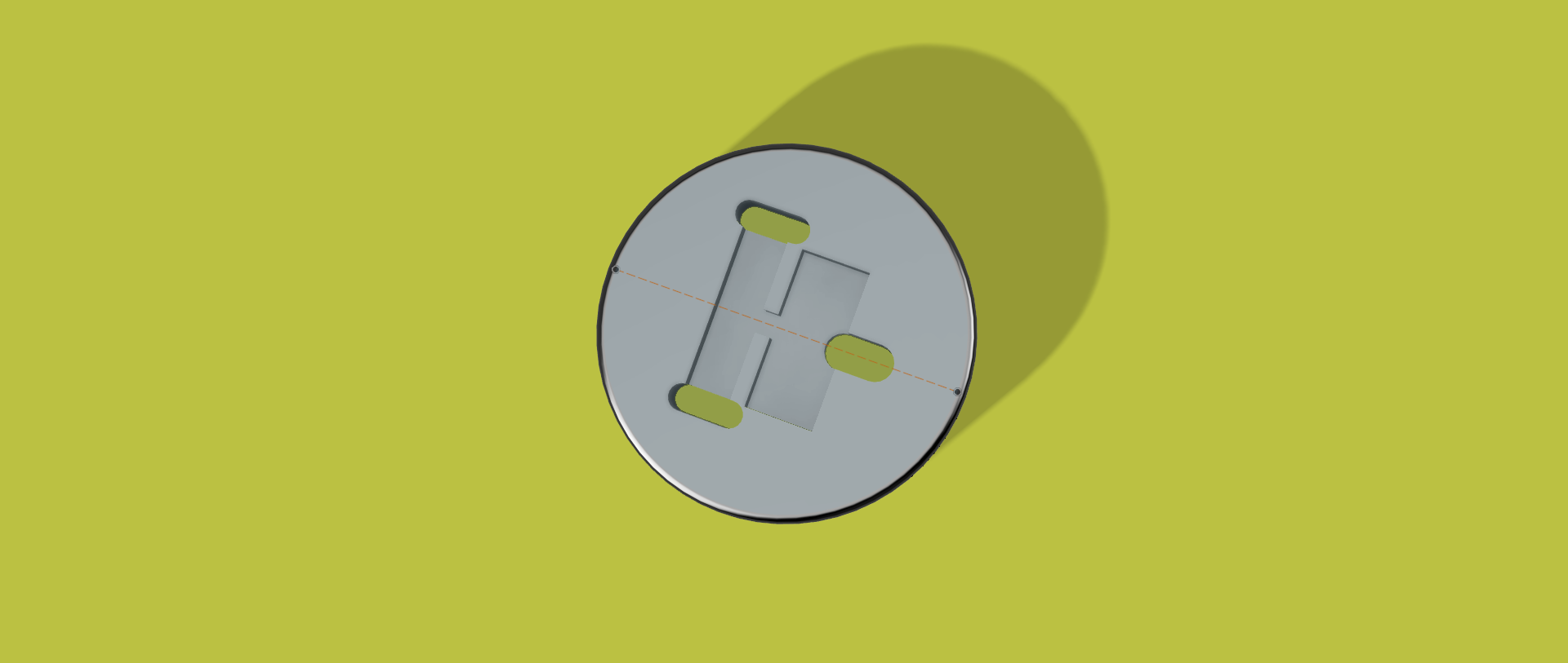

  • My initial ideas
    R Lang09/29/2025 at 08:54 0 comments
    I wanted to share this little snapshot represents my initial ideas on where I wanted to take the project, design wise. For now, I have abandoned this design and will use it when I scale up the robot - for now it's an unwarranted level of complexity for what is ultimately a small robot. In future? Who knows!
    In a future update I will share the final design along with the STLs and code examples, currently I am debating a polar vs cartesian co-ordinates system, polar would mean starting it from a nominal, known point - really not that hard to design, cartesian, being 3d would need an IMU to measure its position - again, not really that big of an integration issue, but a layer of unwarranted complexity, affecting the overall size and shape of Tortuga 1.0.

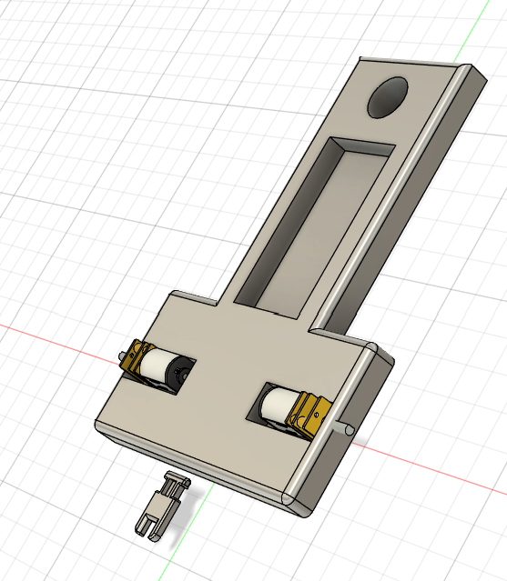

  • Test bed V1.
    R Lang08/30/2025 at 17:07 0 comments
    So here is an initial assembly idea of what the test bed will look like. The front bay will be for seating a battery, the finished test shell would likely have venting for batteries, maybe some kind of hexagonal pattern at the bottom. The idea of keeping it as sealed as possible is to prevent sand ingress into the motors and electronics.
    The rear component is a hinge design to actuate the tail, Tortuga when wanting to carve into the sand will actuate its tail downwards at a set angle and drag it behind it, producing the desired line. Not shown:
    Servo to actuate the tail
    Nose wheel steering servo

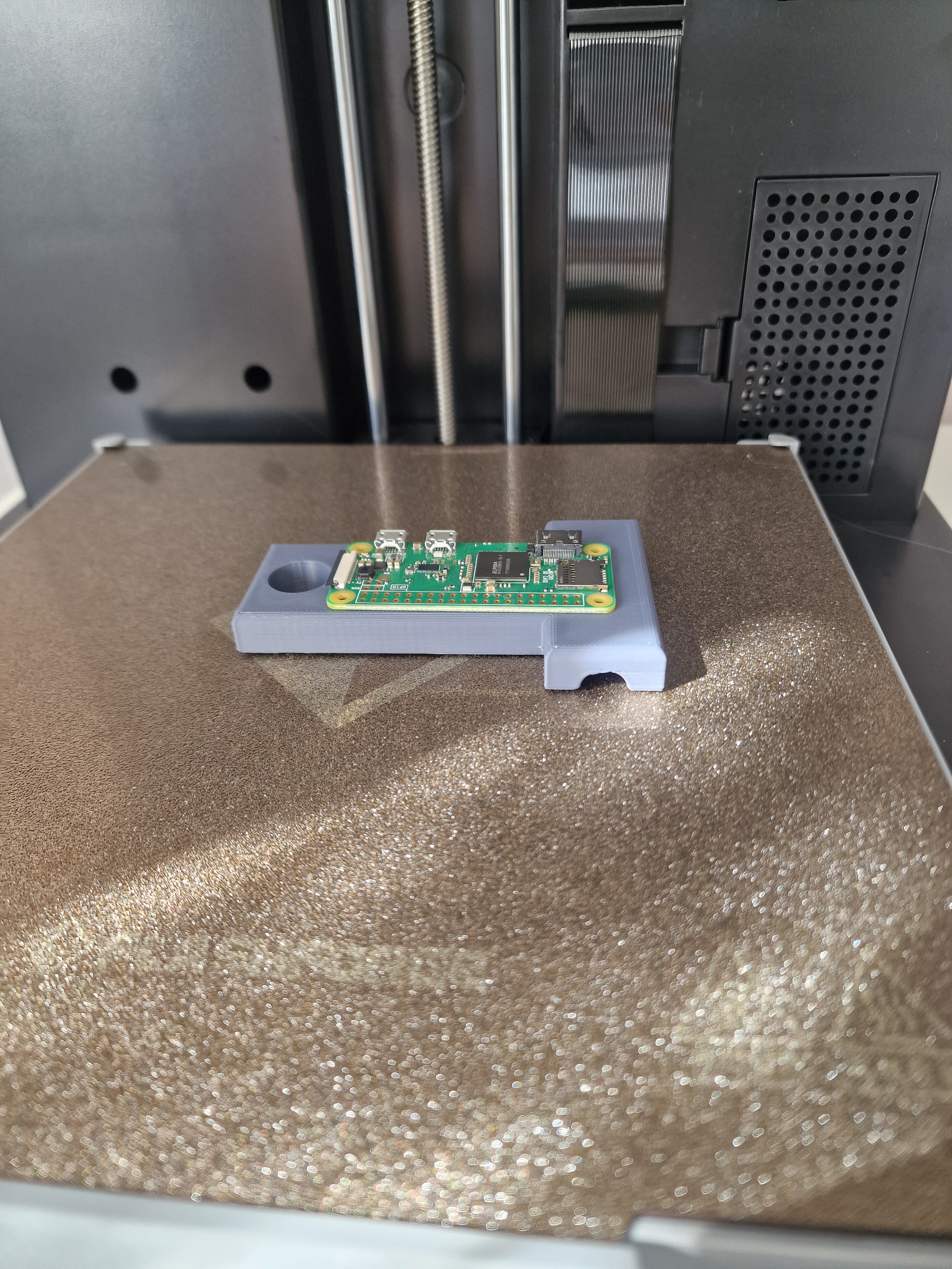

  • First print!
    R Lang08/28/2025 at 14:47 0 comments
    This is the result of the first chassis print! Having discovered an abundance of hoarded Raspberry Pi 0Ws knocking about, I am probably going to go ahead with using that platform for prototyping, I have also decided that I will go with active nose wheel steering rather than differential steering, the differential steering presented a challenge for me to implement, given that I am new to coding. I however have not given up on it and will come back to it in the future.
