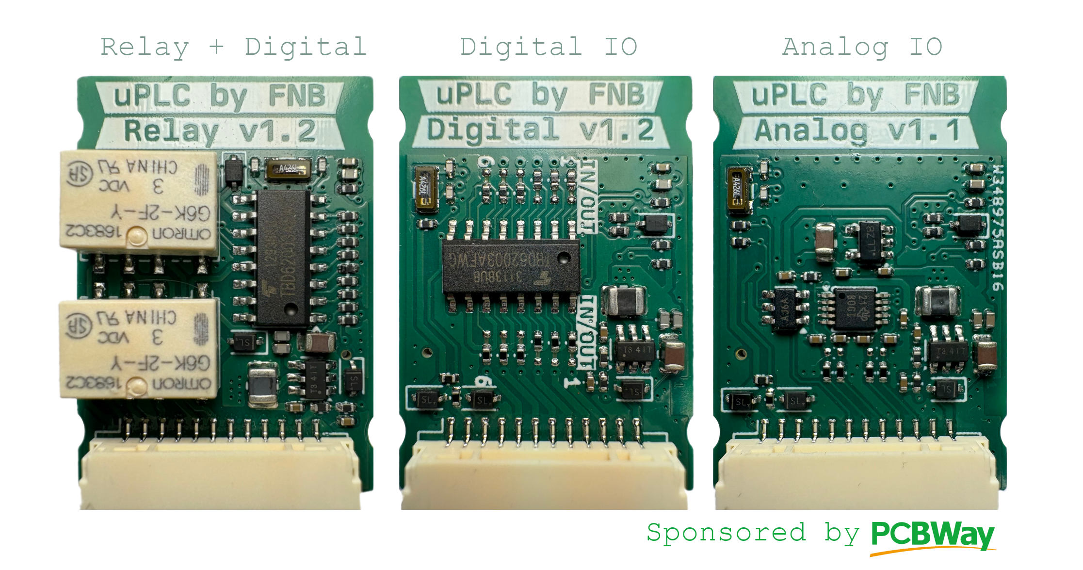

The uPLC (micro Programmable Logic Controller) is a compact (22x32mm) IO controller powered by the ESP32, designed to automate dumb devices
The uPLC (Micro Programmable Logic Controller) is a range of compact (22x32mm) I/O controllers powered by the ESP32, designed to automate various tasks around you. So far, three versions have been developed. All versions are generally 24V-tolerant for digital I/O, except for the analog io, It allso features a wide-range 3.8-24V buck regulator for power input. The primary purpose of the uPLC is to "smartify" devices by integrating them with ESPHome. But it can also function as a direct, point-to-point PLC, using ESP-NOW for wireless communication, replacing traditional wired connections at a cost of latency and reliability. All boards are designed in KiCad and are fully open source with design files and gerbers avaliable at github under a MIT licence, so do whatever you want with it. https://github.com/fredriknk/uPLC-Stack https://github.com/fredriknk/uPLC-analog https://github.com/fredriknk/uPLC-digital https://github.com/fredriknk/uPLC-relay

The uPLC-analog version is an ESP-32-C3 wifi, bluetooth module for communication and MCU, it has a 3.8-24V buck regulator, 3v LDO for the analog supply, it has four single ended / two differential 0-3V analog inputs through a ADS1115, one 12 bit 3.6msps analog dac through a MCP4725A0T , and one protected 3.3v GPIO for onwire communication (Eg for DS18b20 sensors). The analog uPLC allso has input voltage monitoring for battery applications.

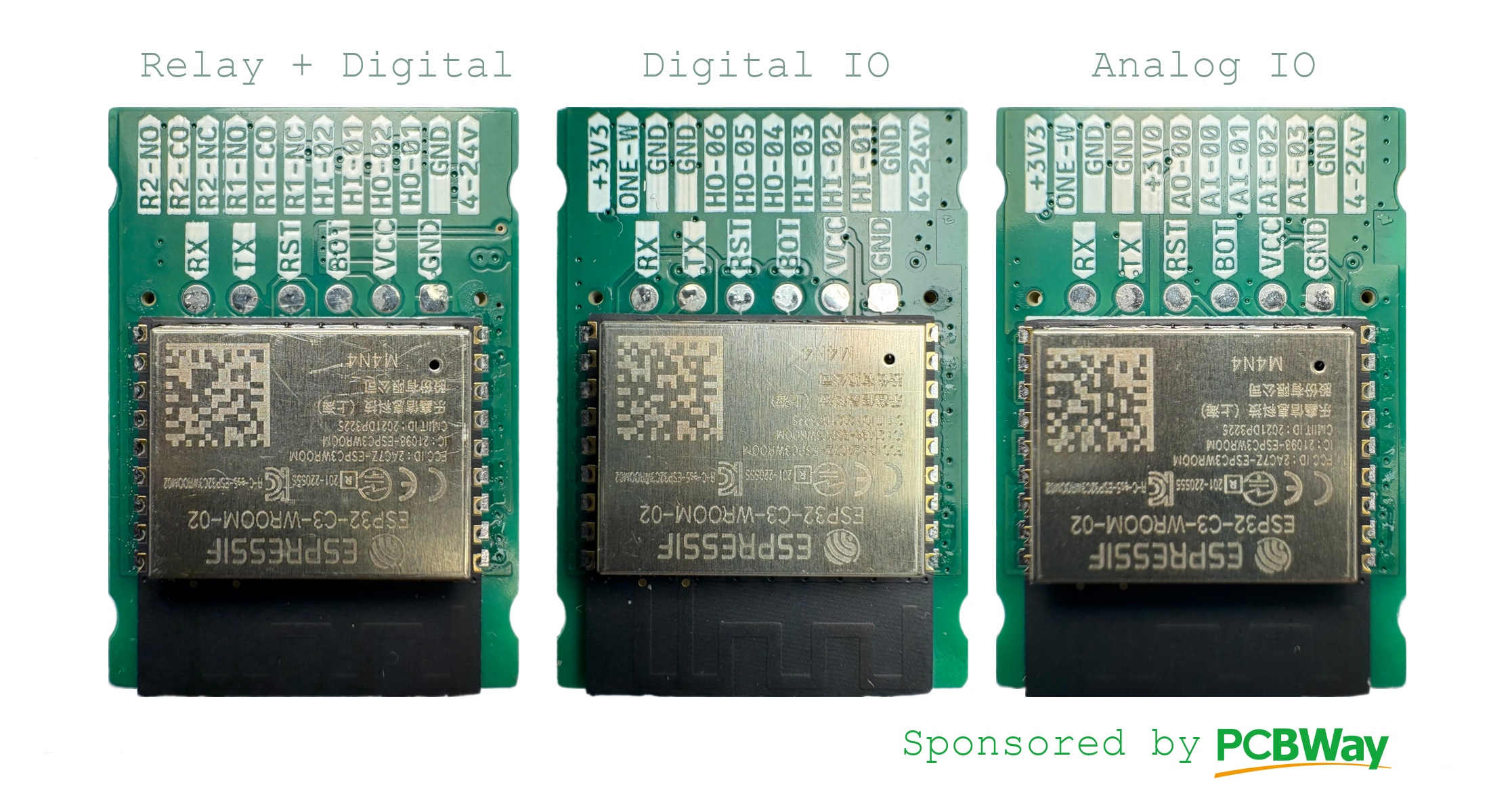

LabelGPIODescription
3V33V33.3v output for sensor connection
ONE-WGPIO18Protected gpio for onewire comm
GNDGNDGND port for sensor connection
3V03V03.0v rail for analog input connections
AOUT0DACi2c DAC 0-3v3 analog Output
AIN0ADC1i2c ADC 0-3v0 analog input
AIN1ADC2i2c ADC 0-3v0 analog input
AIN2ADC3i2c ADC 0-3v0 analog input
AIN3ADC4i2c ADC 0-3v0 analog input
GNDGNDGround
4-24VBuck reg3.8-24v polarity protected power input

The uPLC-digital version is an ESP-32-C3 wifi, bluetooth module for communication and MCU, it has a 3.8-24V buck regulator, has three 2.5-25V inputs, three 2.5-25v 100ma high speed open drain outputs through a TBD062003 DMOS transistor array ic. And one protected 3.3v GPIO for onwire communication (Eg for DS18b20 sensors). The digital version allso has input voltage monitoring for battery applications.
HO-06GPIO1025v 100ma open drain output
HO-05GPIO1925v 100ma open drain output
HO-04GPIO325v 100ma open drain output
HI-03GPIO72.5-25v input (with pulldown)
HI-02GPIO62.5-25v input (with pulldown)
HI-01GPIO52.5-25v input (with pulldown)
GNDGNDGround
4-24VBuck reg3.8-24v polarity protected input

The uPLC-relay version has two small signal relay module utilizing an ESP-32-C3 wifi, bluetooth module for communication and MCU, it has a 0-24V buck regulator, has two 2.5-25V inputs, two 25v, 100/50ma high speed open drain output through a TBD062003 DMOS transistor array ic. And two relay outputs are capable of driving around 25V 500ma.
R2NOGPIO5Relay 1 Normally Open
R2COGPIO5Relay 1 COM
R2NCGPIO5Relay 1 Normally Closed
R1NOGPIO6Relay 1 Normally Open
R1COGPIO6Relay 1 COM
R1NCGPIO6Relay 1 Normally Closed
HI2GPIO192.5-25v input
HI1GPIO182.5-25v input
HO2GPIO325v 50ma open drain output
HO1GPIO725v 100ma open drain output
4-24V3V34-24v
GNDGNDGround

    Thanks so much to PCBWay for sponsoring my first assembly run for this project, they deliver awesome quality as allways with 6 perfectly soldered prototypes delivered fully assembled at my door in less than 2 weeks from ordering. Look at this beautiful trio of boards ready for automating every dumb device in my house thanks to PCBWay, Thanks for sponsoring the open source community! ESP-Home code examples are comming soon now that i have the prototypes.
