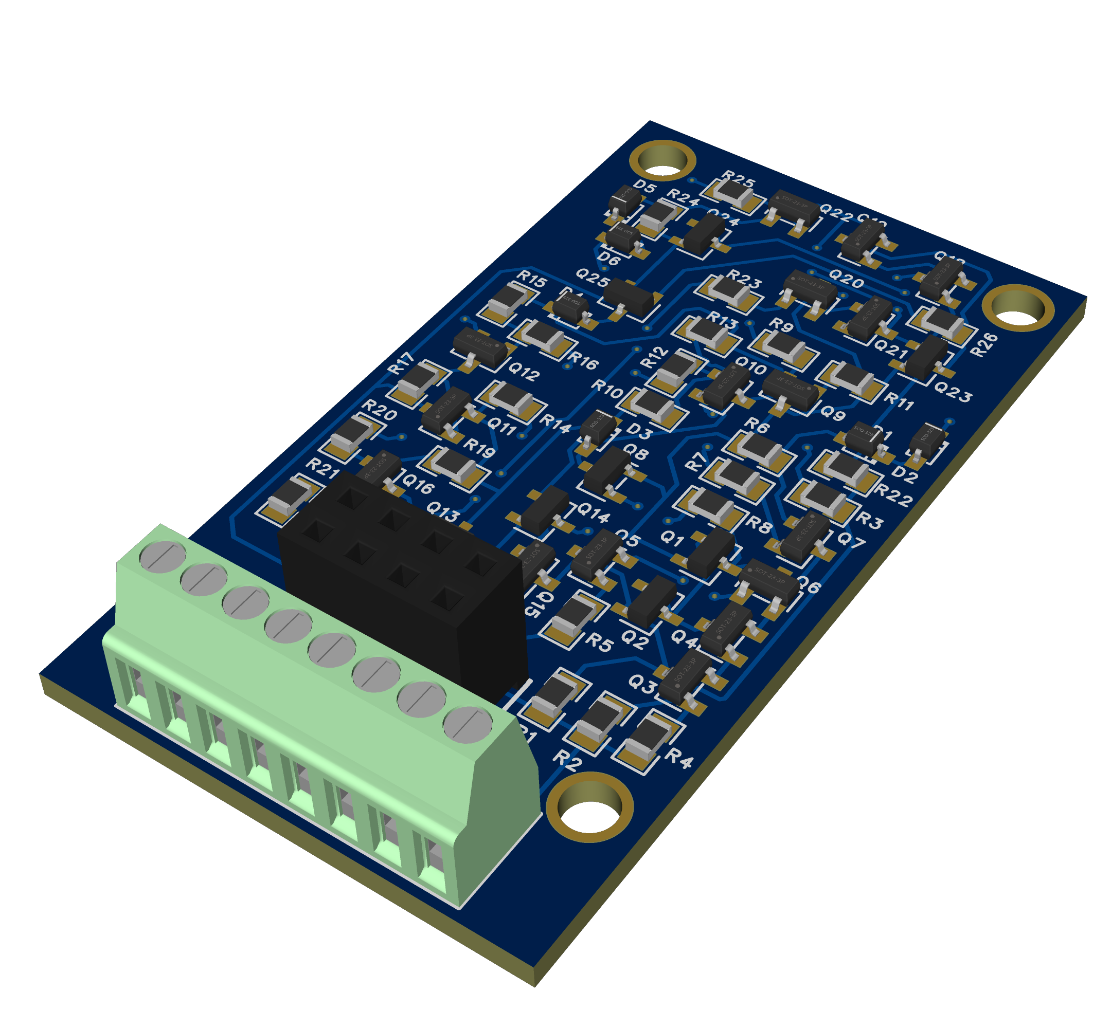

Ever since then I have wanted to build a 555 timer out of discrete components. I recently revisited Rudraksha Vegad's Giant 555 Timer project and was inspired to design a 555 timer PCB with all SMD parts (Except the connectors).
All Resistors are 0805 for easier hand soldering. I can solder 0402 and 0603 but would be really tedious with so many pieces.

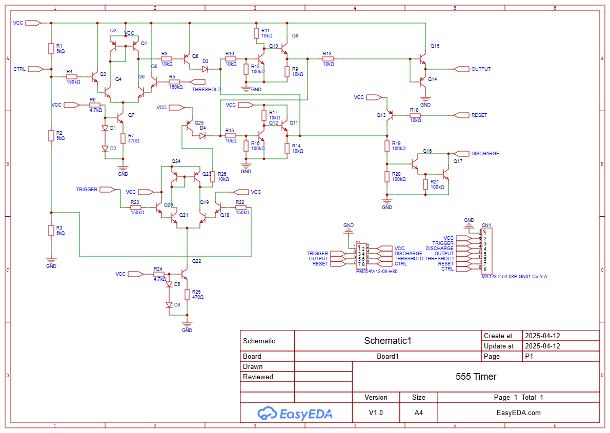

I pretty much copied Rudraksha's schematic and resistor values, considering he built this already I figured going with his should work.
Components:
  • 17 NPN Transistors    ( MMBT3904 )
  • 8 PNP Transistors      ( MMBT3906 )
  • 6 Diodes                    (  1N4148WS  )
  • 3 5k Resistors            ( 0805 )
  • 5 100k Resistors        ( 0805 )
  • 4 150k Resistors        ( 0805 )
  • 2 4.7k Resistors         ( 0805 )
  • 2 470ohm Resistors  ( 0805 )
  • 10 10k Resistors         ( 0805 )

    The smd components from LCSC are still in the mail. I'm really crossing my fingers here hoping I routed everything correctly and it works on the first go. Knowing how things go if that happens I'll be surprised. I do not have an oscilloscope so if there are issues it will take a while to diagnose.

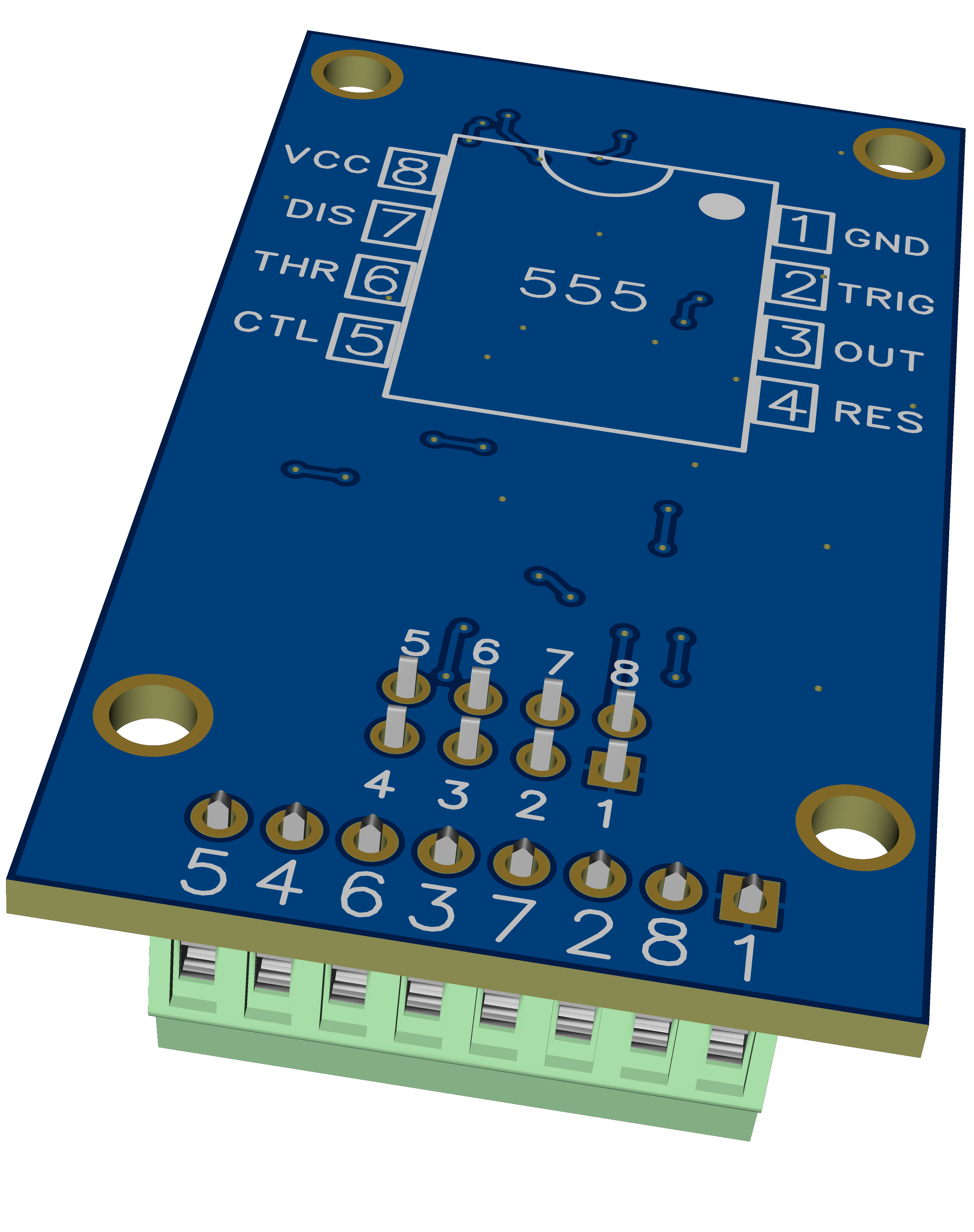

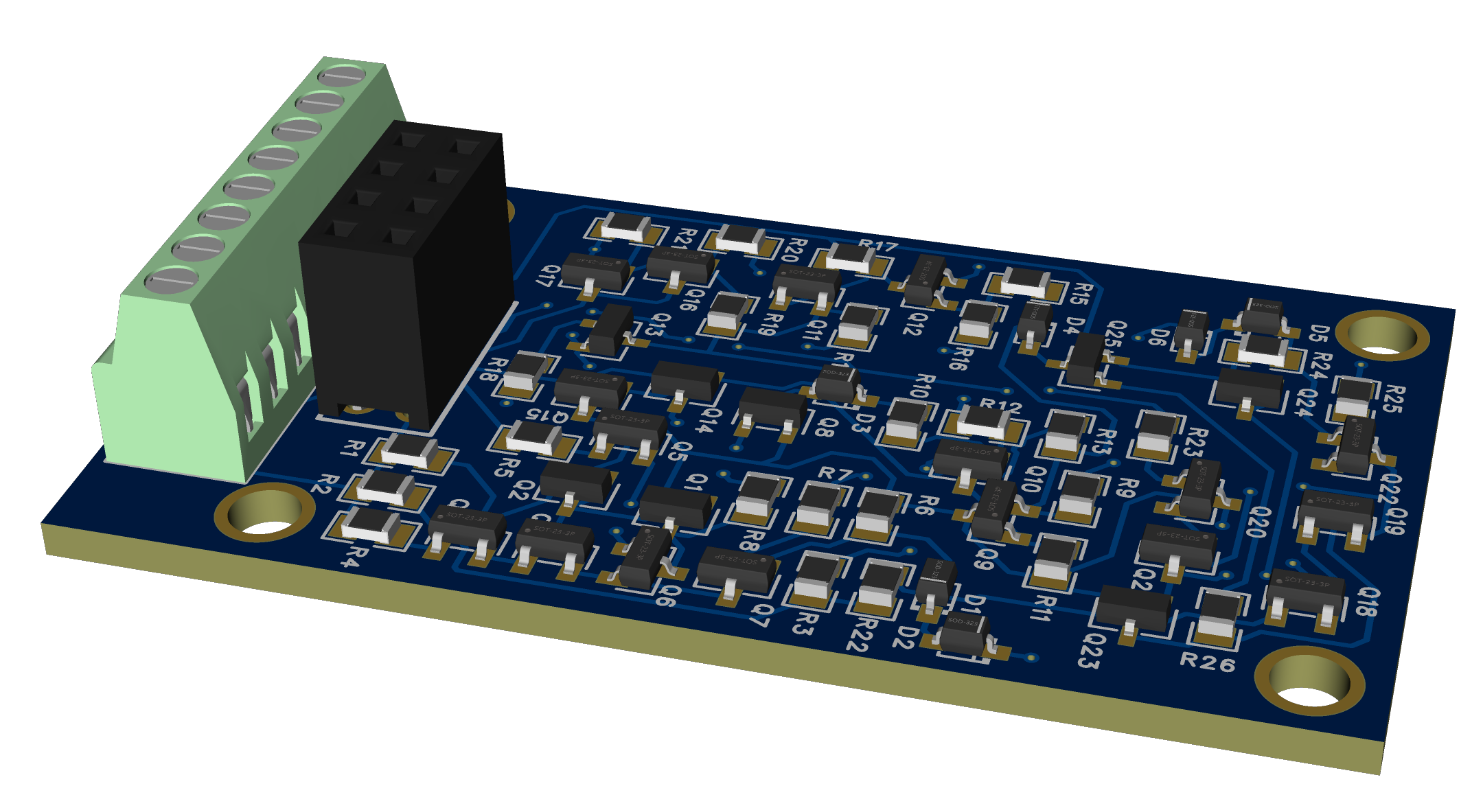

    555 Timer PCB front and back:
