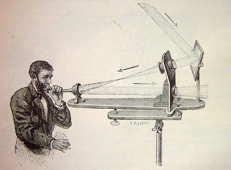

There are two main parts to a photophone, the transmitter and receiver.
A transmitter
The most notable thing about the transmitter is that it contains no electronics whatsoever. A lens focuses sunlight on a flexible mirror at the end of a tube. When someone speaks into the other end of the tube, it causes the mirror to vibrate. Those vibrations, which encode the speaker’s voice, are then transmitted in the light that reflects off of the mirror.

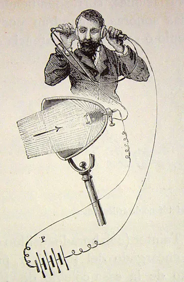

A receiver
At the receiver, the light from the transmitter is collected and focused by a parabolic mirror with a selenium cell at its focal point. The selenium cell was an early photoresistor, so as the level of light falling on it varied, so did its electrical resistance. Current was passed through the cell and into an electromagnetic speaker, which turned the variations back into sound.

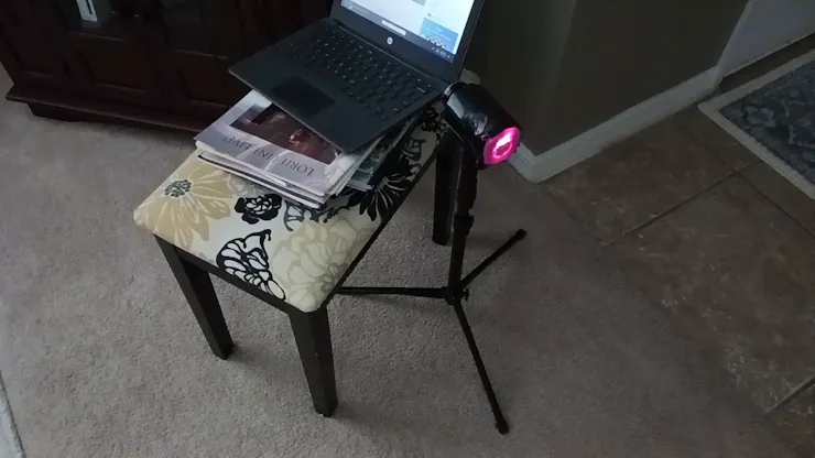

My transmitter
Above is my transmitter. It is a pill bottle attached to a tripod, with the lid removed for speaking into. The other end of the bottle was melted out with a soldering iron with an old tip. A balloon was stretched over this end to act as a flexible diaphragm. A small mirror was hot-glued to the diaphragm. When sound enters the open end of the bottle, it causes the diaphragm (and the attached mirror) to vibrate. Light being reflected off of that mirror picks up the vibrations.

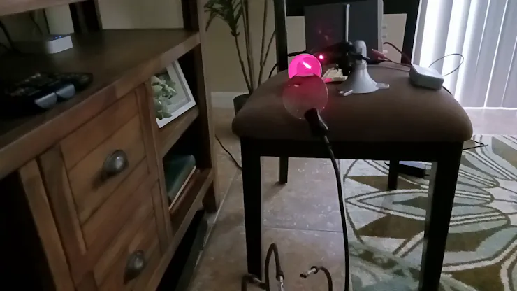

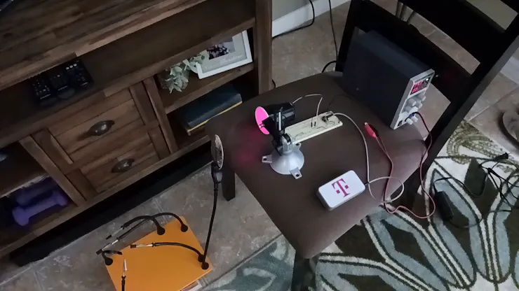

As for the receiver, I have used a paper cup that is covered in Gorilla tape to block out ambient light. At the back, in the center, there’s a photoresistor. I have a lens that refocuses the incoming light onto that photoresistor.
Current passes through the photoresistor, which is in series with a 10, 000 ohm resistor, and as light from the transmitter is received, the current varies. It outputs to an electromagnetic speaker — one that is much more modern than the one Bell used of course, and with an amplifier circuit built-in — but it operates on the same principles.
You may have noticed by now that there is just 1 lens in the build. That’s because I chose to use a laser instead of sunlight. This modern addition doesn’t change the principles of operation at all, but does let me avoid using most of the mirrors and lenses. If Bell had a laser available to him, I have no doubt he would have used it.
I have 5 volts DC running through the circuit, and one note on that — use a decent quality power supply. If it’s not a clean DC signal, you might get oscillations that distort the audio. I had that happen...
