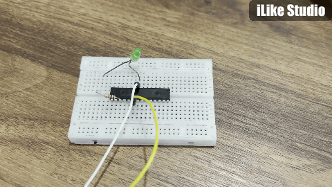

Writing First Assembly Level Blink Code:
Writing code in assembly language requires learning register level programming, which can be seen in the datasheet and can be modified accordingly. Writing assembly level is good, but requires much more expertise than C programming. Making logic in register level programming is more difficult than high level languages like C or Python.
Here we are just going to make a simple GPIO toggle program. The good thing is that the programming of registers is the same for all 8 bit microcontrollers in a PIC environment, so this same code works for every 8 bit PIC. The register for GPIO toggle is known as TRIS, here is the assembly level code for the same.
Code:
void main() {
TRISB = 0; // selecting the GPIO as output
for(;;) {
PORTB = 0XFF; // assigning the value HIGH to GPIO
Delay_ms(1000);
PORTB = 0; // assigning the value HIGH to GPIO
Delay_ms(1000);

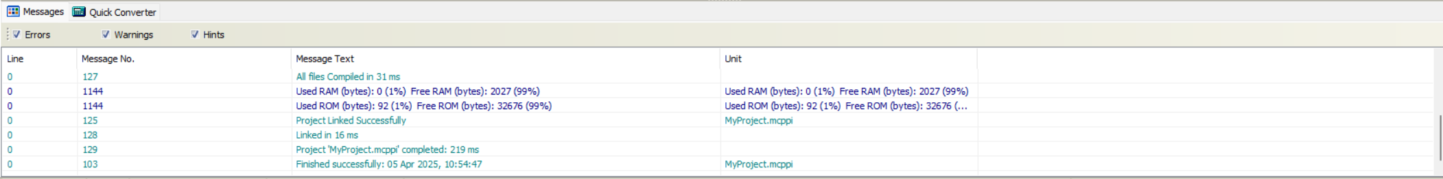

Now we need a compiler which converts this code (low level language) into machine level code (HEX format) . The proper procedure and software for this is given below.
Compiling and Getting HEX file:

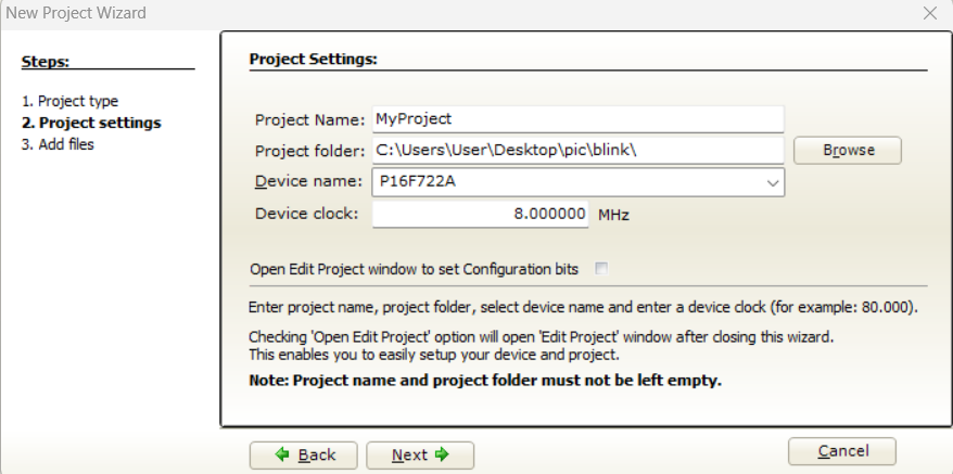

For the compiling of the code, and to convert the same into HEX. I am using MikroC software. This one supports the whole family of PIC and is very easy to learn in the first go, if you are a beginner. Let’s convert the code into HEX in 4 steps.
- Download the software, make a new folder and set up a project in that as a standard project.
- Change the CPU clock as per the max clock the IC can work on, see in datasheet.

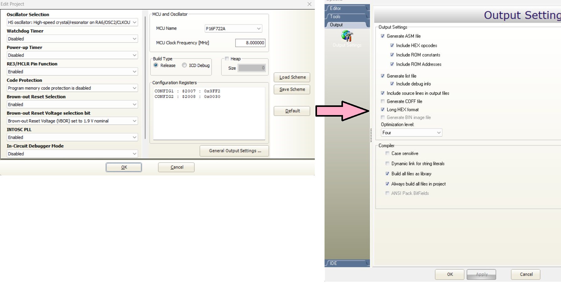

- Go to the edit project section, under the project tools menu. Under the general output setting tick export as hex.
- Now hit the build button. It will make some at the project location in the same folder. We only need the Hex file to copy it from there to a safe location. And that is all what we need from the compiler.

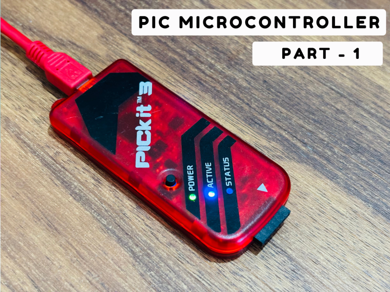

Getting hands on PIC KIT 3:
Now we have a HEX file which is basically the same code, but the compiler version or we can say machine level code. Now we have to put this code into the PIC16F722A. Download full blink project from here.
PIC microcontrollers can use high-voltage programming (HVP), especially for in-circuit serial programming (ICSP) or factory programming. High-voltage programming is...
